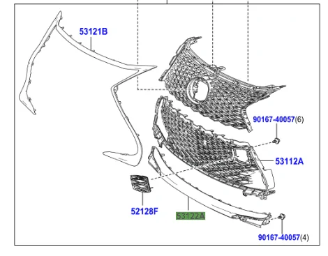

Rookie numbers. check out this lower grille moulding on a GSF
Jeep Gladiator Dealer will not honor warranty wants to change my transmission without submitting for warranty 1673960836555
Jeep Gladiator Dealer will not honor warranty wants to change my transmission without submitting for warranty 1673960854470
