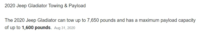

The JT when optioned right has a maximum payload of 1700lbs. Always know your specs before giving bad info to someone who knows what the payload is and has the power to void your warranty. That statement could be used against you by Jeep if they start implying that you abused the vehicle thinking it could do the work of a 1 ton SRW truck. The tires/lift thing is really dependent on what their techs are telling them I'd guess or a void all warranty for lift/tire policy. I don't know how effective people have been at fighting the dealers on their assessments. At this point the 850RE can be gotten pretty inexpensively. I would rather buy a transmission and install it myself before voiding the entire warranty over $1500. But before I did that I'd pick the Jeep up and try any other dealer I could find for a second opinion. It's a shitty spot to be in for sure.

payload has never been as high as 1700 on these trucks
Yes, the advertised base model Sport S with Max Tow has been that high.
What you end up with on the door stick will vary with your options
When I was originally looking at a Sport S with max tow it was 1600 pounds.

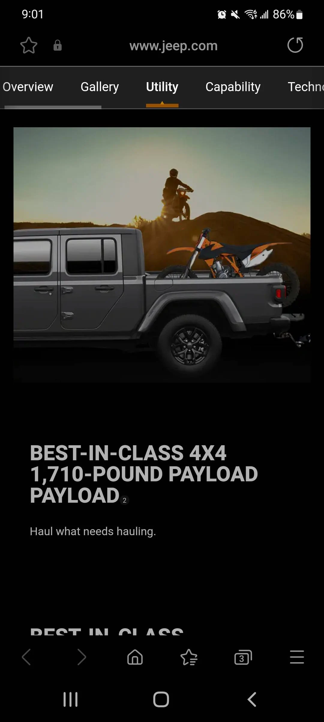

Jeep Gladiator Dealer will not honor warranty wants to change my transmission without submitting for warranty 1673549751509

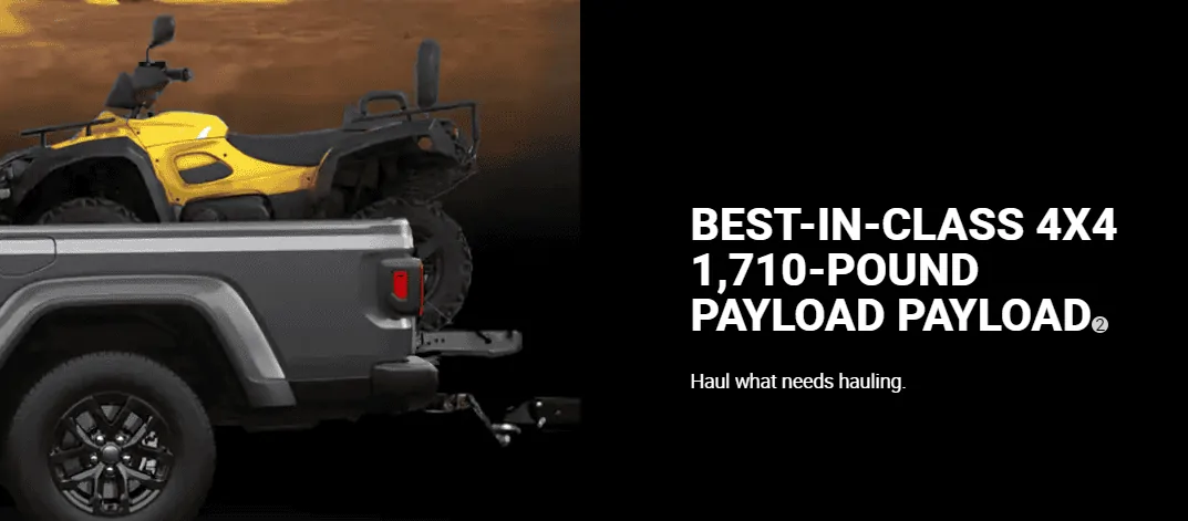

It's currently over 1700.
This is from the 2023 brochure -
Jeep Gladiator Dealer will not honor warranty wants to change my transmission without submitting for warranty 1673549597412
