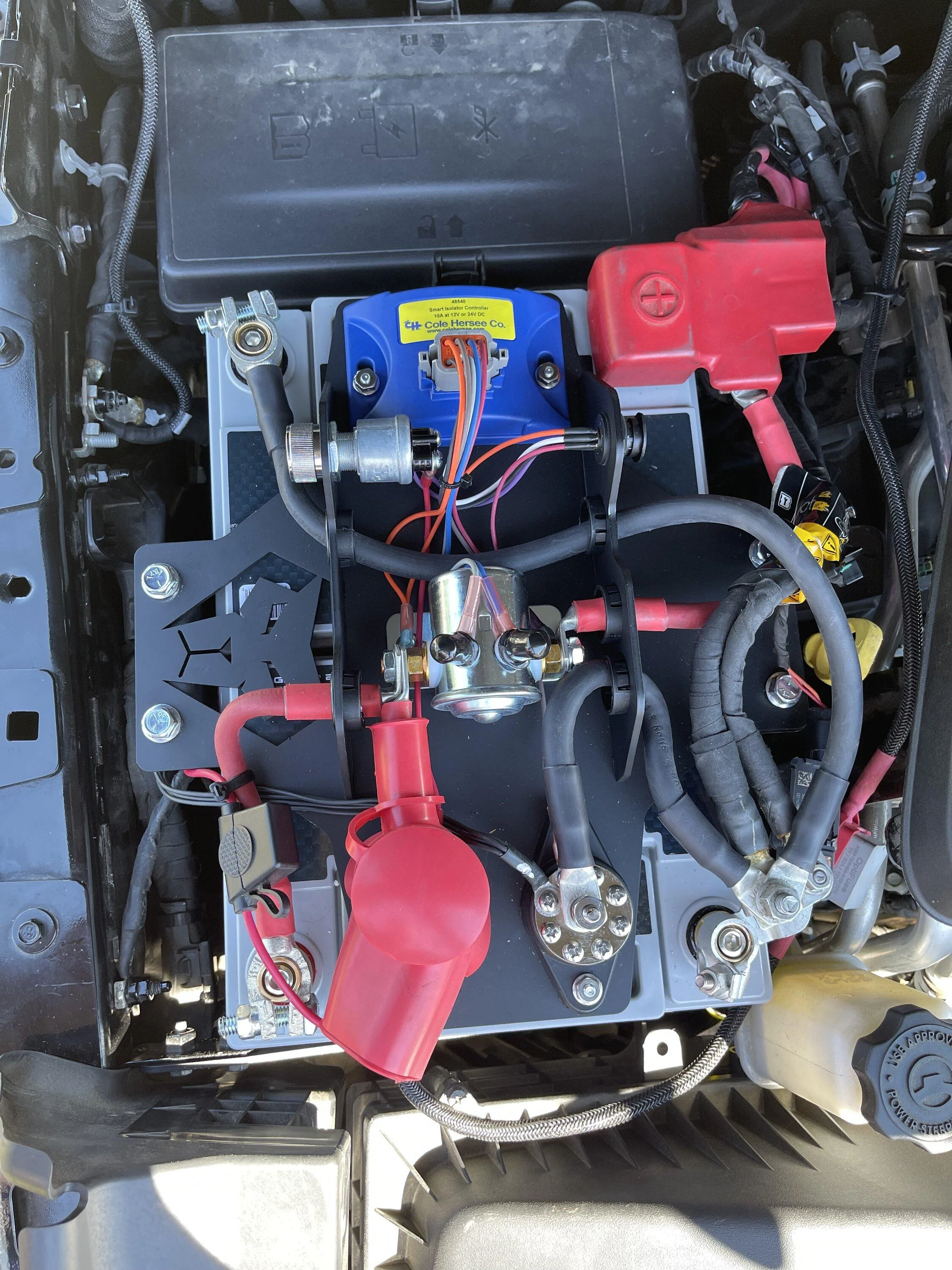

Here's what I did since I had to replace both batteries twice. I don't drive it enough during the pandemic with work from home, so it drains the batteries down and won't take a charge and the batteries need replacing. I purchased a genesis dual battery system which does away with the start stop battery under the fuse box and makes both batteries accessible. These are full sized group 25 AGM batteries I purchased the full throttle batteries from Genesis. This unit has an ISOLATOR which Isolates the accessory battery from the crank battery once the voltage drops to a certain point. That way you should have enough battery power to crank it over since it won't allow it to fully drain. It can also act as it's own battery jumper in case one of the batteries goes dead. Thus far it's solved my issue but only time will tell. I installed it myself it takes some time but can be done in a day or less good instructional YouTube Videos. It won't affect your warranty since you're not messing with anything with how the systems work other than replacing the battery. One of the best Mods I've done.
Jeep Gladiator Dealership refusing to really fix start/stop issue IMG_1718
