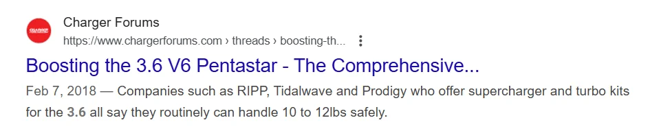

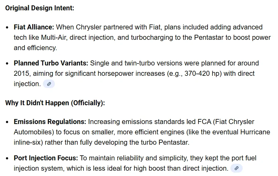

^^^ That is a popular misconception. The 3.6 was actually designed to be a forced induction motor, according to what I have discovered.
Any links, or just from chatting with folks? I'm genuinely curious, because I've been under that misconception as well from multiple posts/claims.
40,514
54,044
^^^ That is a popular misconception. The 3.6 was actually designed to be a forced induction motor, according to what I have discovered. Talking to the Ripp folks, they said this system is entirely safe at the delivered boost levels up to 8ish PSI, which is around half an atmosphere. People got into trouble by pushing it over 10 psi and running it hard all the time. We discussed the need for a forged short block, which I am willing to install, but the Ripp people say it is money wasted to do so, unless I decide to go crazy...
These were indeed engineered for eventual boost. Part of the design for the upgrade process back in 2015 was for this reason.
You'll appreciate the torque in the hills/mountains. My wife's JLU stayed in 8th gear in many mountain passes while on those same highways, my JT was downshifting and upshifting constantly.
Frankly, I think you are heading in an interesting path and I'll be watching. Heck, these same engines run a different tune and have better output when put in non-Gladiators, so...........
...Derived from my conversations with users, manufacturers, and others.
You know, you are partially responsible for this decision ;-)
You have held your ground and stood behind the 3.6 as a viable and good motor. I thought about it, considering your considerable experience, and concluded you were on to something. I suppose you opened my eyes to the possibility of just addressing the power concern by looking deeper into the 3.6.
40,514
54,044
Of course there's a such thing as too much, going crazy and stupid with it, but you don't have to max the thing out to realize more power
