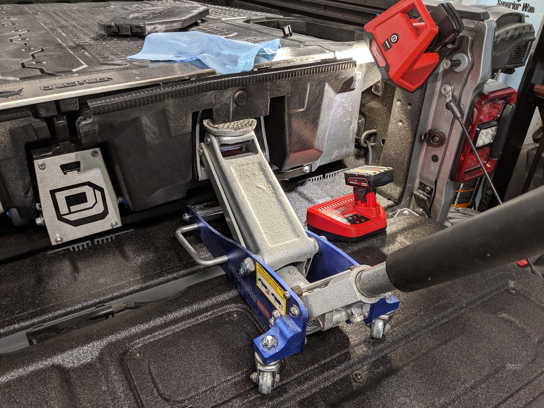

Are you able to plug in and unplug the pigtail with the Decked installed?
The other thing I’m considering is just busting a new hole in the bed above the Decked system for the factory plug. I wonder if there’s enough slack in the wiring harness. Anybody care to take a peek down there and see for me?
Definitely not able to plug/unplug the pigtail with decked installed. I had to take off the hook on that side and use a jack to lift it high enough to barely get the plug in there. No way would I try to do that on a regular basis. If the flap over the plug wasn't there, then sure, but at that point, you're just as exposed as if you had the pigtail.

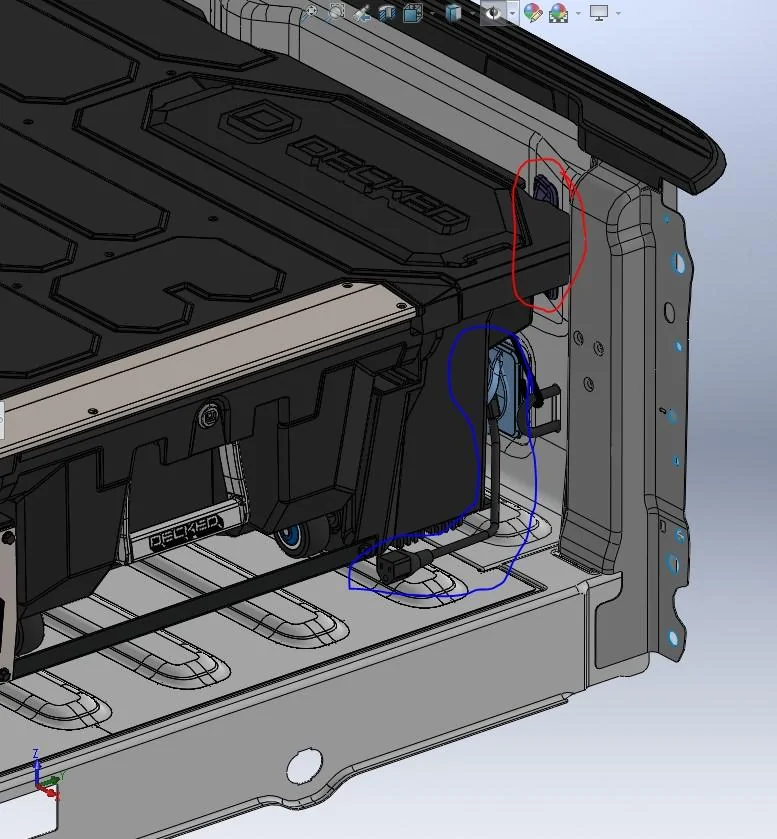

Sorry, last question I guess. How much room is there between the outlet and anything that would interfere with it opening (ammo can probably?) I’m wondering if some sort of custom water proof box could be built around it with a pigtail coming out in front like has been discussed already. I’m thinking like an exterior house outlet, but not that bulky or ugly.
so I don't think there is enough room... here is an image we got in may, it's in this thread:
Jeep Gladiator DECKED detail video decked-jpg
I don't think there is much room there to do very much. That said, I don't know if I'd worry too much about it. I think that circuit can't draw a great deal of power, and it has a bunch of protections built in to it. One of which is - it can't be on without the ignition being on.
