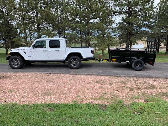

But realistically the above is a false statement. Even the empty JT bed with a traditional shell is insufficient for the majority of the back country activities I pursue (hunting mostly for several weeks at a time). I effectively triple my volume by hauling in a 5x8 Big Tex trailer to base camp (I still have to flip the axle and I will likely pickup someone's reject Rubicon stock wheels and tires to put on this thing to give me more clearance and additional spares, of which I usually carry 2 anyway).
