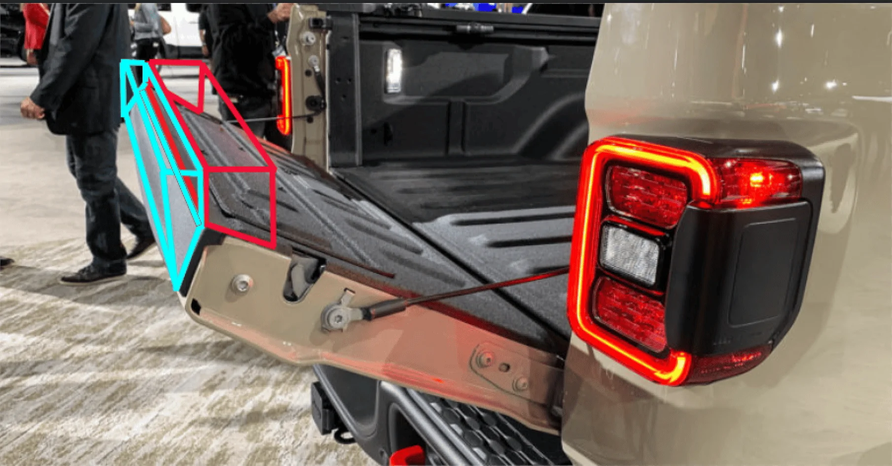

Wait - but the spacer would have to be on the tailgate... right?
Technically, plywood would lay flat on the decked platform, with the tailgate in the 2nd open position. Just that the tailgate will be too low, so the weight of the plywood won’t stop it from sliding. You would just need to make sure to strap it down...
At least that’s what I see in my head...

The spacer would have to be on the tailgate, But if the bed is 5' long, but the decked system is 4 or so inches back, that means only just over half is sitting on the Decked, if you strap it down it'll probably be fine, wouldn't want to drive home from Iowa like that.

Something like this, has to be 5" tall. I'd think about putting a rivnut into the tailgate so i wouldn't have to worry about having weight on it to stay put. , if made out of PLYWOOD, you could then put eyelets into it to strap stuff down right onto the tailgate.
I'm not thinking of 8' long stuff, I'd want to be able to haul 12' stuff without having it fall out. I know with some kind of rack I could hang stuff out the front and wouldn't have to screw with the tailgate.......this might just be a temp fix.

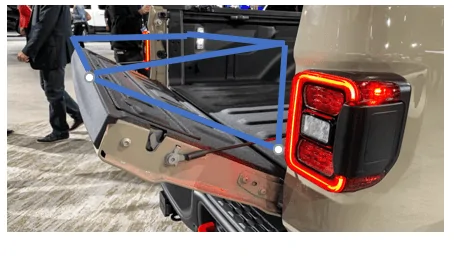

This is what I was thinking
Jeep Gladiator DECKED detail video upload_2019-5-16_23-17-6
Make a wedge that fits between the decked system and tailgate. It should be able to get you 1 to 1.2 ft more supported length.

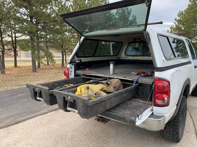

I have a Decked system in my 09 PowerWagon. I have had it for about 5 years now. It holds all my SHTF goods including Hi-Lift, Mud Chains, Shovels, straps, tools, axe, recovery stuff, etc. in the right drawer and what ever else I need to bring on any given adventure in the other. This heavy junk rode in that drawer very well. Drawers worked flawlessly. The only negative is that the locks were absolutely worthless. I could easily pull the drawers open with minimal hand pull pressure which bent the mechanism. I did this on the first day. I emailed Decked and they indicated they had a problem and were fixing it. They indicated they would have a solution in about 3 months and they would notify me and send me the upgrade. 6 months later I saw a post somewhere that they were shipping the fix out but they never contacted me. So I contacted them I got the cold shoulder even after providing them the email chain documenting that they would replace my locks. They refused. They wanted to charge me well over $100. I refused. Using the locks on my shell instead to "secure" the drawers. I had intended to install locks on my tailgate instead but never got around to it.
So, I am highly dissatisfied with their customer service. But I do like the box and drawers. They work. They are durable even when bouncing down rough roads for 5 years. Other than the locks I have had zero issues or problems. Would I get a system for my new Gladiator? Yes, I would. I called my local dealer today in fact. The dealer did not realize our new truck was out and did not know if Decked was shipping systems for the Gladiator or not. They called Decked. ETA is mid - late fall 2019. I will very likely buy another.
With my system I was also skeptical of the loss of volume due to their design but I can say it really never hurt me much. With the Gladiator our space is more limited so it may be a bigger limitation. But again I think i will buy this again.
