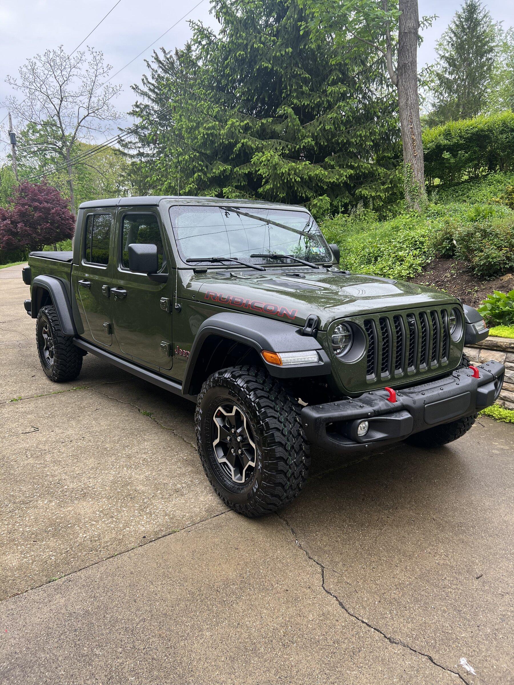

Just got my gladiator yesterday and wanted to give my initial thoughts. After driving around in it a bit I think the MT and 4.10 gearing is perfect in this truck with 33s. Reverse seems fairly standard to modern day manuals. I really like the gear spread and shift points are where I’d expect. Shifts are also very smooth and precise. It really feels like a normal 5 speed when it comes to gearing. 6th is good for keeping speed on flat/downhill highway sections at 70+. Which is actually really nice. I used to always want to coast in neutral with previous vehicles on down hill sections but then you’d be slowly slowing down. Having 6th takes care of that. The 3.6 definitely likes to spin a little bit faster than the old 4.0s I was used to. Shifts are at about 2100rpm and feel natural. Despite what I’ve read about the clutch, I think it is really nice. It engages slowly from as soon as I start letting off the pedal to about half way up then it bites pretty hard. This is where I think a heavy weight flywheel would really shine. IMO the clutch feel is great and more modern. Its just that the 3.6 needs a little help to keep from falling on its face. I think the reason people don’t “feel” the clutch starting to grab is because the engine isn’t transferring its rotational speed into forward momentum but rather just slowing the engine down and stalling. So I really don’t think this is an issue with the torque of the 3.6 but rather the light flywheel. Just needs a little more mass to keep that engine spinning. I’ve noticed on cold starts when the rpm’s are up a bit that the Jeep doesn’t have any issue starting off. Only after it’s warmed up and at normal idle. Right now when starting from a complete stop I just give it a little pop of gas as I’m letting the clutch out and that takes care of it. I’m already pretty much used to it after the few drives I’ve done. 4lo needs no gas input at all and feels awesome. I can’t wait to get it out on the trail!
Thanks everyone for all of your inputs! I’m definitely glad I went manual!
