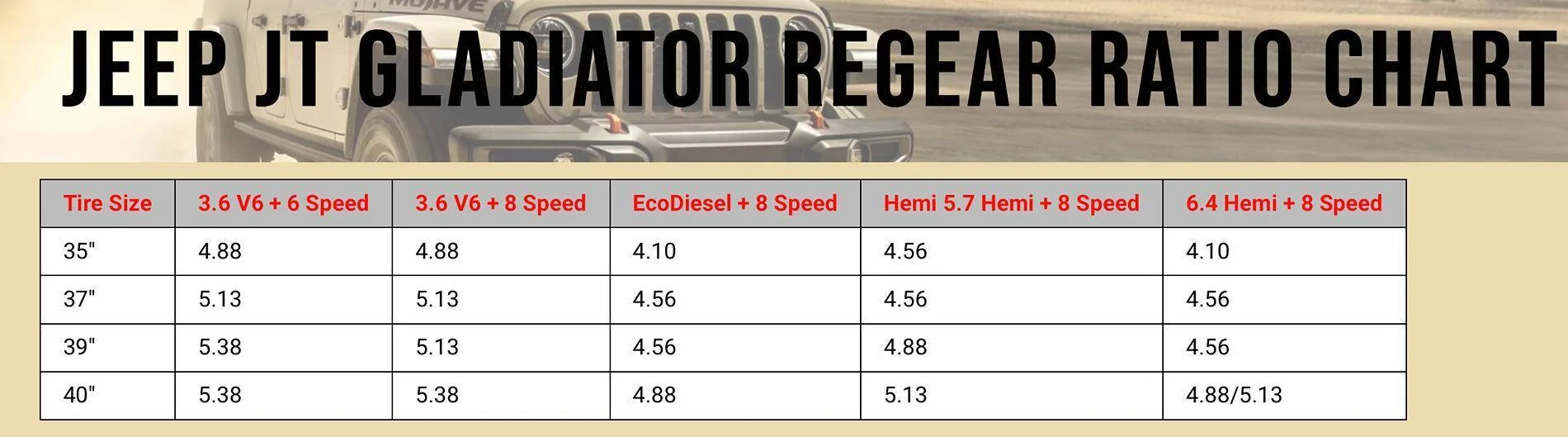

Found the following chart in another post, likely a repost within this thread. Hope it helps.
Jeep Gladiator Gearing for Gladiator EcoDiesel 1745711735611-mc
Thanks, I’ve seen it before. Between the JT and JL forum it seems like 4.56 at minimum and No deeper than 4.88 YMMV
Was hoping to get more real world feedback
