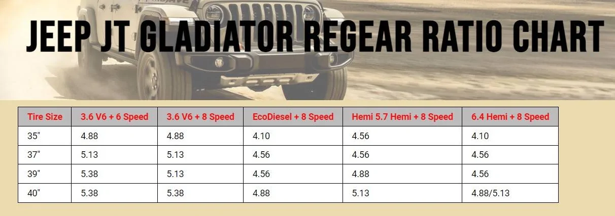

Here is what one of my local shops recommends for gearing on the Gladiator. They are also one of AMW4x4 partners as well and do their conversions for them here locally in TX.
Exodus 4x4
Jeep Gladiator Gearing for Gladiator EcoDiesel gears
