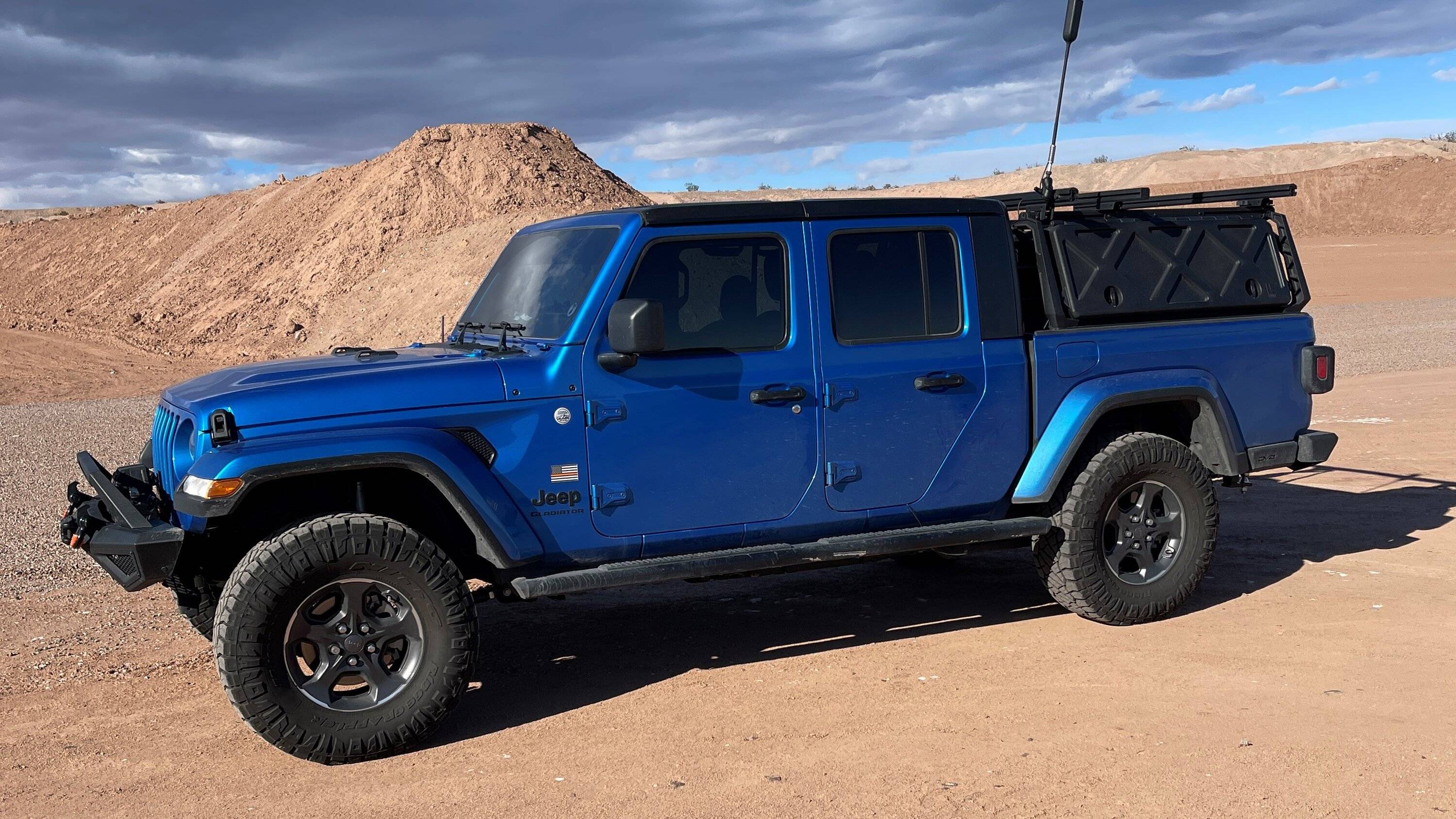

Hello everyone!
I'm in need of some assistance and insight from the fellow jeep community on gearing, there has been many different answers on this topic for the at least the 3.6. I used to have a gas 3.6 gladiator Rubicon on 37'S and ran 4.88 from a performance aspect it did great, i did lose some functionality in range and MPG as to be suspected. but was well worth it!,
Many people that i have seen on YouTube as well as local shops have recommend what seems to be odd, 2 very popular youtubers whos name i wont mention, one of which has 5.13 gears and the other said he sees no need to regear the EcoDiesel (Which from what I have experienced is silly) in addition a very popular shop here in California recommended 5.13's, 5.13 in my opinion is way to much at least for my use.... Diesels do not like high RPM 5.13 on the ecodiesel does not seem like a good idea, neither does 4.88.... hoping someone can shed some light on this or maybe provided some professional insight as top why I may be wrong there...
With that being said my primary use for the my jeep is the following,
travel out of the state, off-road, camping. hence why i bought the jeep LOL
-I want Functional MPG, pre lift and tires here in CA i could easily obtain a 23 MPG, after the lift and other items, I am at 18 MPG (Not terrible), which is almost close to the gas 3.6 i was getting 12/15MPG.
I take this vehicle out of the state on long trips and want to retain that ability and functionality of range, in addition occasionally driving 85MPH LOL.
- My wife and I are usually camping at least 2 weekends out of every month, sometimes less sometimes more! during these trips we usually hit some fun trails here in CA (Big Bear) and obviously want my lower range of gears.
-I also have no intention on trailering this jeep, i also have no intention to go 40's.... (Although it would be great!)
Build
I have a 2022 Jeep Gladiator Rubicon EcoDiesel, as many of us know comes factory with 3.73 gears.
it has been installed with the following
- 37x12.5x17" Nitto Trail grapplers
- 17" KMC Grenade crawl bead locks
- 4.5" Rock Krawler X Factor Lift
- Front/Rear Adams 1350 Driveshafts
- Factory steel bumpers
-Warn Winch
-Rebel Off-road Mid height bed rack (Has been fitted with goodies) Heavy. weight is not provided on site
-Roam 95L case (Packed) at least 100lbs
Gears
some of you may not know.... but Nitro gear is coming out with a 4.30 Gear set for the M210/M220 Jeep JL/JT its specifically made for the ecodiesel since they states "What you need is really between a 4.10 and 4.56"
i am heavily debating waiting longer for this gear to be released, i have been waiting and informed since October of 2022.
the gears i am debating in my mind are 4.10s 4.56, or continue to wait for the 4.30s my concern is 4.10 is not enough (Or is it?) is 4.56 to high? I want the ability to go 85 still... to some of you that may sound funny... but here in CA people drive fast.... very fast.... at least here in Ventura county not to mention leaving the state and all the open desert 85MPH is comfortable for me.
curious what you guys have done! any insight helps!

Ok so here is what we've found and we have 4 ecodiesel jeeps 3 Jt's and 1 Jlru. My son put a 4.63 gear in his 22 Jtr it pulls his trailer better but still a little short on gear I put 4.88 in mine absolutely perfect still does 85 on the hiway get 23 to 23.5 mpg pulls better and don't get warm as it used to pulling up the hills in Co/Wy mine is 22Jtr 3.5 lift 37 Mickey Thompson's had the work done at local 4 wheel parts . Running stock gears in the the other 2 1 with 37's and one with stock my wife has the Jlru Tuscadero pink all stock ecodiesel she get 30 to 30.5? Never got that in my Jt's but did get 26 to 27 all stock Jtr

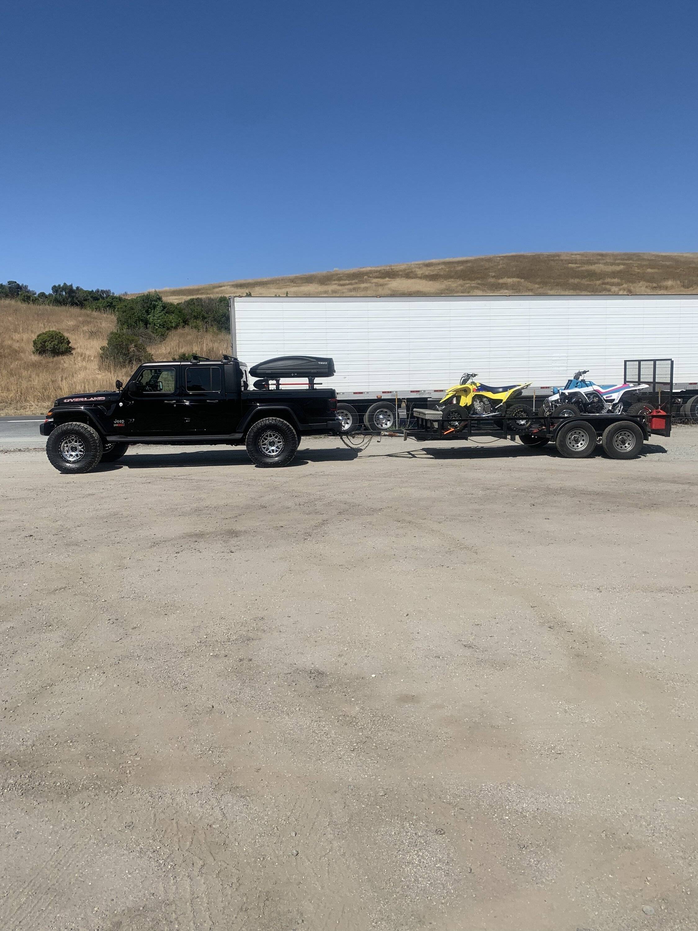

For anyone thinking of regearing an ecodiesel on 37”s, DO IT.
For a couple months I was hesitant about it and couldn’t find a concrete answer in the forums. Only found about 2-3 people who have actually done it and their suggestions. Most are people saying that they don’t need a regear with 37”s and how they can tow almost anything. Anyways I bought my jeep a couple months ago and Immediatly lifted it 2.5inch with Clayton lift kit, 37s, banks tuner and their pedal monster, half rack and cargo container, etc. I’m a 26yr old Guy that loves going fast and was dissatisfied with the Jeep’s performance. Once I added the banks tuner and pedal monster it got better, but was still left with the desire for more. I tow a flat bed (14ft)and some (2-3) quads to and from the off-road park, and the first time I towed with it lifted I was so dissatisfied I decided to regear it. Going up some hills you could feel the engine was working too much and was a struggling to pick up speed. Anyways I went with 4.56 Dana Spicers and have just finished the breaking process, all I can say is it’s a night and day difference. The truck performs way better, from 0-about 40 it pulls extremely hard. I would even dare to say it pulls harder than the 5.7hemi, 5.6 titan ,5.3 vortec. Again this is in gear 1-4, anything above that the hemi would obviously beat it. I am totally happy with it now and will be keeping it for sure, I was thinking of trade it in before even though it only had 3,000miles. Regearing was my Hail Mary to keep this truck and it worked. Again I know people on the forums say they “think “ It doesn’t need a regear with 37” but I believe it is totally according to your driving style and preference. I would highly recommend a regear to anyone with a lifted ecodiesel dreaming of a better performance. I just finished the breaking process so don’t know to much about my MPG yet, however before it was around 16 in town. This is with rack, cargo container, 37”, and truck bed full of Milwaukee tools ?. I noticed during breaking it went up to 20.something, however I was going easier on the pedal to not damage the new gears. Rpms are obviously higher but not to bad. Before going 65 (Cali) it was around 1500, and now at 65 it is around 1950. Just want to help out anyone who is think of regearing to get more performance, do yourself a favor and do it.
