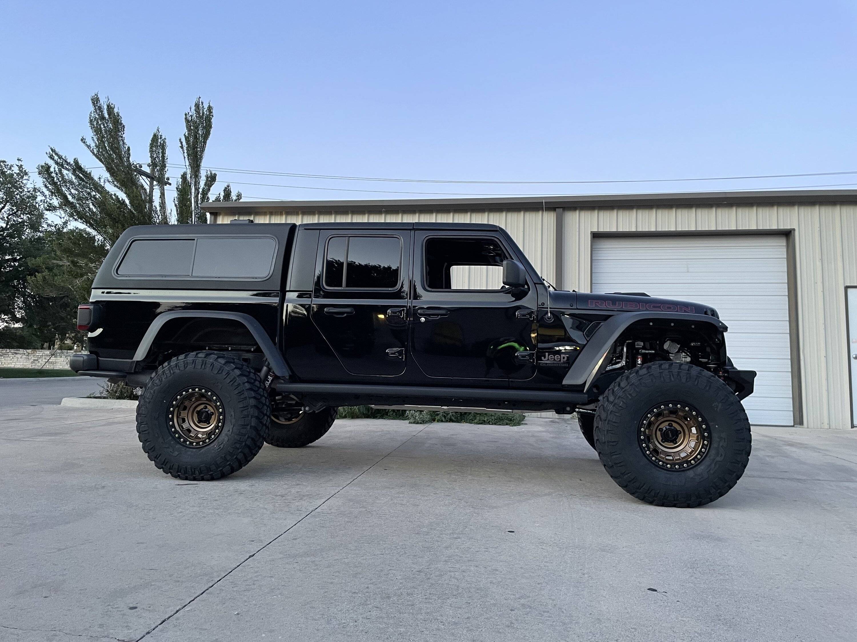

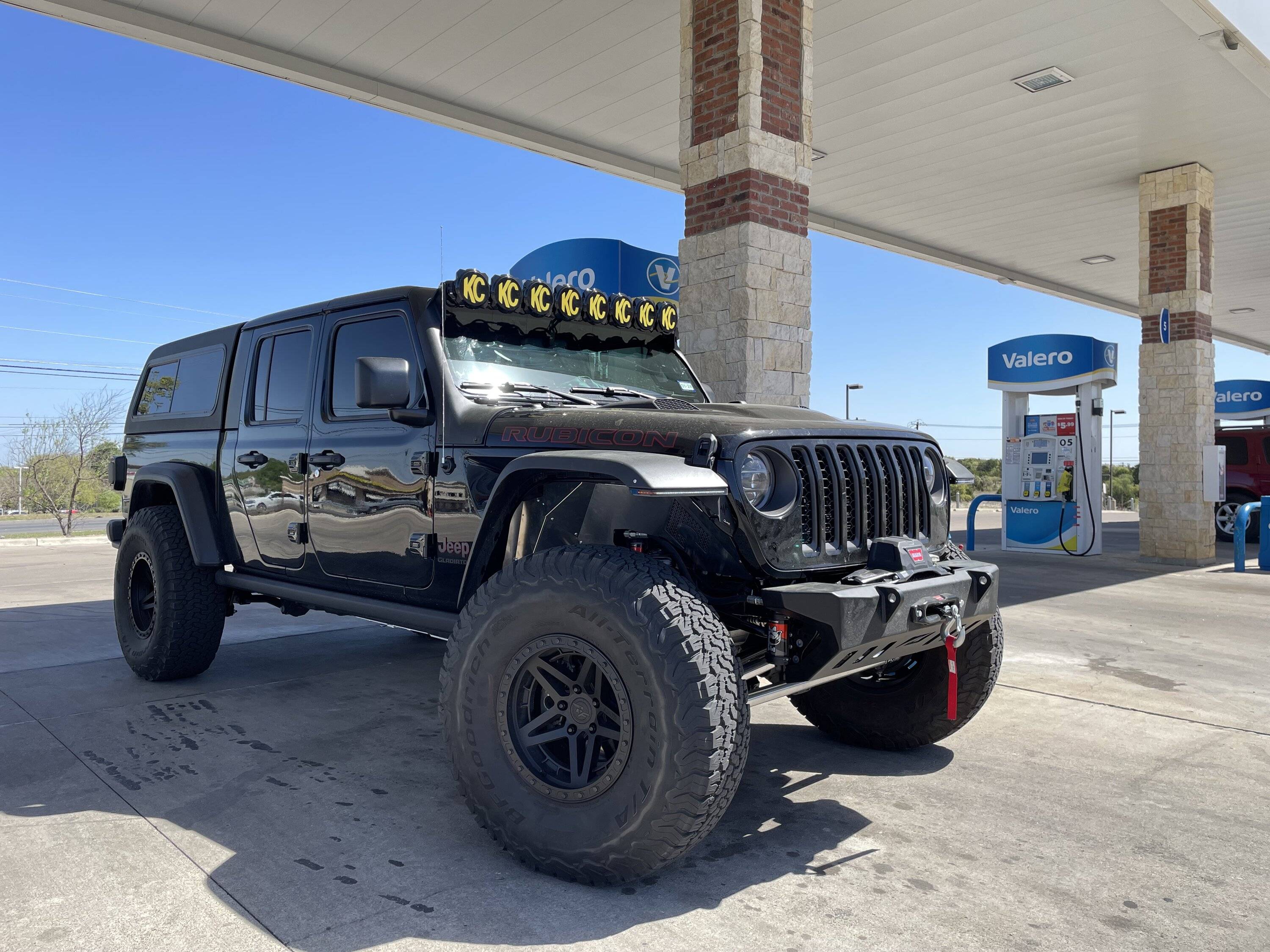

I have a 22 Ecodiesel JT with about 15K miles on it now. I drove it to Moab last year on 39s with 3.73s and followed my buddy in his identical truck on Toyo MT 40s and 4.88s. We got the same average MPG overall on that trip.
I have since taken his axles with the 4.88s and put them in mine. For a while I was on 40" Razrs and I felt that it was perfect. I initially thought it was slightly over-geared for the 39s with the 4.88s. I have had the 39s back on it for about 5K miles now and its a lot of fun to drive and I no longer feel like I have too much gear unless I'm putting around in a neighborhood.
I personally would not re-gear for 37s with the Ecodiesel and if you do I would go to 4.10 or 4.56 and definitely no deeper.
I was a tester of Nitro's 5.29 gears in the early JL market and they were awesome on the JLUR on 39s at the time. However, they were noisy as hell and I bet we never see the 4.30s come to fruition.
I attached a couple of pics because who doesn't like looking at Gladiators? lol

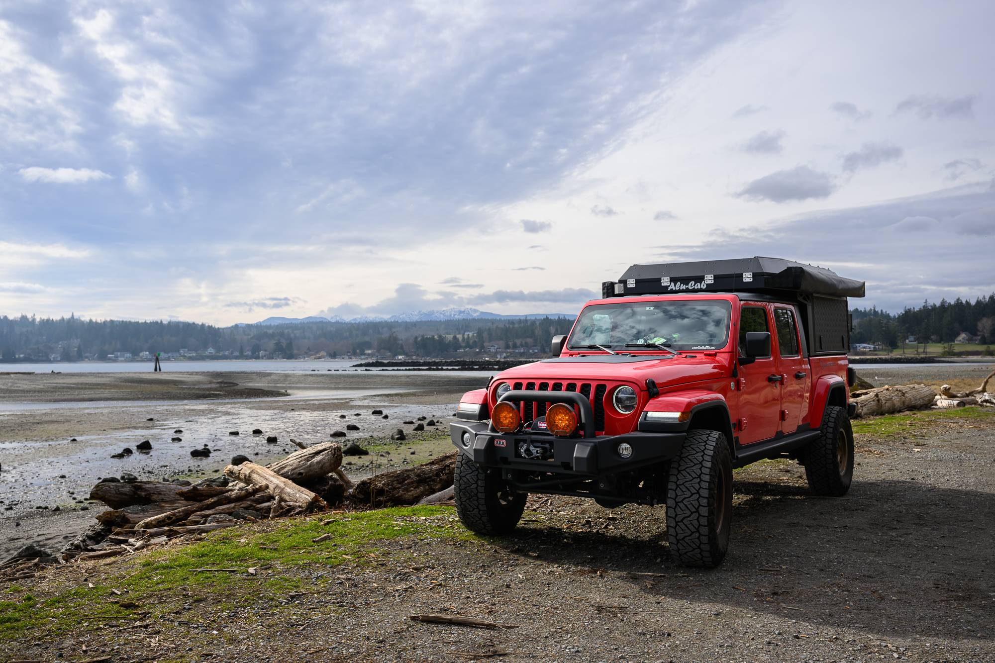

I felt the 37's and 3.73's were fine for my application until I got an RV that was 1" wider and 1.5" taller than my previous RV. My RTT and rack are also are below cab level.
I would have liked a set of 3.92's (not available) with 37's in an all around application where the truck has minimal wind resistance. (no camper or RTT above the cab) and towed say up to 5000lb in the hills.
I went 4.10's and didn't like it with my worn 37's, but had planned to jump up to 38's which split the difference.
Were finding that the guys with the Alu-Cab campers have a bit more with resistance and need to step up to the next available gear, 4.10's so they can operate into the wind and hold at least 7th at higher speeds.
Mine (4.10 + 37's + Alu-Cab Canopy Camper) will hold 8th gear in most situations on the highway, only dropping to 7th on more vertical hills. Wind can be a bitch though.

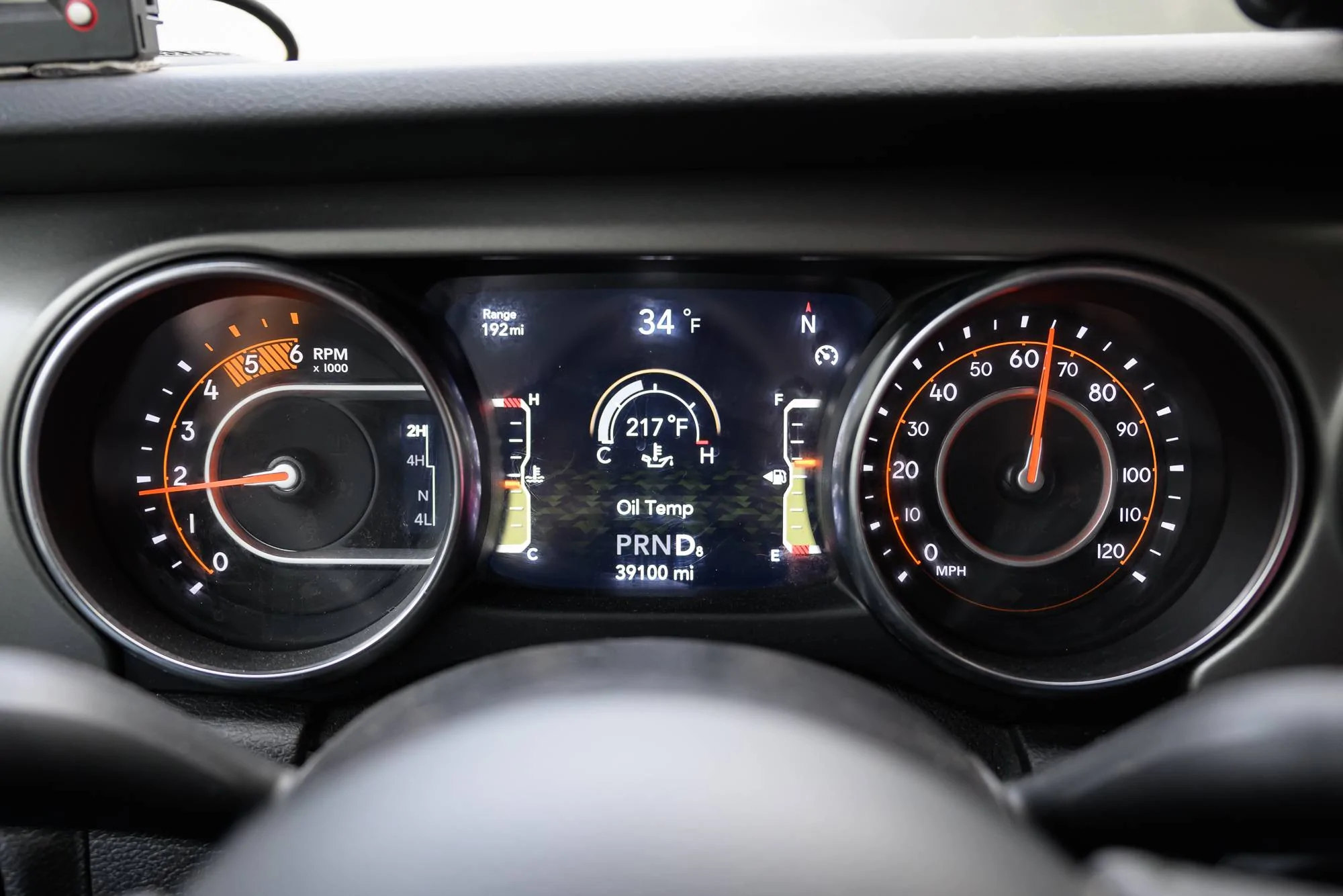

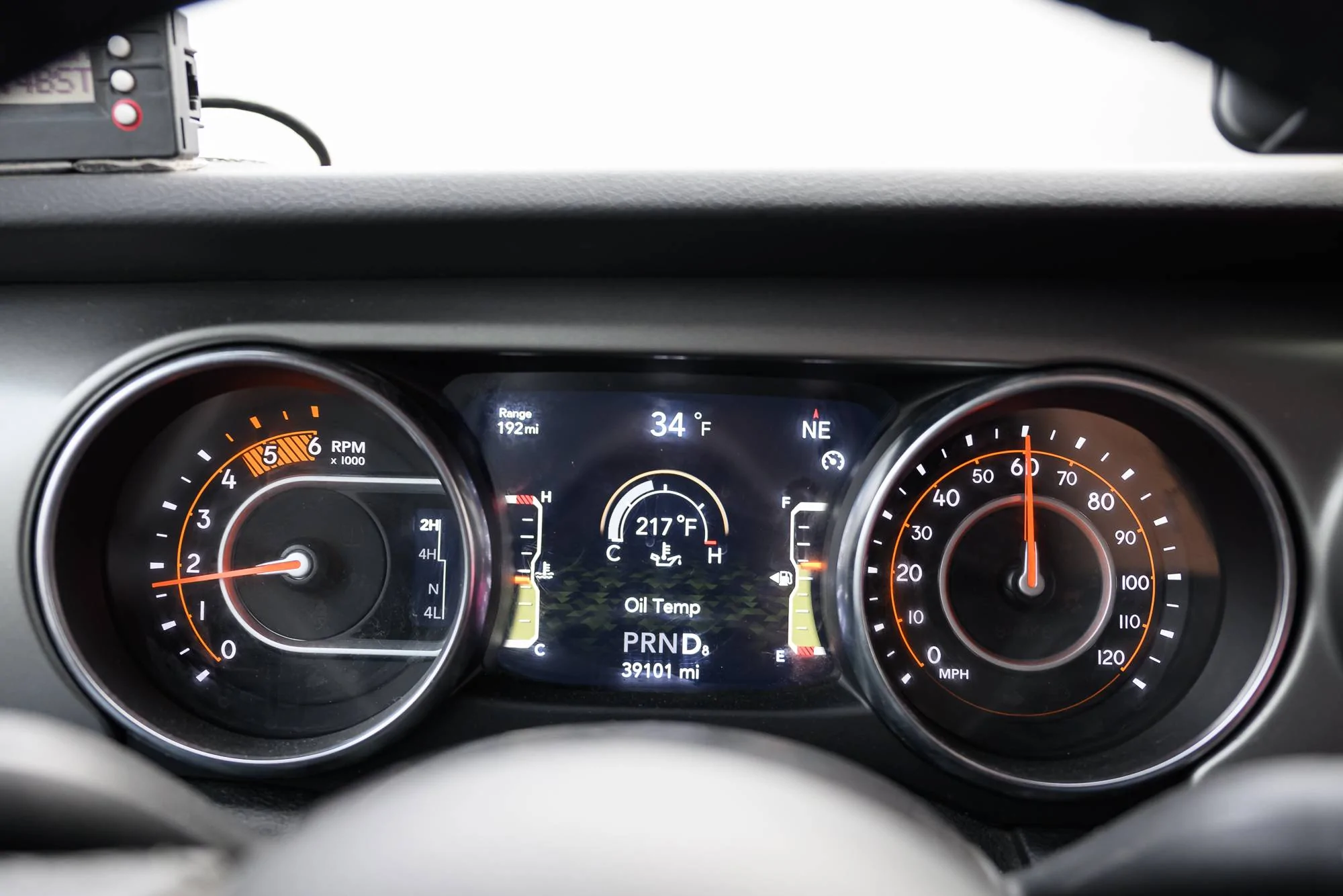

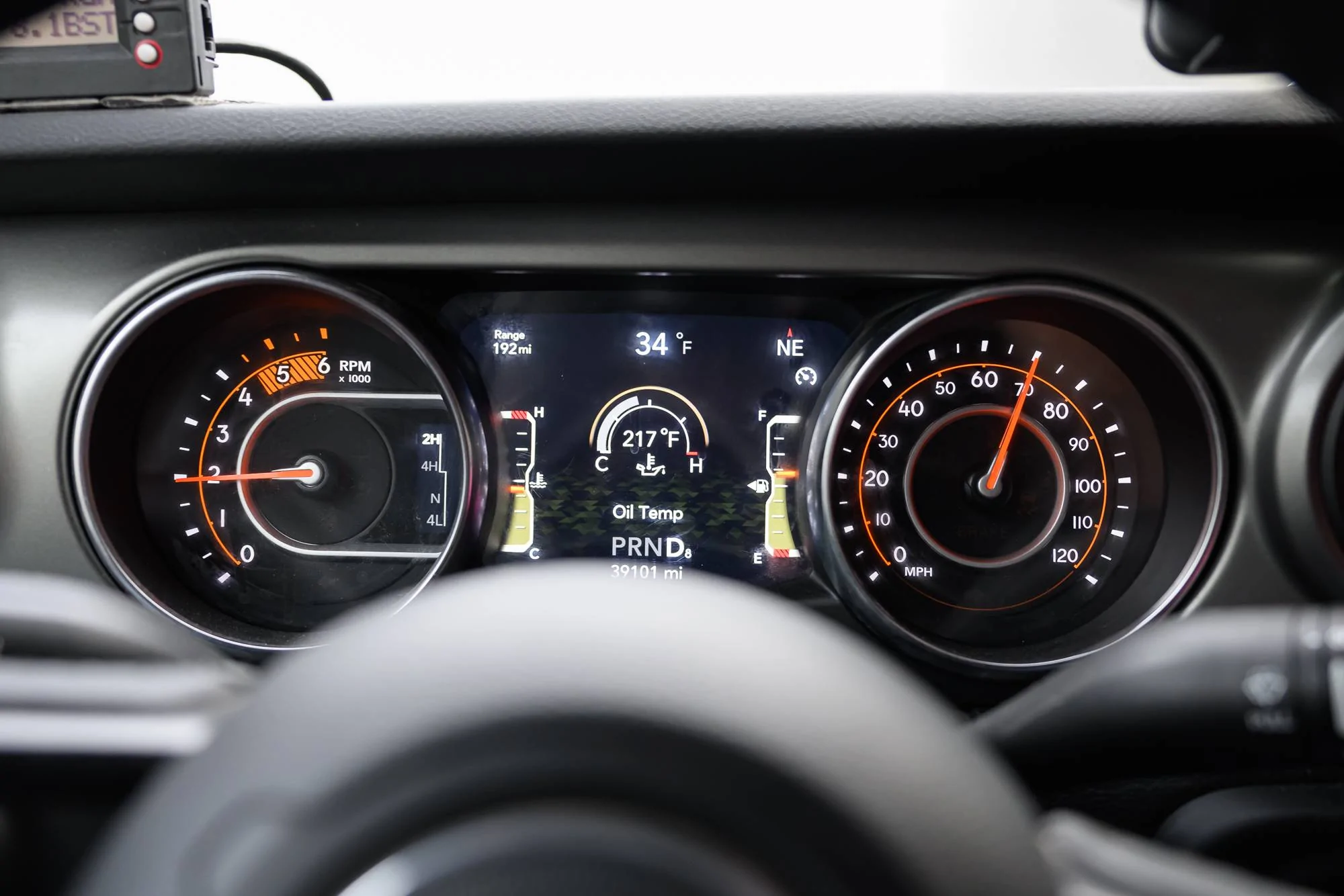

My Gladiator is heavy and I am happy with 4.10's and 37" Nitto Recons. Nitro actually did a batch of the 4.30s, but I barely missed the boat when shopping for the gears. I would have gone that way, but again, I am happy with the 4.10s. The Jeep holds 8th gear on everything except the steeper hills. Fuel milage will range from 21-23 on the highway if I try (based on last trip from WA to Southern CAL). Not bad for a Jeep Motorhome ?
Here are some RPM ranges for reference from a couple of days ago.
