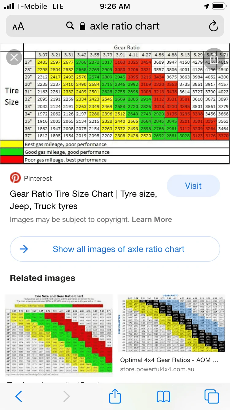

Gearing to run 35’s? Any suggestions for minimum gearing to run 35’s or optimum gearing? Thanks everyone for the input
