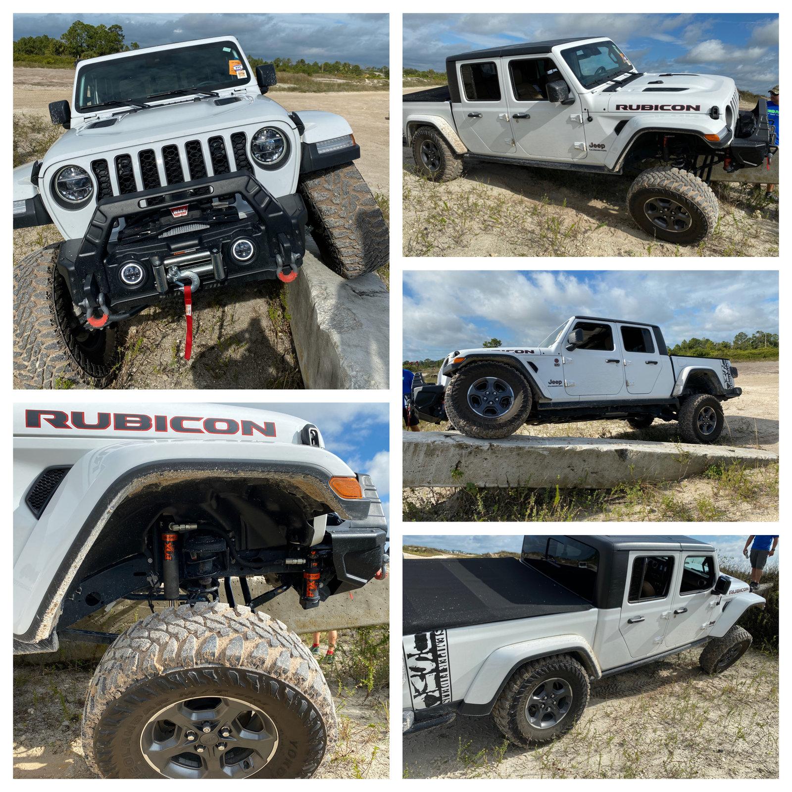

With 35s on stock rims and a 2 in lift you will not rub. I’ve only rubbed once and it was on a obstacle course were I was making a hard left turn (Wheel completely to the left) and the right wheel was completely tucked into the fender. I rubbed a little on a drag link.
This only happened once and I confident that will never happen again.
I was coming down a small hill that had a bump the right hand side and I had to make a sharp left turn.
I’ve taken my on multiple trips to Citris, Fl. Beasley, Ga, and keep events. I did end up get 1.5 in spacers but didn’t really need it.
Now, my opinion go with 37s. I just mountes them a few ago and it’s a hell of a difference between 35s and 37s regarding clearance.
With my 35, I was constantly hitting my skid plates , diffs, rear tires and rear bumper. With my 37s I’ve cleared everything we’re my 35 hit. I do rub a lot more so I have loss a little in articulation but I’ve gained a lot more in clearance. With the 37s and a right line you gain an addition 2in of clearance goin up and down steep hills. Yea i rub a little on the inner fenders but that’s it.
nonetheless here are some pic of me flexing on 35s. What you see the max articulation before on tire lifted off the ground. With 35s I still had about 1in on the front tires before they rubbed.

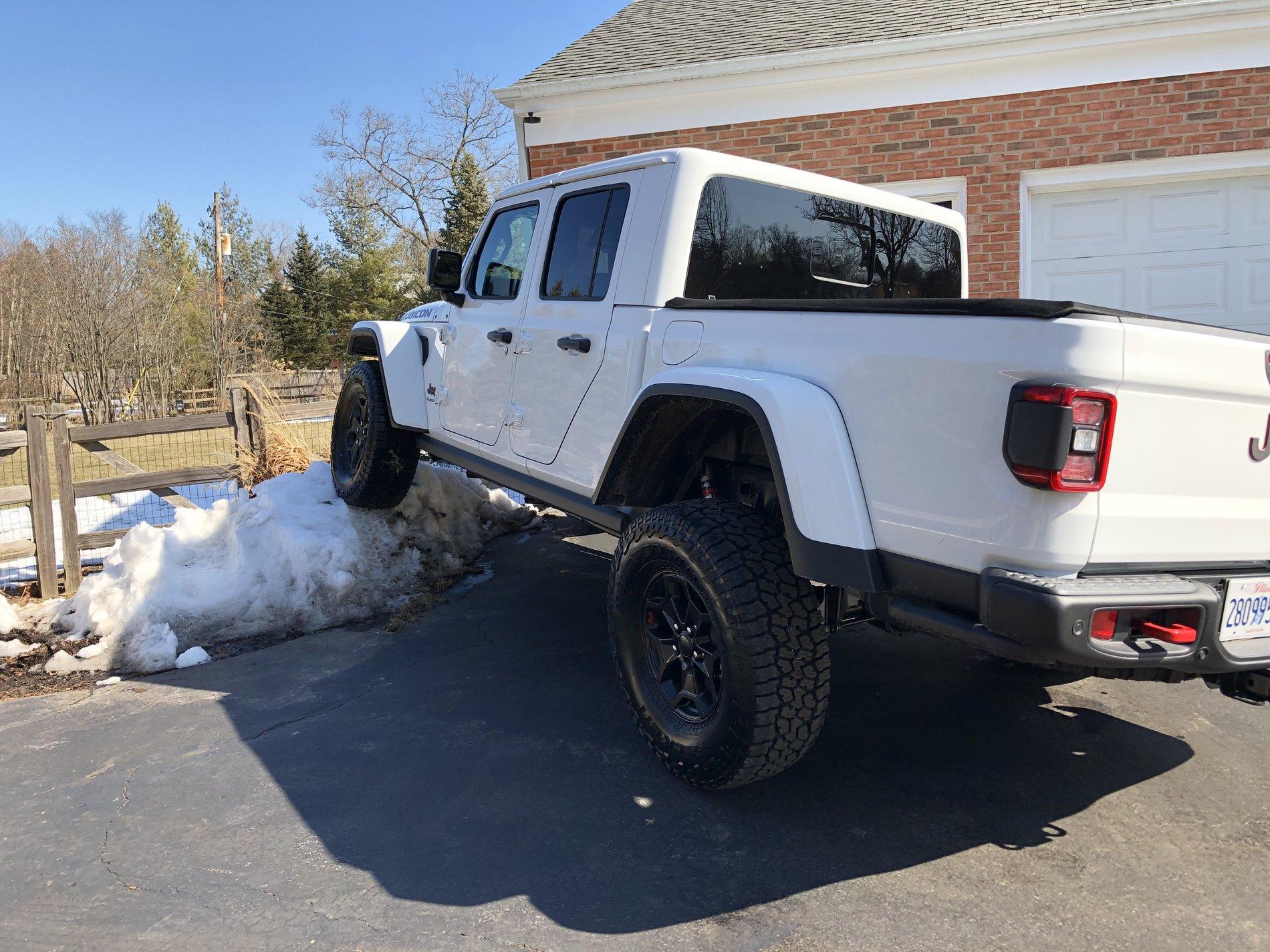

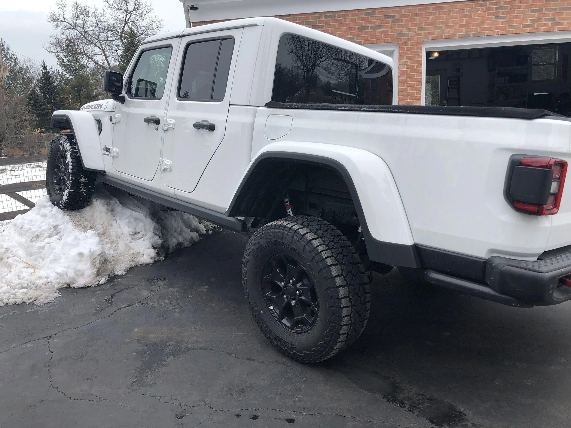

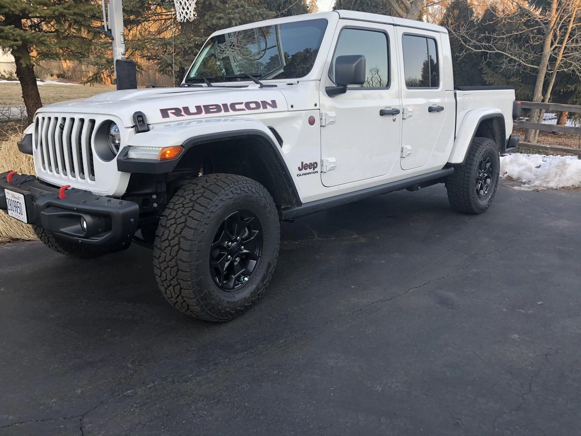

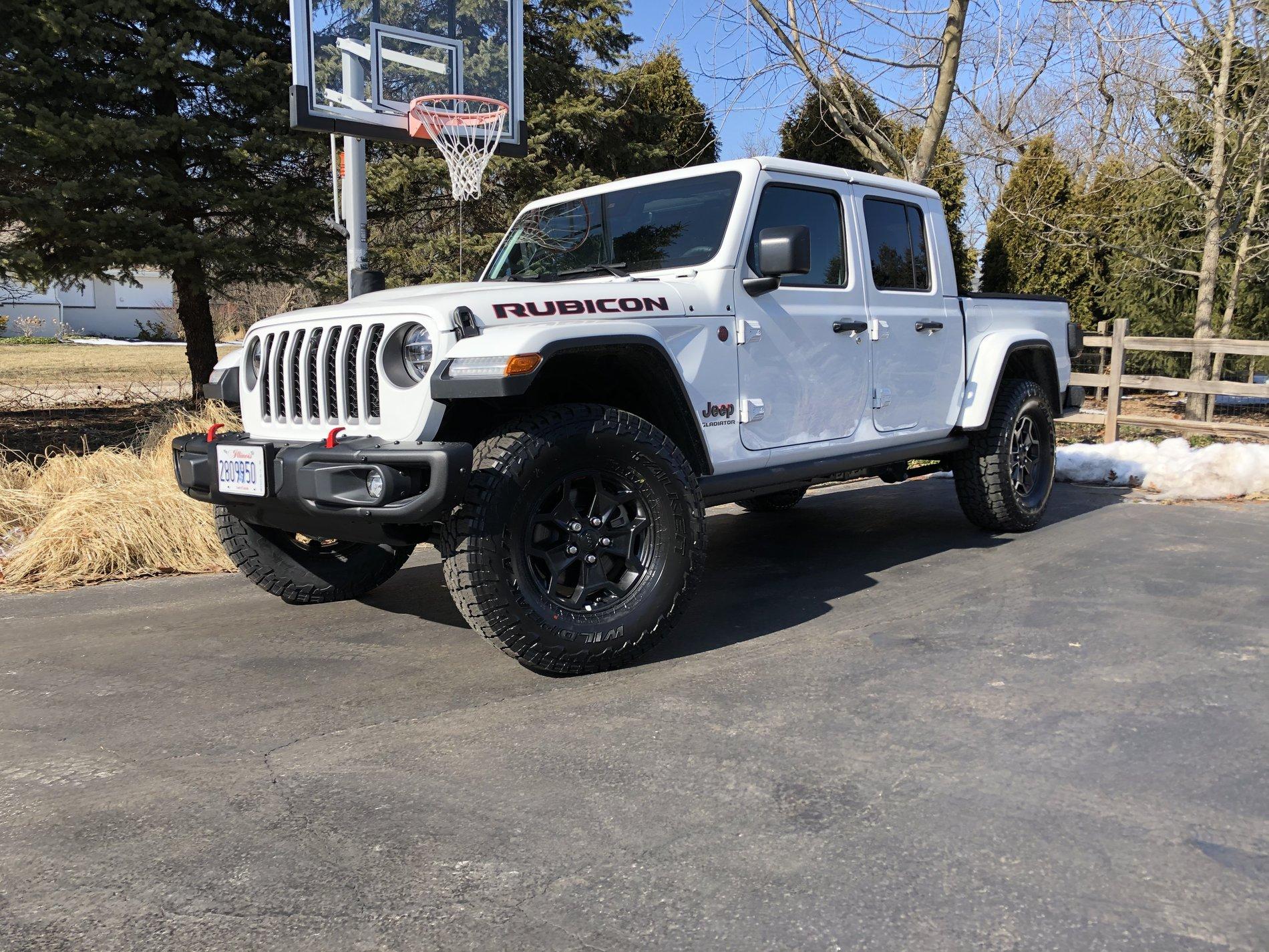

I swapped out the 33” Falken tires that come with it for the same tire in 35”, but a lower quality 5th tire and sold the OEM ones for $700. Cost me about $700. Looks good. Thinking it would look better with some spacers.

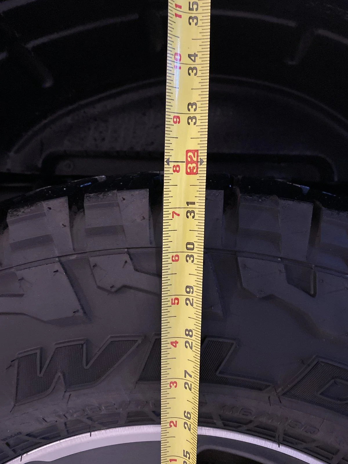

Does anyone have a pic of the mounted height of a 35x12.50x17 or a 315/70/17.? The factory 285’s, that claim to be 33”....
