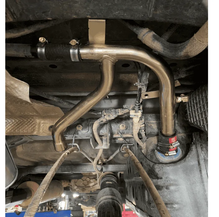

Can I ask about the fill method? Does it passively fill after the main tank is full, or does it have its own fill neck somewhere?
It passively fills yes. Below is a screenshot of what it kinda looks like.
Jeep Gladiator Destination Unknown - 2022 JTR journal Screenshot 2023-12-18 at 08.05.36
Factory tank on the right. Aux tank will be on the left - not installed (not my picture). Top left is the fill tube where you put the gas nozzle. So the aux tank, being on the left and first in line, will fill up first. Once it is full, gas will overflow to the main tank on the right.
The original version actually had a totally separate fill tube, so when you open the gas door there were two holes to choose from, one would fill the factory tank and the other the aux tank. I am glad they changed to this though because that original version looked really weird and there didnt seem a way to cap them off well for dust intrusion.

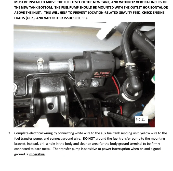

Wait, this doesn't have a transfer pump from the aux to the main? I thought that was kind of the idea.
chorky
chorky
Chad
Feb 26, 2022
175
3,466
3,801
Montana
'22JTR, '06 LJ, '06 TJ GE
GIS Specialist
Yes it does have a transfer pump. Thats really the only way you could get gas over to the main tank. Here's a screenshot. Not my photo.
Jeep Gladiator Destination Unknown - 2022 JTR journal Screenshot 2023-12-18 at 08.33.10
What's cool about it is the pump has an auto shutoff after I think 2 minutes of not recognizing fuel. So you don't have to worry about the pump just pumping away all day. I am considering a way to make the pump run on my auxiliary batteries though so I could fill it up when stationary.

Also - don't drill a hole in the body like those instructions say. Run another wire to the battery if you have to. No need to introduce another potential rust spot. My ground will go to the aux battery ground buss - which runs back to the main battery via 4ga cable.

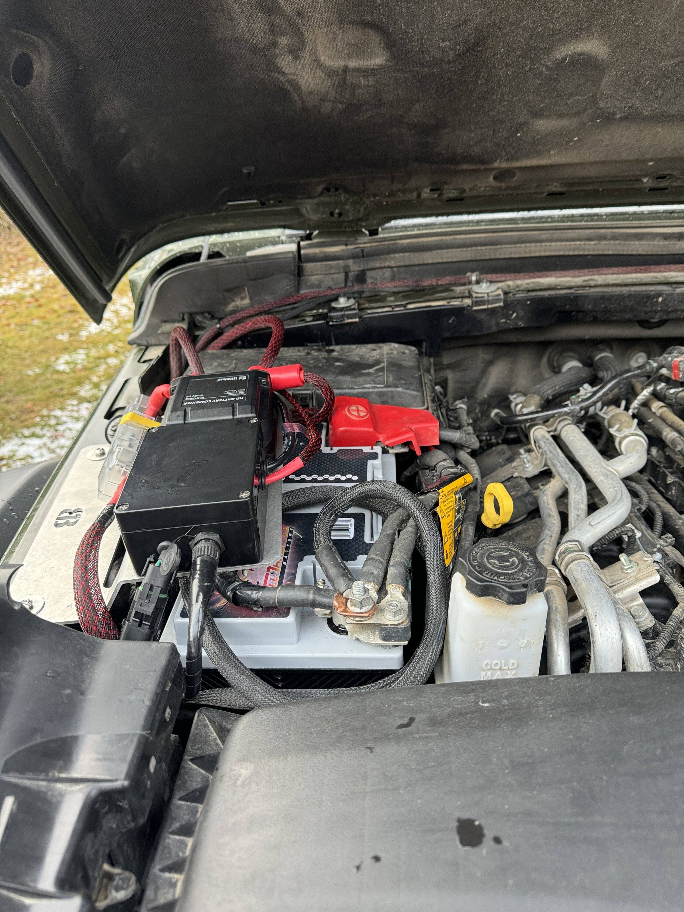

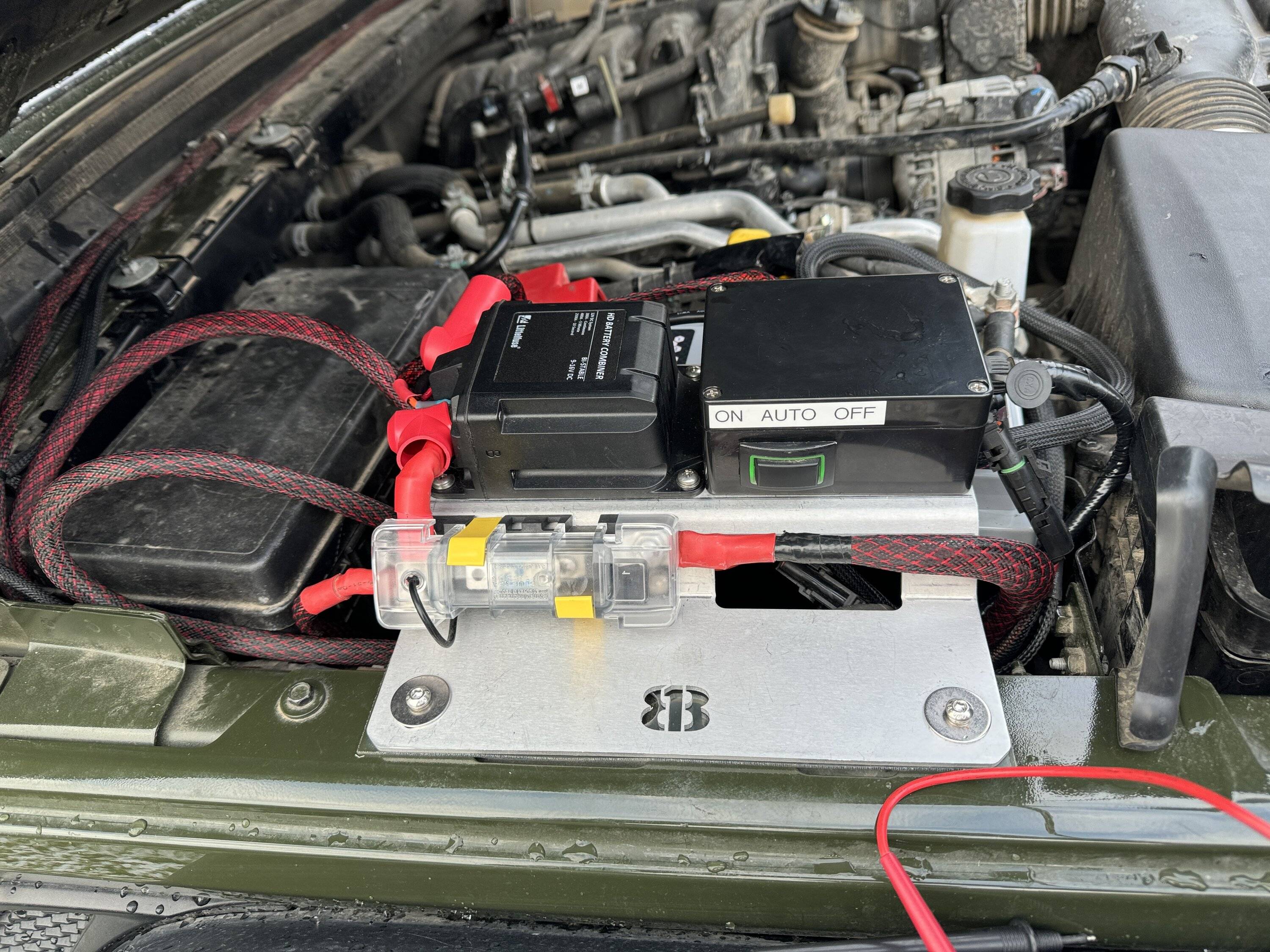

This colder weather sure is making projects take longer now. Today I finished the Genesis system overhaul. If you recall post # 192 (https://www.jeepgladiatorforum.com/forum/threads/destination-unknown-2022-jtr-journal.66430/page-13) I removed the Genesis tray and went back to a factory configuration. The reasons are many, but primarily wanting a more stock friendly setup should the dealer have to make repairs requiring removal of the battery tray, and due to realizing longer trips than initially planed resulted in needing another battery in the bed anyway.
So, this idea came to me quickly but I pondered it for a while. Unfortunately I busted the battery combiner a few weeks ago, so had to reach out to Genesis. Sean ended up answering, and we talked about my situation. He was kind enough to explain the system operation to me a little better, as well as being willing to sell me a replacement combiner. So Sean, if you read this, thank you! Though the dual battery tray was removed, I still wanted to retain the Genesis operational system.
Fortunately I had a little sheet of aluminum lying around that was not being used. So after test fitting some things and making a few measurements, I realized it was going to fit perfectly. Then, finding a plastic box on good 'ol Amazon again, to secure the electronics, I went to rewiring everything. Since the Genesis tray was removed, I no longer had the lugs to attach fuses to. So here I a Blue Sea safety fuse block with a 100a fuse for the 4ga wire going to the bed. Additionally, I used the input side (left) of the fuse block to also attach the main wire feed (6 ga) for the Switch Pros system via the Power Tray mount. In doing this, I can be assured that no parasitic draw from the main battery will occur when the engine is off, even though the switch pros has an engine on signal to power-up. Also with this, is the ability to run in-cab lights that I installed that are always hot (Post # 134 https://www.jeepgladiatorforum.com/forum/threads/destination-unknown-2022-jtr-journal.66430/page-9). These lights are powered via the switch pros system, but this is the only circuit that is 'always hot'. However, in this situation, now the power will be provided by the house batteries when the engine is off and the battery combiner is in an open state. So if I accidentally leave those cab cargo lights on, they will drain the house battery and not the main vehicle battery. The result is fully functional, and very clean.
The setup is designed to be quickly and easily removed should I need to for more warranty repairs or battery replacement. On the back side of the box closest to the engine is two grommets that feed wires from the combiner lugs as well as the combiner electronics. On the right side by the air filter is a port for the factory Genesis G-Screen to plug into, and a dual wire output - one being ground, the other being the 'engine on' signal. Both standard set-up's for the main Genesis system. So nothing is different other than the layout. I left the plastic box on for this photo as I dont want Sean or anyone else think I am trying to steel or redesign their system. But this was needed for my particular situation and desire.
Now I will just have to rewire the bed electrical to rearrange a few things and the system will function normally.
Also, a shout out again to Genesis being willing to chat with me about their wiring and operation. They also have a new product specific to the Diesels - however, you can probably purchase just the diesel tray and use it here. Their new design includes a tray that attaches on top of the factory fuse box - so no removing the factory battery tray. I checked measurements and with some slight modification it will fit the gaser version of the PDC cover. So, that is another option as well. I went this route as I already had started wiring things when I found out about the new diesel tray.

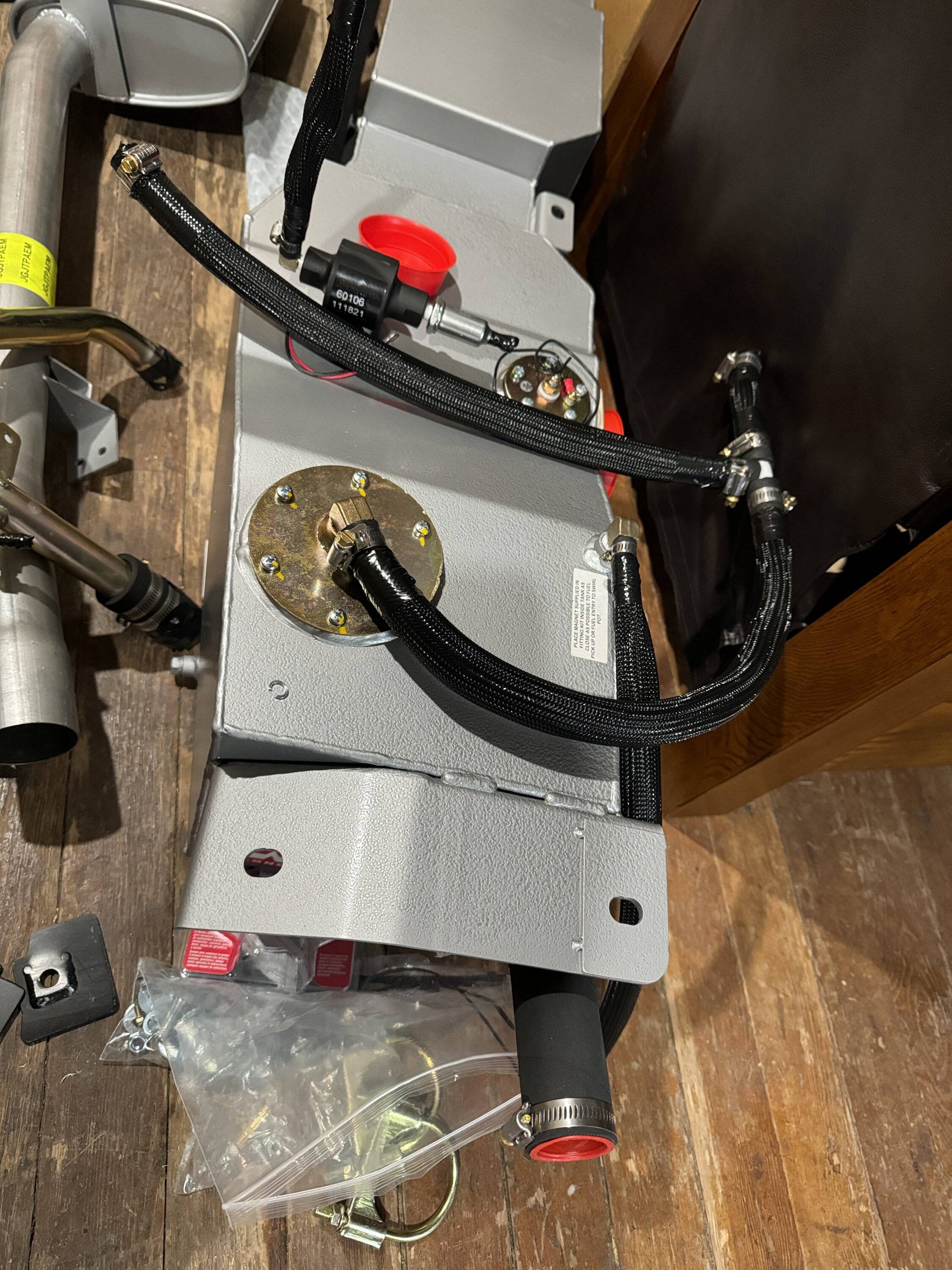

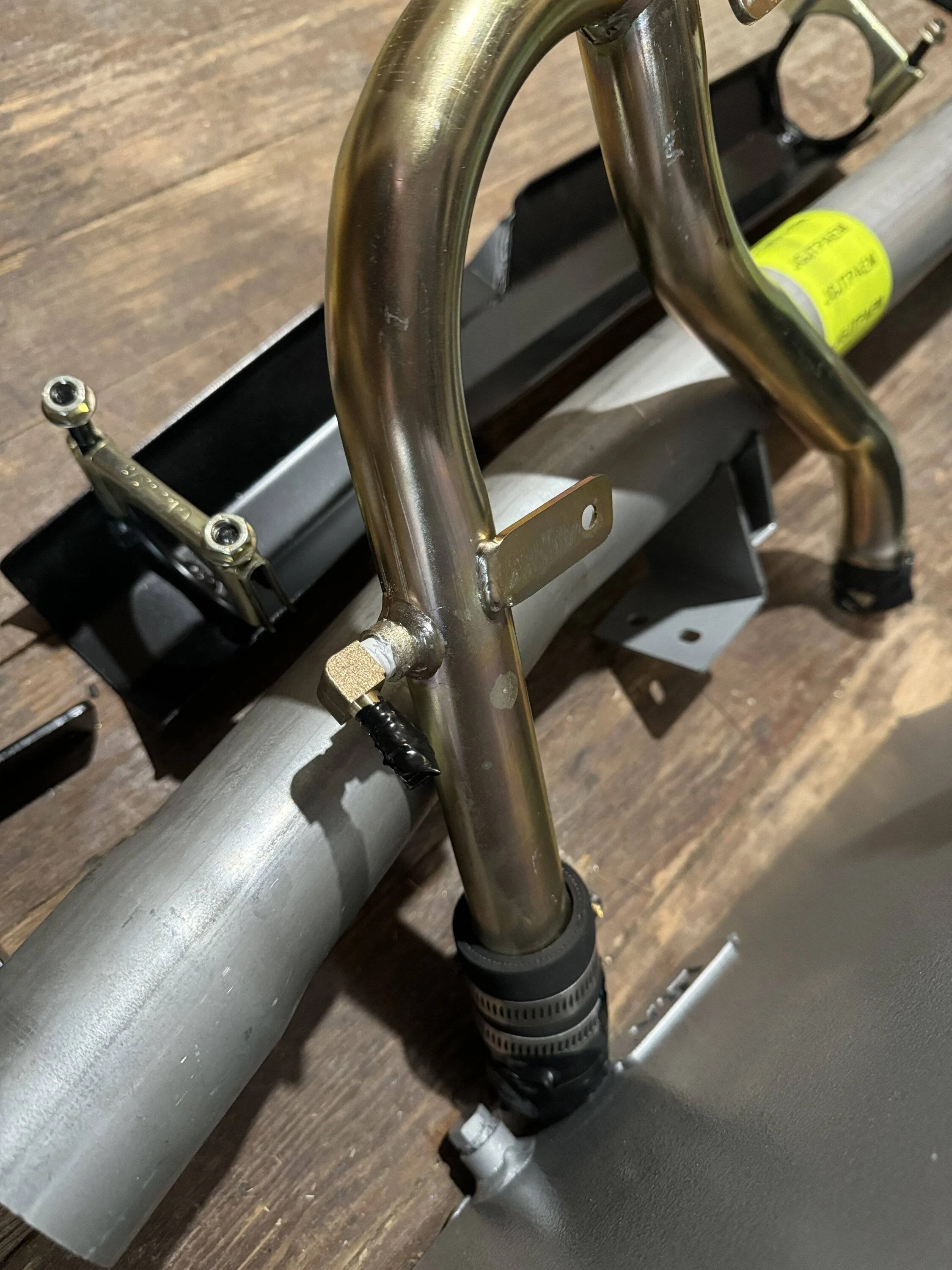

With temperatures outside being just too cold for work, and darkness coming around 1600 each day, I decided to prepare the aux tank as much as possible for install. All of the brass elbows are wrapped with teflon tape as per the instructions - which I wish there was a petrol stable sealer. I angled all the hose clamps to be accessible, within reason, with the tank installed or partially installed. Taking a few minutes to think about this before tightening should make any necessary future repairs easier. Hopefully that won't be a thing though... For some reason LRA includes a plastic tee for the evap system instead of brass like everything else. I'm not sure why this is, and I really don't like it - at all.... So maybe I will replace it in the future. I don't expect it to last very long without cracking. I also am not at all a fan of standard hose clamps. But it would be a pain in the butt to get good quality clamps here in time. Also note the direction each brass elbow is facing. The instructions sorta kinda talk about this, a little. But it's not too terribly difficult to figure out if you just imagine how everything fits up when installed. I also was disappointed to see they only included one piece of wiring loom. And it was the hard plastic kind. I'm not a fan of that style so I used some 1/2" expandable sleeve instead. Hopefully it offers appropriate abrasion protection, but I have never had one rub through on any of my wires before so it should be ok. When fitting the hoses to their respective location, it is a pretty darn tight fit. So, I noticed there was some type of oil in the fuel pump after spilling a bunch on myself when removing the end caps. I used that on my pinky, and spread it inside each of the hoses. This massively helped slide the hoses on to the barbed fittings. Otherwise you probably won't get it fully on each barb. Also note the position of the brass elbow going in the filler neck tube. The directions would have you point it down more so it is totally parallel with the ground when installed, but seeing as how gas will go through this area when filling at a gas station, I angled it up slightly, maybe 15 degrees or so, so that gas doesn't inadvertently try to go through this elbow when at the gas station. Not that it will cause any harm as it will just run into the outlet side of the pump. Another consideration for others in the future is to get your own screws for the evap FLVV. The ones in the kit I am pretty confident are NOT stainless - which will be a problem in time. The lock washers included are also not good quality. I totally crushed and broke one, so opted to dab a touch of blue lockte on them all just for good measure. They are also a standard Phillips head machine screw - which is pretty terrible if they ever rusted in place. The electrical connectors LRA includes in this kit are also pretty terrible quality, so I will be ditching and rewiring everything with heat shrink options. But, the tank is prepped now and ready for it's new home.
