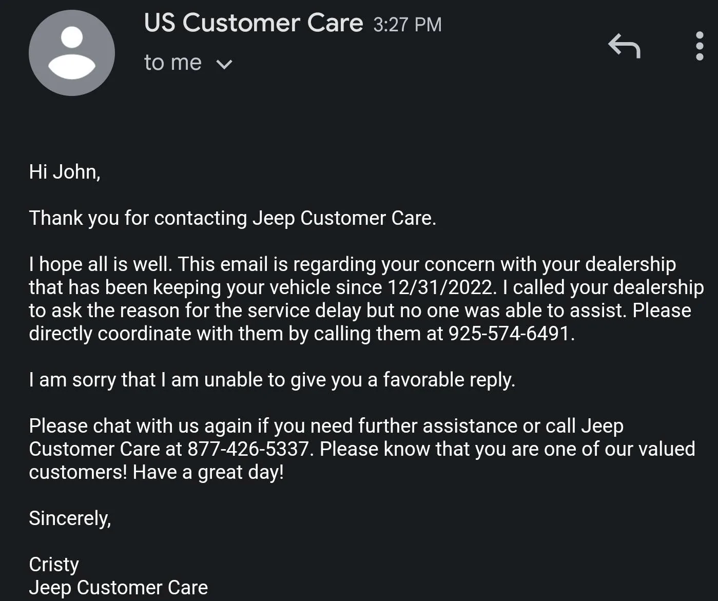

Apparently, Jeep Cares tried to contact to the dealer today and even they weren't able to get ahold of anyone at the dealer.... The service manager told me he should have an update by today but haven't gotten a call yet and they close in an hour. So we will see.
