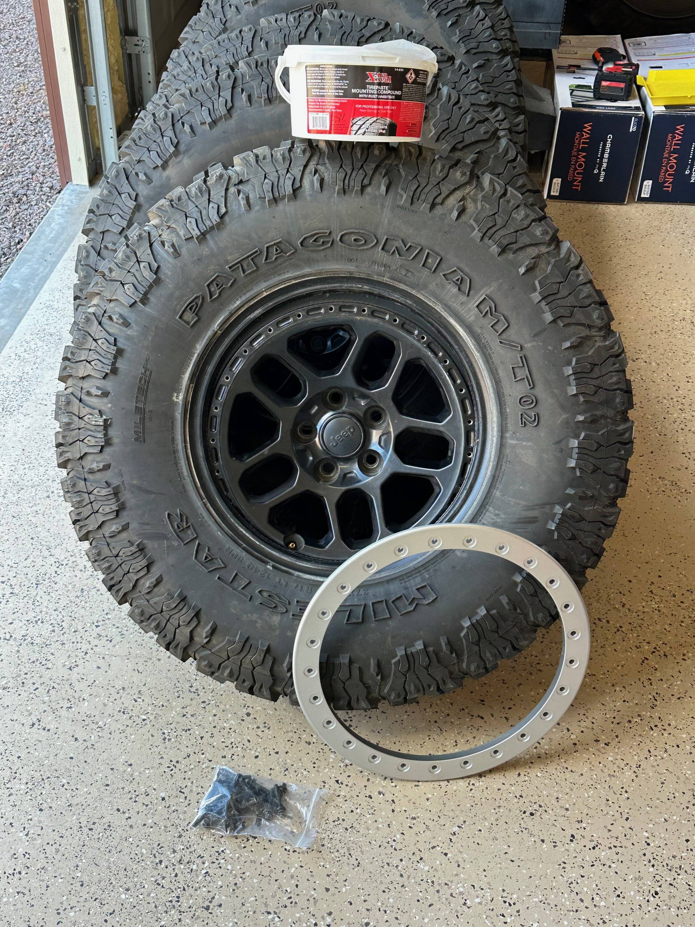

Quick update to this...on Friday I took my five tires and wheels to my local Discount tire. I removed the trim ring from my bead lock capable wheel and asked Discount to break the front bead and flip it over the lip of the wheel so I could mount the bead lock ring to the wheel. I know they can't mount the bead lock ring but they have been good about doing this for me as they did the same for my Raptor wheels. Took the wheels home and installed the bead lock rings. DT didn't charge me because I bought the tires from them, but I tipped the workers that did the work.
