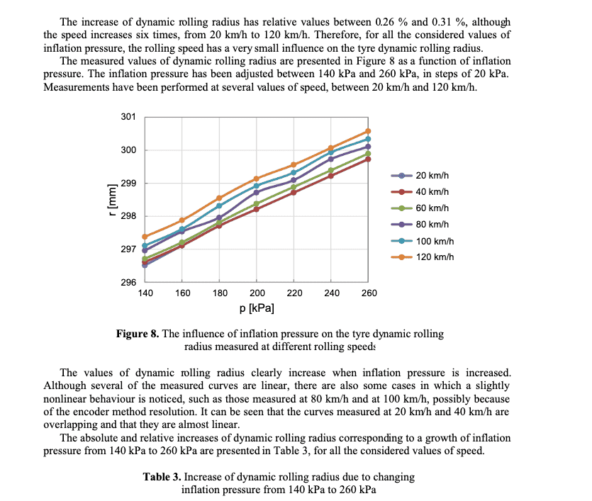

Just make sure to lower the pressure on the opposite side to try and lower the tire an inch to make the axle think there's a 33 on it.
Lowering pressure does not alter the diameter. The larger tire with lowered presssure still rotates fewer times than the smaller spare. This does nothing to mitigate different tire diameters. Height isn’t the issue.

Seriously?
The radius variation is <5mm (1/5") when going from 20PSI (140kPa) to 38PSI (260kPa)!
The radius change due to speed from ~12mph to ~75mph is nearly as great.
You're splitting hairs, here.
The diameter of the tire will change an insignificant amount (~3%) with pressure change.
