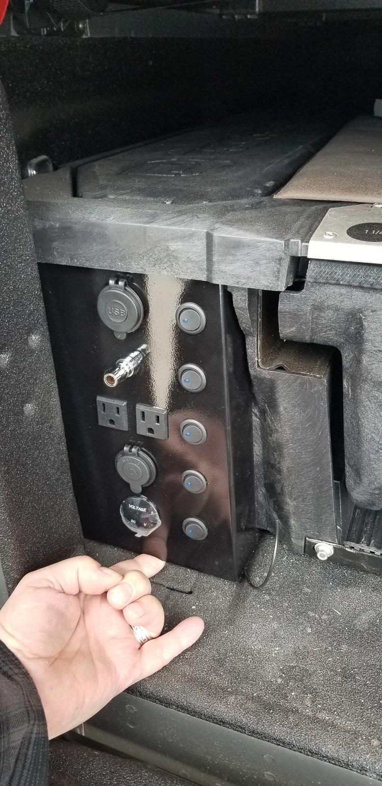

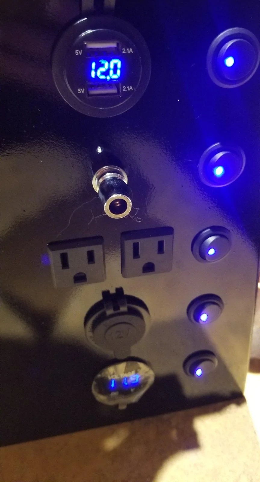

I have the Decked system in mine. I and almost fine with this prototype. Features onboard air, dual USB charging, 12v port, 120v 3000w inverter, bed lights in RGB, and voltmeter.
You gotta tell us more about this! Is there a second battery stuffed in there as well? And 3000W is huge... I'm guessing you'll only use it while the engine is running?

Not finished yet. I made a cage for that huge smittybilt 2781 compressor. Found a high and dry spot under the cab, mounted it there with its own skid plate and rubber isolated. Still need to figure out how to get the air hose into the bed. Yes the inverter will only run high powered items when engine running. This is my second install using this 3000w inverter. Worked beautifully in my 15 Wrangler. I will lose zero storage space with this set up

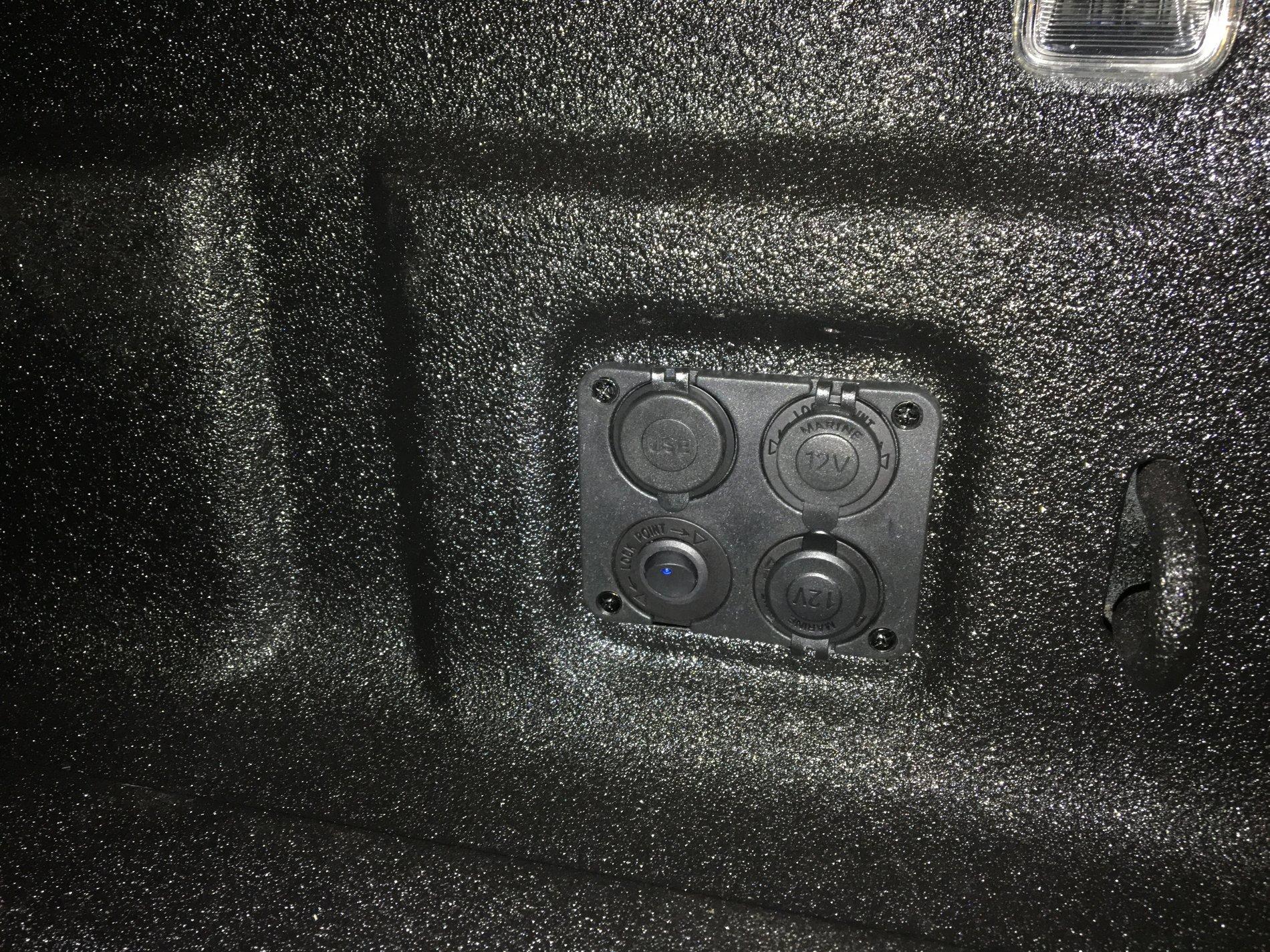

Almost finished it up! Got the panel installed and the wires ran to the front. Just need to figure out which aux switch I want to connect it to. Here’s a pic of it installed. Turned out nice.
Looks great! Did you have to cut the body to make this fit? Seems like the panel is larger than the knockout.
The actual hole on the body is 2 1/4 inches, the plastic cap measures 3 1/2 inches with a flange. The depression in the body measures about 4 1/4 square. I'm planning on having to some cutting or grinding of the bedside to fit the panel in.

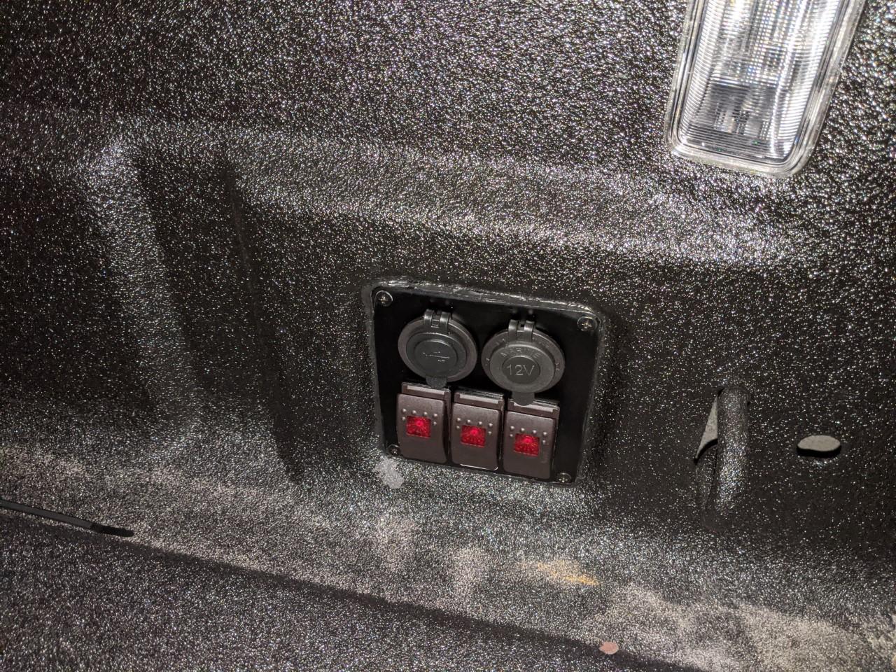

So many different fixture combos to chose from on Amazon. I went with this one just to have three extra LED light switches for side lights and whatever on my rack. Used one of the 40a AUX switch wires to this panel on 10GA wire. Might be a bit much, but I can always change it up under the hood if I really need two 40a switches for other things.

I like, was the cover hard to take off with the sprayed in liner?
Yep, that stuff is thick. Had to go around it three or four times with a sharp razor, but once it's cut through, it comes out easy enough. Had to cut the hole bigger than it is once you get cap out. Used a Dremel with a mini cutting disc, used about three disks.
