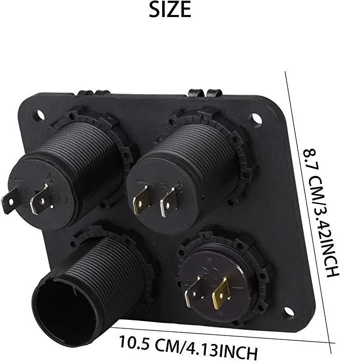

So you have to be running the jeep to use this? I want to do a mod to supply constant power to the bed for a fridge
I believe under the hood in the group of the aux wire hook ups there is a accessory and a direct to battery hook up. I will see if I can find the thread it was in and post a link later

For my my use, at $15 each I'd get a second one for parts, so I could replace the switch with another DC socket, then wire the whole thing to an Aux switch inside the vehicle so that passerbys can't flip it on and drain my battery when I'm not around. Love, love, love the concept, though. Great find!
Under the hood, next to the battery, are the four AUX connections. There's a duplicate set, with the accessory and battery feeds, under the dash on the passenger side.
And you can choose to have them always hot?
The battery feed under the dash is always hot. The accessory feed is controlled by the ignition. The switches for the AUX feeds are supposed to be able to be set to be hot or ignition controlled.

This is a great find! I’m keeping this on my short list once I get my canopy and drawers.
This is a picture of the back from Amazon..
Fyi: amazon has some that have all of the jumpers on the back pre-wired and they are only like $1 more.

I definitely want to do this. Does some have a parts list to direct wire this to the battery? I see 10 gauge wire, the actual panel. What kind of fuse do we need to go between? I was also going to add an aux switch for safety in the cab or under hood somewhere.
