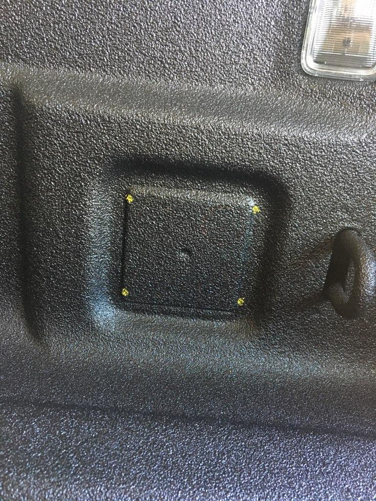

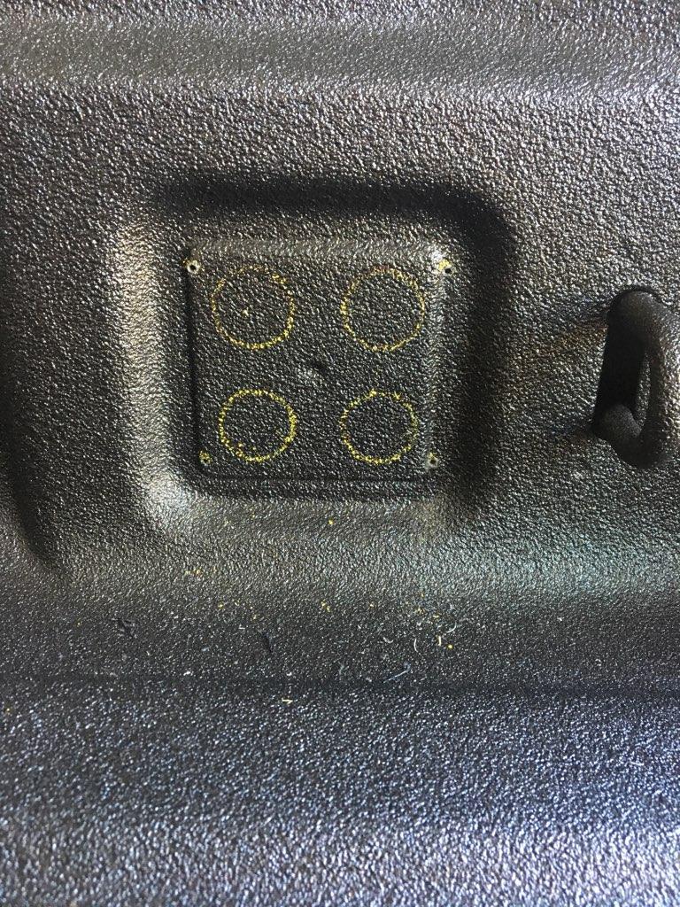

I have started on it but not finished yet. Here's a couple of pics of when I was getting ready for drilling the holes.
I started with a pilot hole, then used a reamer. There is some metal behind the cover that I ran into (didn't realize there would be metal there) and caused the reamer to start drifting off center, so I stopped. I'll need to use my reciprocating saw to cut the 4 holes out with so I can keep the panel as centered as possible. Just haven't got around to that part yet lol
Hootbro
Apr 13, 2019
6,424
10,683
2022 Gladiator Rubicon
I would utility knife cut the edge around the cover plug and pull it out. I think you are making the job harder than it needs to be removing partial material and leaving the plug in place.
sarguy1941
Aug 20, 2019
529
332
USA
Jeep
Agree. Thats just a snap in plastic cover. Cut with a razor blade around and pop it off. The new panel would probably set right in nice and tight that way and if you ever want to remove just pop the cover back on.
mikesjt
mikesjt
May 26, 2019
176
289
Dallas TX
99 Wrangler TJ Sport
I thought about doing that but was nervous about cutting it out and not looking clean. That was also before I realized there was metal behind part of the cover where I'm needing to punch the holes for the outlets lol. At this point, I'll try that. Hopefully the bedliner will cut easily. :like:
