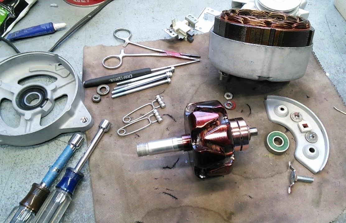

Below - 1970 Motorola: Front and rear bearings are sealed, both sides. Granted water could be forced in, but unless under pressure, they are sealed quite well.
The rotor is the field. Water will ground out the field and it would stop charging while wet, however, the water won't conduct as well as copper windings so it should not "ground" or "short" to the point of damage.
The stator consists of copper windings. I've had them in mild solvents to clean them - no damage. They are connected to sealed diodes. I can't see water doing damage those, either.

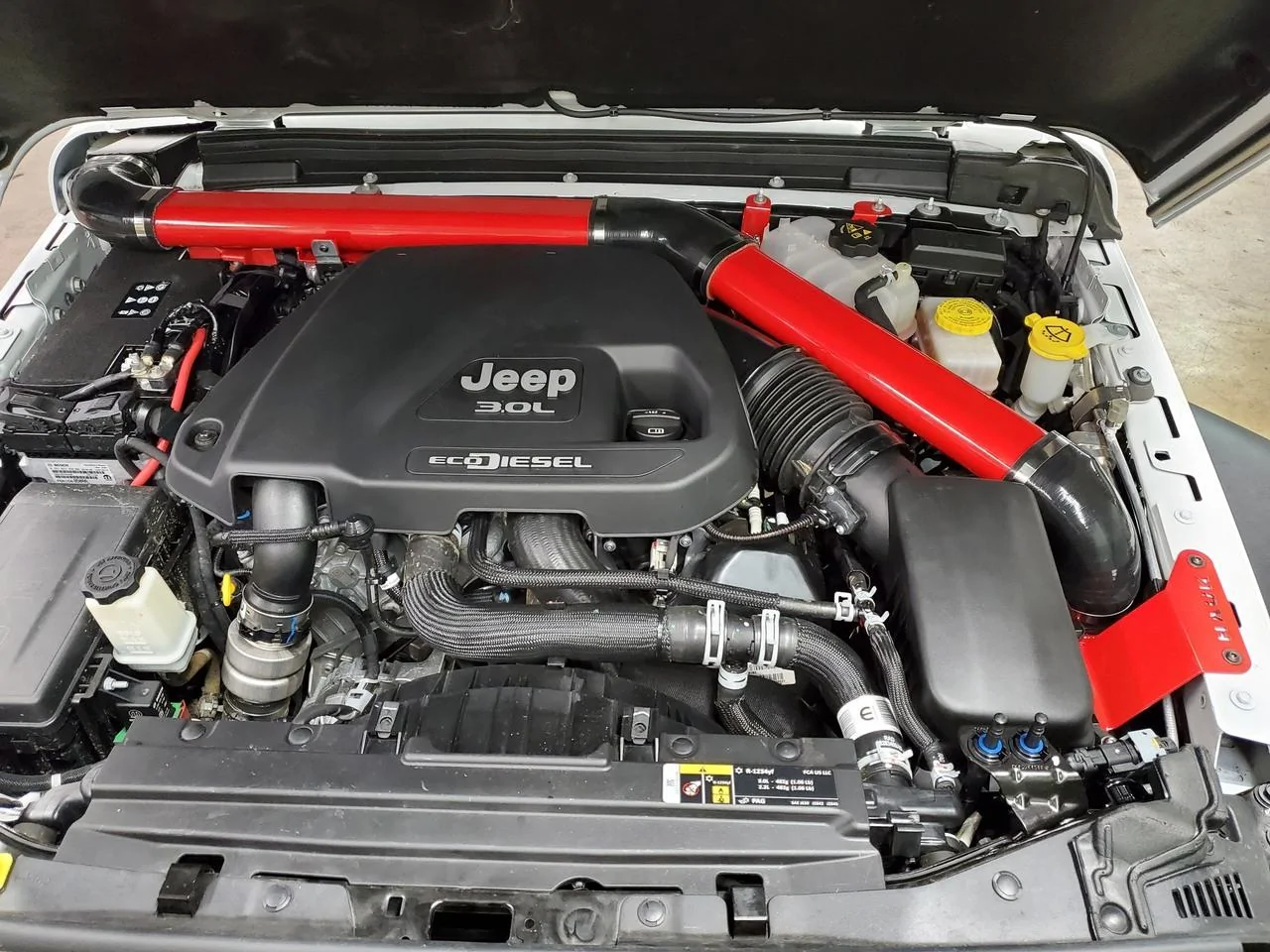

Too much piping under the hood. Looking at heat soak. Then you have to buy the extension. And that is in the wrong location.
I see. Looks like they put it in the same location as on the 3.6.

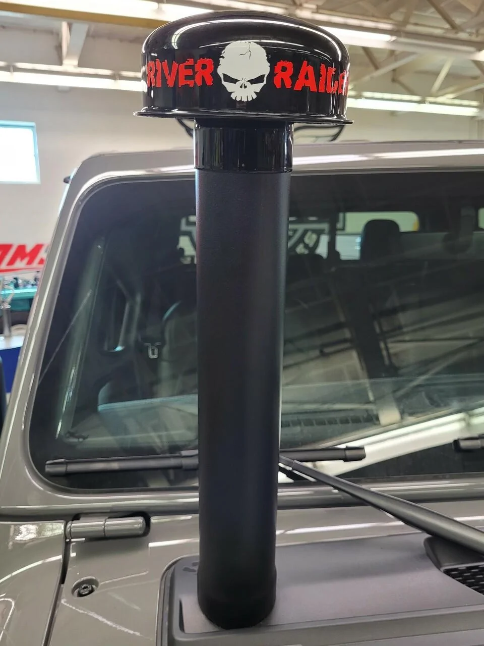

Plus I didn't think it will pass Pa. inspection. Blocked vision.
By the time it gets to the front it's hot air again. Pretty sad, IMO.
I didn't even think about that. I've been considering their low mount intake on my 3.6. Now I'll have to take a second look at that one. Because even that one is partially blocking vision. Nothing like a fix it ticket after you spent hundreds-thousands on mods. I see you picked up your gladiator today. How are you liking it so far? Love at first sight?
Yep. The IAT will be high at low speeds. Lot of heat soak in all of that piping under the hood.
