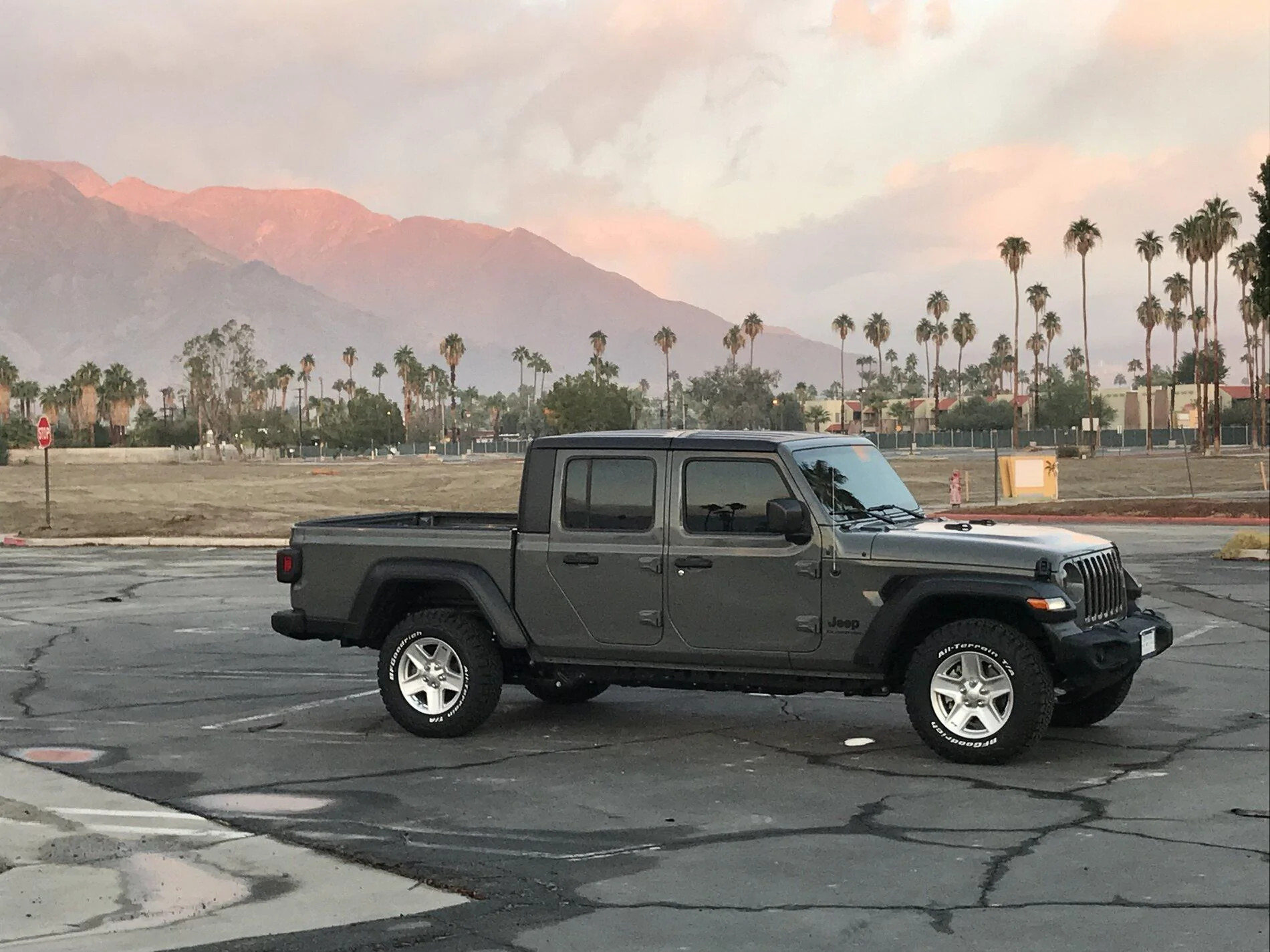

Not sure if you already made your decision but here’s mine on KO2. No complaints, issues but I regret not going all the way to 285.
BTW, I like to look of white letters out....
Jeep Gladiator Does any buddy run 265’s on their stock sport wheels? B8F34526-571C-422F-B88F-FA9F82C7D6BC

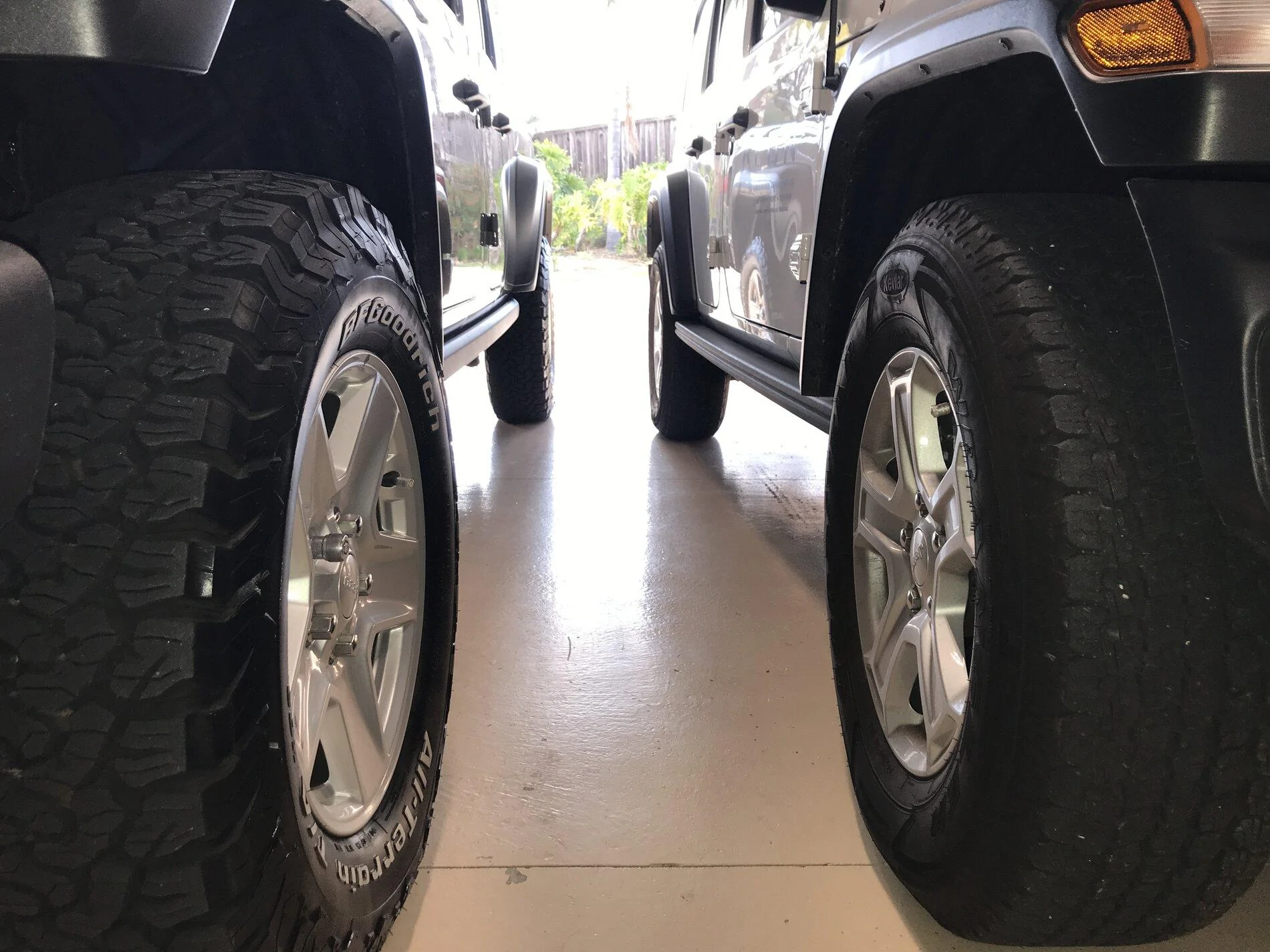

my 265/70 are close to 2” taller than my wife’s jl running on the stock 245/75. And yes wider. I wonder if the diameter is because they are ATs.
Jeep Gladiator Does any buddy run 265’s on their stock sport wheels? B86677CB-4B95-4F50-BBF6-D5F85323935F
