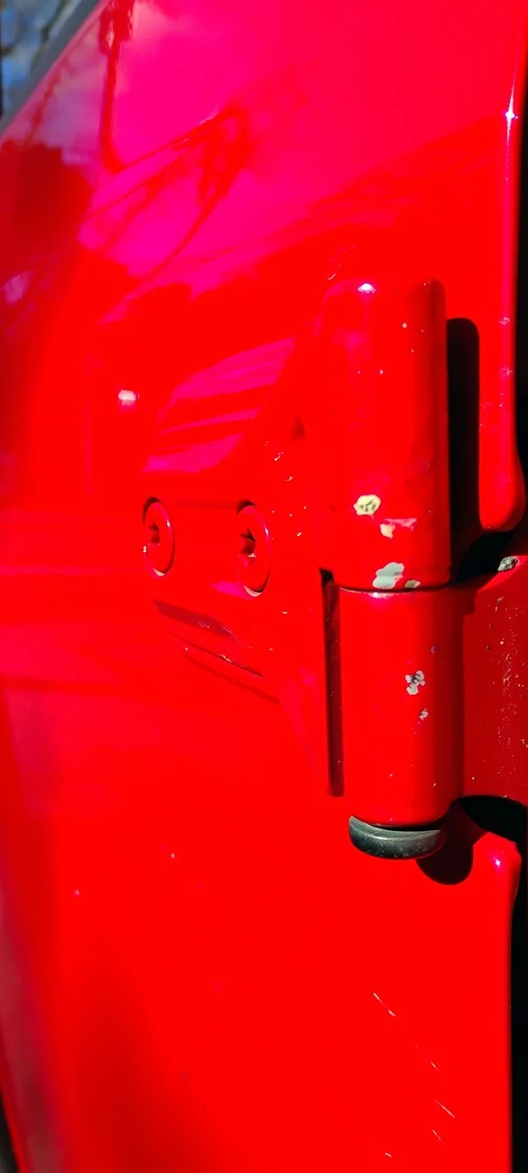

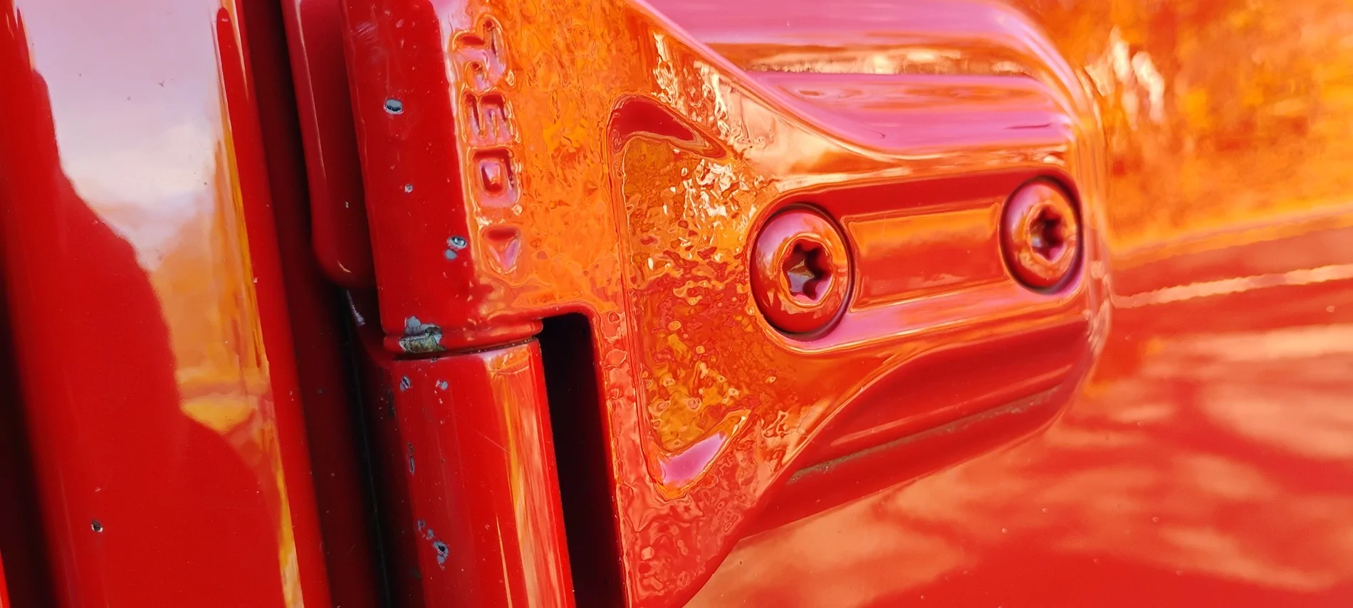

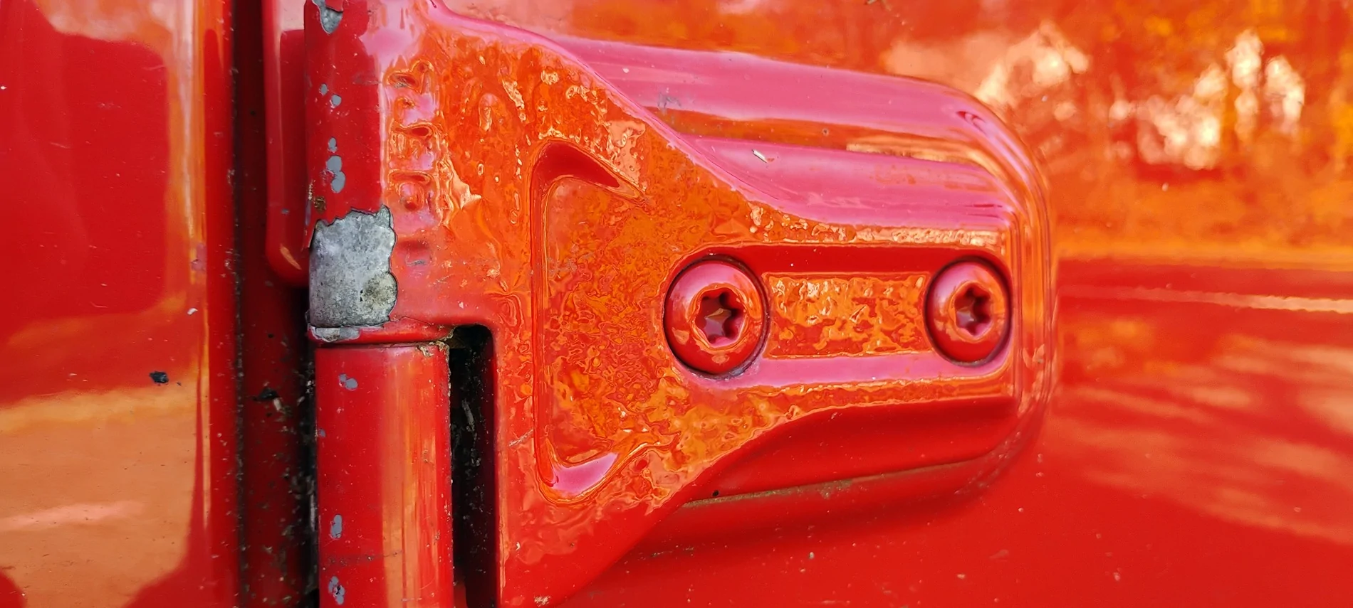

Does anyone have experience with Corrosion,if so how can I fix it

Last June, I noticed my door hinges were bubbling and I brought it into a CDJR dealership. Their warranty guy did an inspection and also found bubbling on the hood. Under warranty, they ordered all 4 new doors and a new hood, and painted them at the body shop (along with new "Rubicon" decals and hood vents). Took about 3 weeks for parts to come in and had the work done in a week, they also gave a rental car for free. The paint corrosion warranty is only good for 5 years from when the truck was sold brand new. I would first check with your local CDJR dealership warranty department, they can tell you the exact dates based on your vin. If yours is a 2020 model year, it's likely past the warranty end date.

My only question is that paint peeling or stone chips?
I'd say a little bit of both.
If a dealer tries to deny warranty coverage cause of those stone chips, I'd argue the bubbling on the face of the hinges is far enough away that it wasn't caused by the stone chips.

I just couldn’t tell in the pics and it’s always been a common place on jeeps to get beat up with stone chips.

I'd suggest perhaps paint coming off due to lack of adhesion due to corrosion. Look at the color of those parts under the paint (well, YOU probably already have)
