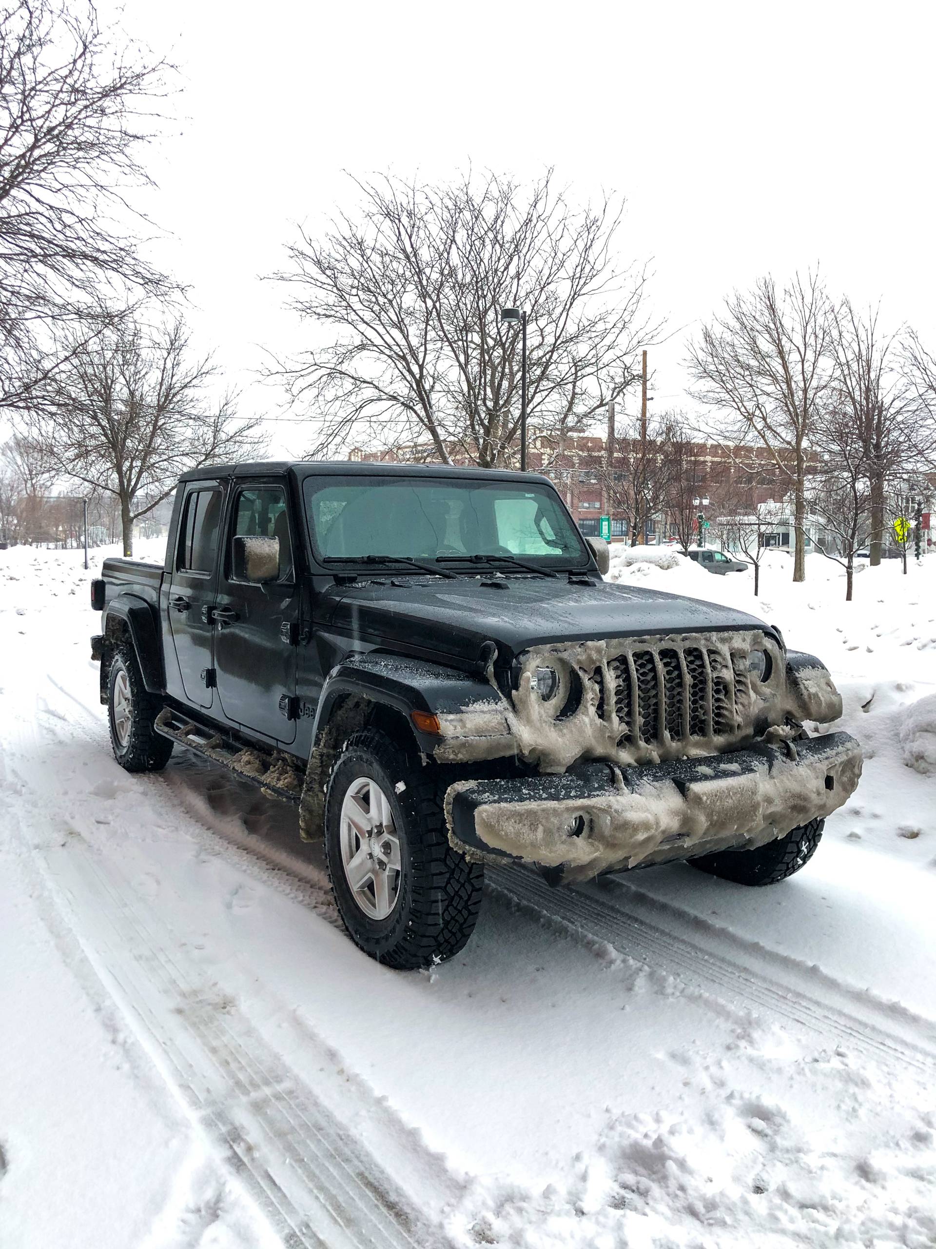

180
29,558
35,156

Like everyone has said - no.
LEDs themselves don't get hot - none do. The supporting electronics do, but those are in the back.
Since noting glows in an LED, it's not a resistance through which a current is passed to generate a glow via the hot wire inside, there's no heat up front.

The led headlights on the wife’s SQ5 and my P4S have some kind of heat source and will keep the snow from accumulating. The Glad: nope, nada, zip, nothing. That is kind of ironic because Glad was supposed to be my winter alternative transportation.

Part of the issue is that they are shaped like a funnel - snow can't slide off and out easily. Other lights are more "formed" and external, sloped so snow isn't caught like shrimp in a net.

And it also looks the the airflow goes through into the inner area under the hood. Probably working on the notion that any reduction in air pressure is positive. Driving in snow and icing headlights was one of the things that initially held back the implementation of led technology in the trucking industry.
