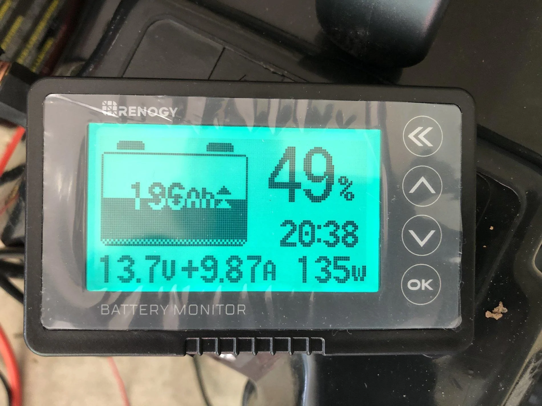

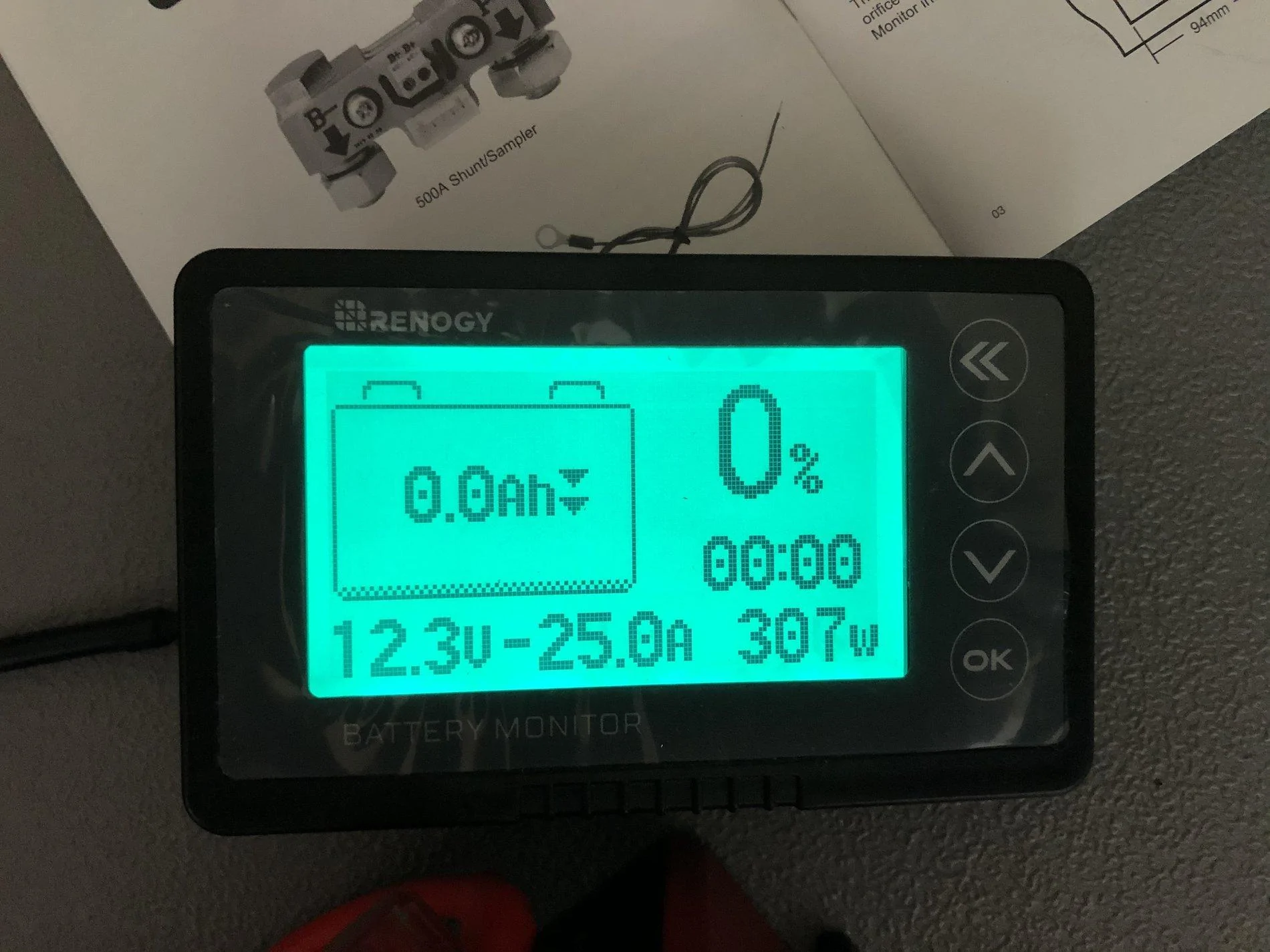

Ok like I said last night I go tired of waiting so this morning I hooked up my 400W inverter and plugged my wife’s hairdryer into the inverter, converted both coolers to AC power and plugged them into the second inverter port and turned the hairdryer on high without heat. It was drawing about 18 amps when the compressors were not running and 25 amps when both compressors were running. The system ran in this setup for another hour and 55 minutes before the low voltage alarm on the inverter started beeping.
Then I plugged up the charger to see exactly how many Ah it takes to fully charge the batteries.
Attached photos are the load and the charge respectively. The first one shows the bank at 0% even though the batteries still had about 40Ah left in them since I had not calibrated the monitor yet and the second is after about 2-3 minutes of charging.
Once they are fully charged I will pull them out of the boxes and post high quality photos of the batteries themselves. Right now I would have to dismantle the system to get them out of the trolling motor boxes.

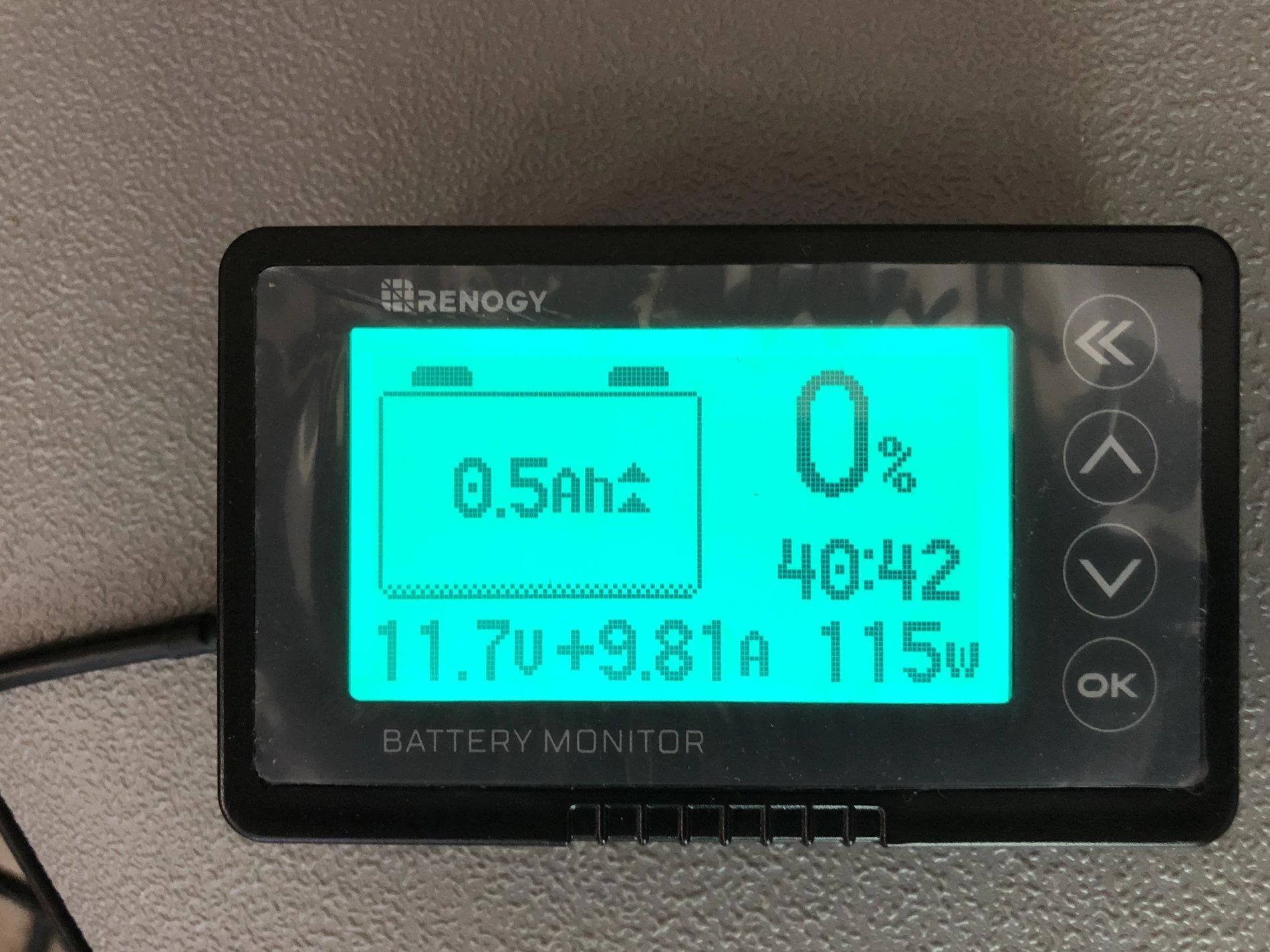

The skeptic in me wants to think that my test was actually flawed. My only explanation can be the cooler than average temperatures we have been having. All of that changes today with temps running in the mid to upper 80s for the next several days. Once the batteries reach 100% state of charge I will rerun the test with just the Dometic CFX95DZW and see how the batteries perform under closer to normal summertime conditions. As of this morning after about 20 hours on my 10 amp NOCO Genius Charger the battery monitor says they are at 196 Ah of energy. The charger is still indicating that it is in absorption phase so they are not at 100% yet. They should be done when I get home this afternoon and I will restart the test. The attached pic was from about 8:15 this morning at around 19 hours on the charger. It shows 49% capacity because I have the monitor set to 400Ah so it will not reach 100% and stop counting.

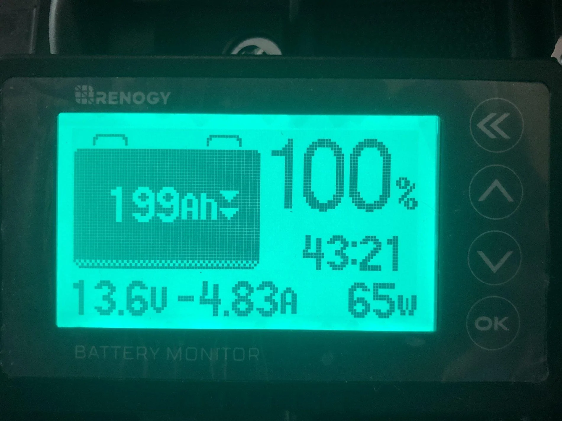

Got home from work and the charger had turned off and the meter showed 204Ah. I got excited and set the meter to 200 Ah as a full charge before I took the picture.
For the test I am running the small side of the CFX95DZW at -8 like it would be for a camping trip with frozen food and the big side of the cooler is at 35. There are drinks in there so I open it a few times a day. I didn’t take the time to let it cool to -8 while on AC power but it shouldn’t cost us too much power since that side is smaller. There are about 10 water bottles in there that it will have to cool down and freeze. So basically I went from going too easy on them to maybe a little too hard on them.
