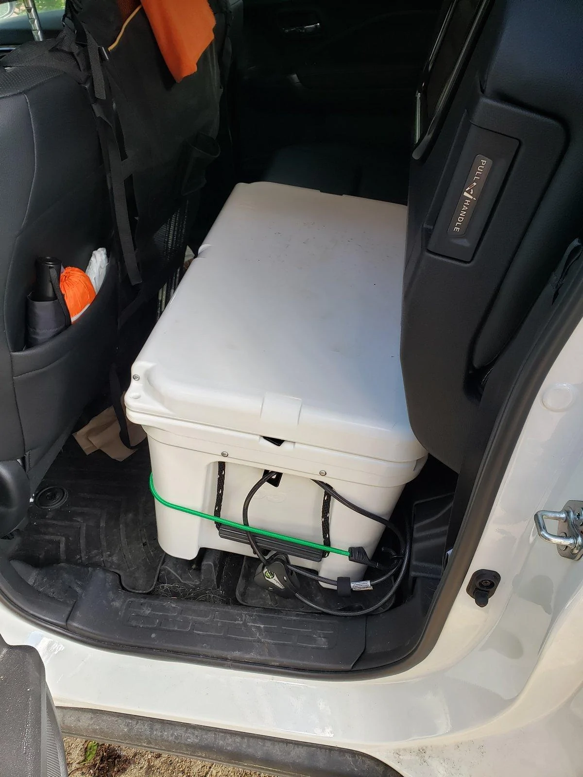

Yeti Cooler with ice, does the trick for me, wont last a week but a few days no problem.
A Yeti 65 should fit in the back with the seat flipped up. The JT has a couple more inches of leg room than my Ridgeline.
but my kid will be sitting there, lol.
