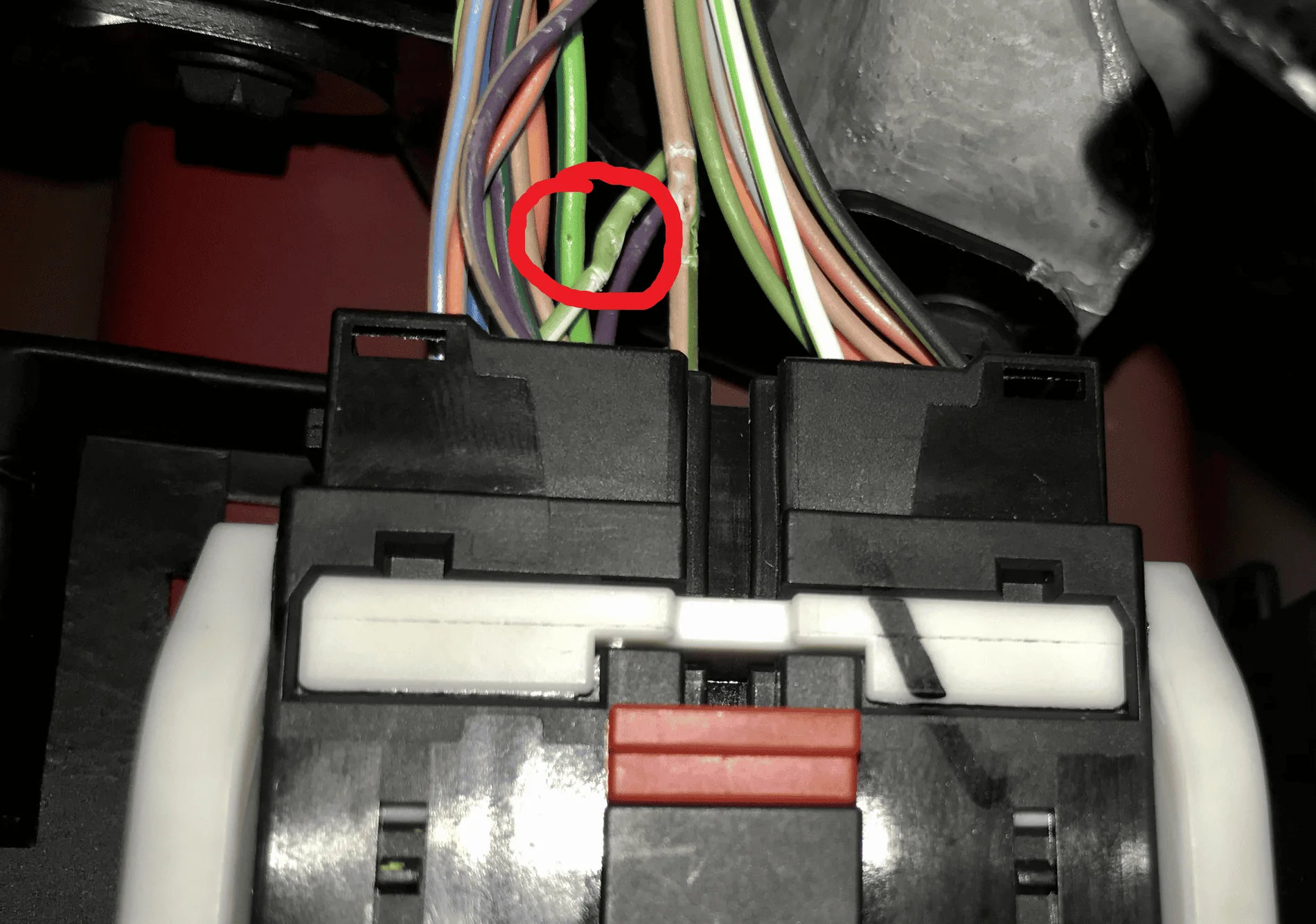

So I start taking out everything I put in and come to find that somehow when I used my posi-top to tap the Green/Dark Green wire at the body side of the door wire harness, a Green/White Stripe wire got caught in it as well and the two wires had been shorted together.
Tracing those out with wiring diagrams I found that the Green/Dark Green stripe wire is the Door Lock Control wire and the Green/White Stripe wire is for the Proximity Door lock system. I thought I found the problem and separated the wires but no, problem was still there.
Tracing these out more I found:
  1. Wires at the door connector XY600A that I crossed (The door to body connector we disconnect to take the doors off)
    1. Green/Dark Green Stripe wire is for the door lock control, and goes through connector XY600A at pin 26 and ends up at the Body Control Module (BCM) Connector C6 pin 2.
    2. Green/White Stripe wire is for the Left Front Passive Entry Switch Return and goes through the connect XY600A at pin 15 and goes into the Radio Frequency Hub Module Connector C2 pin 14.
  2. Connection from each of those Modules to the CAN-C-BODY STAR connectors
    1. The BCM connects from it's connector C5 pins 25 and 26 (Brown and Yellow wires) to to the CAN-C-BODY STAR connector behind the glove box at Connector C2 pins 1 and 2
    2. The Radio Frequency Hub module connects from it's connector C1 pins 3 and 9 (Dark Blue and Yellow wires) to the CAN-C-BODY STAR connector at connector C4 pins 1 and 2
  3. Star Connector CAN-C-Body Connector C1 has Beige/White and Yellow wire that goes to Star Connector C-IP Connector 1
  4. Star Connector CAN-C-IP Connector C5 has Beige/White and Yellow wire that goes to PCM Connector C1 Pin 57 and 33

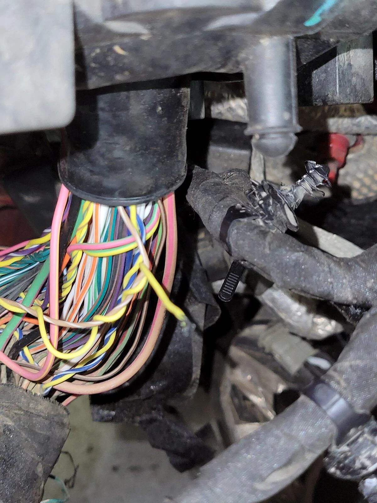

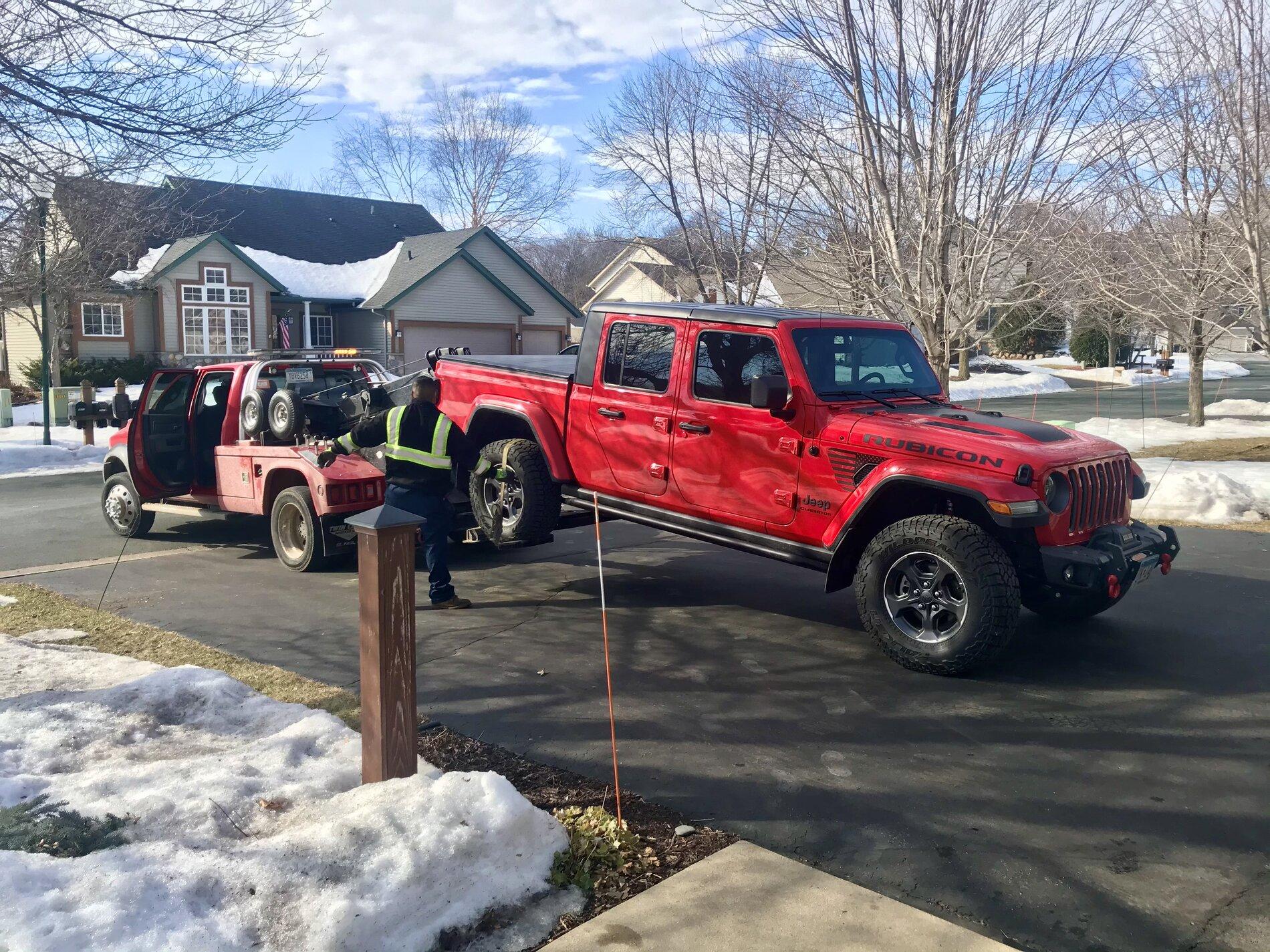

Ultimately, the next day I had my truck towed to the dealer... sad day. I told them what I did, I know electrical issues are a pain in the ass so I wasn't about to try to play dumb. Obviously, this would not be a warranty repair...

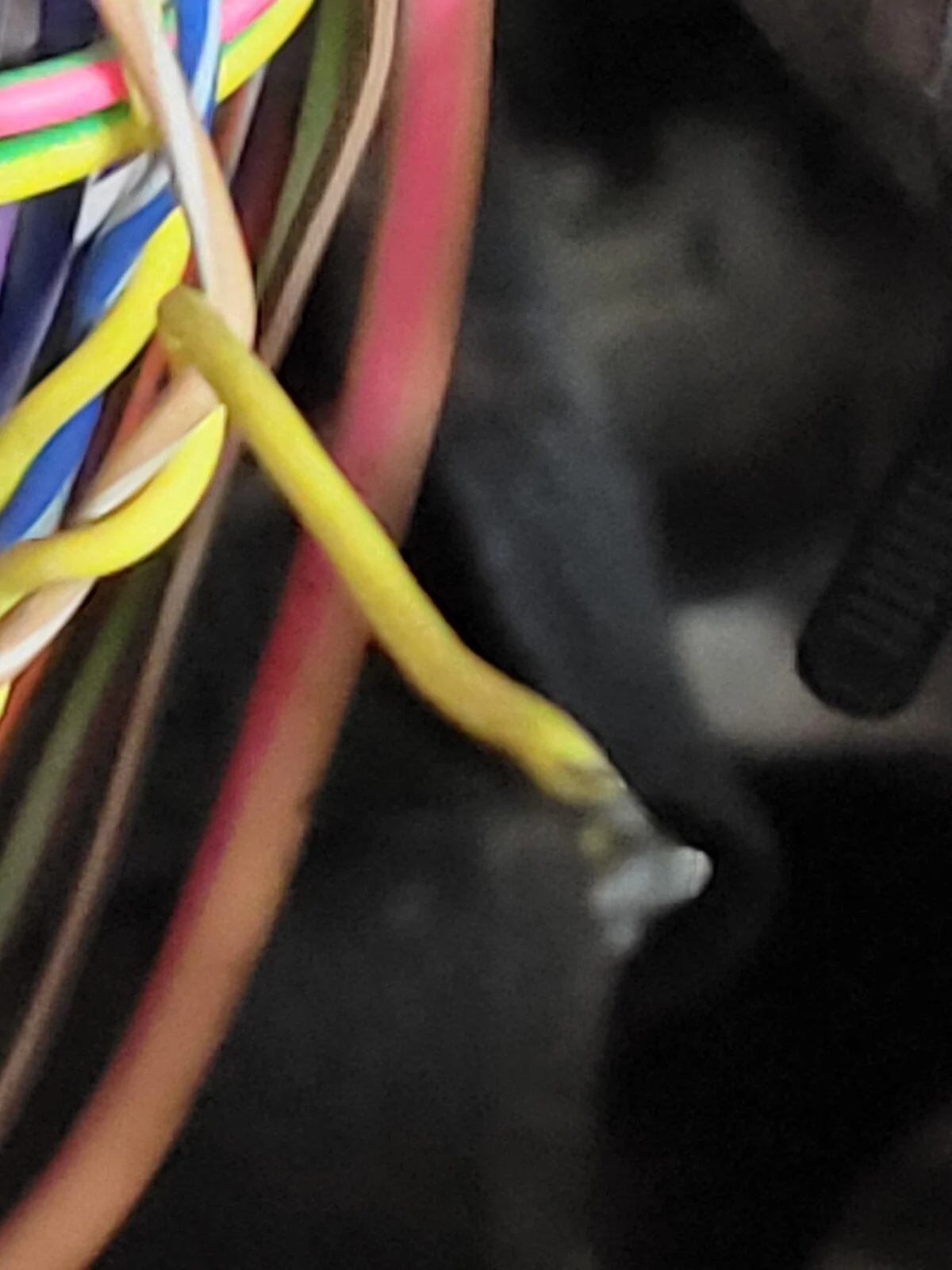

After many hours of diagnostics and wire tracing they found that the yellow wire that goes from the CAN-C-IP STAR connector behind the glove box to the PCM (#4 in the above list) had fried. Basically the wire looked like it 'popped'. It was split with the insulation pulled back on each side. This explains the litany of warning messages in the dash as this is the only connection from the two STAR connectors to the PCM. I had them repair the wire and the Gladiator is now back to it's normal happy self.

The two wires I crossed:
Jeep Gladiator Don't cross your door wires.... IMG_5695_1
Up on the hook:
Jeep Gladiator Don't cross your door wires.... IMG_5671
The fried wire is in a large bundle of wires that goes through the firewall on the passenger side and connects to the PCM in the passenger inner fender. These pictures are from the dealer and unfortunately aren't the best. The focus of the camera was on the wire bundle instead of the bad wire but you can kind of make out that the insulation is gone and the wire is exposed. The wire was broke basically inside the grommet part:
Jeep Gladiator Don't cross your door wires.... 20210309_123055
Jeep Gladiator Don't cross your door wires.... 20210309_123104

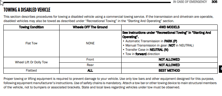

Always flatbed, per manual and possibly warranty if it messes something up. And definitely NEVER 2 wheels up.
Also, I am not installing my up/down feature if anyone wants to buy it. Impulse buy, not interested in it.
Yeah, I thought I remembered something like that: The tow was through Jeep roadside assistance so they should really know better. FWIW the transmission was in park override via the pull loop in front of the shifter and the transfer case was in neutral so nothing was really spinning that shouldn’t be.
But yes, it should have been flat beded.
