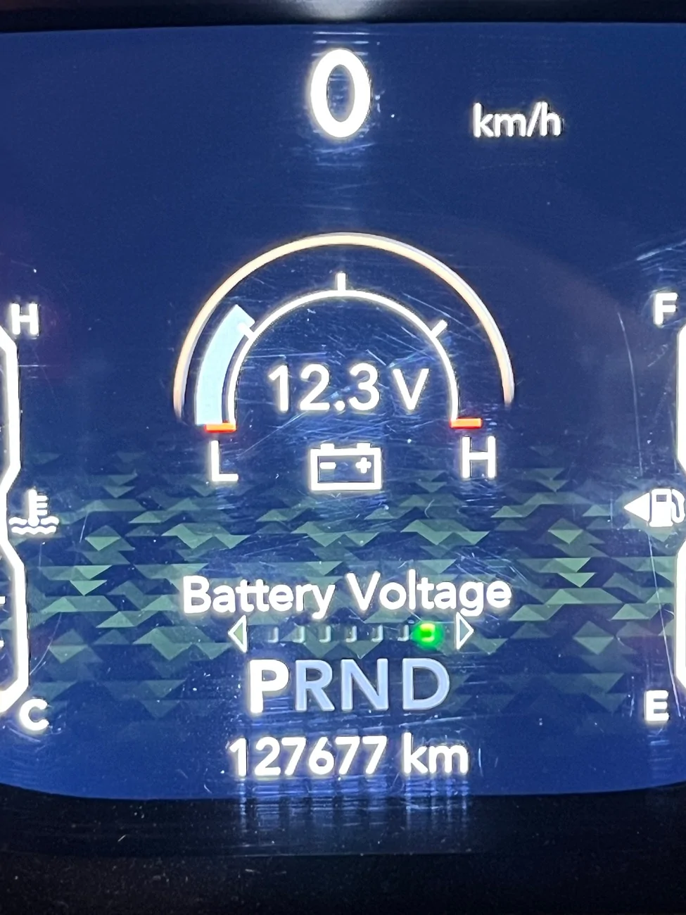

UPDATE this morning checked the state of the main 😬
Last night, parked it and took note of the voltage sitting at 12.7v, this morning, 12.3v!

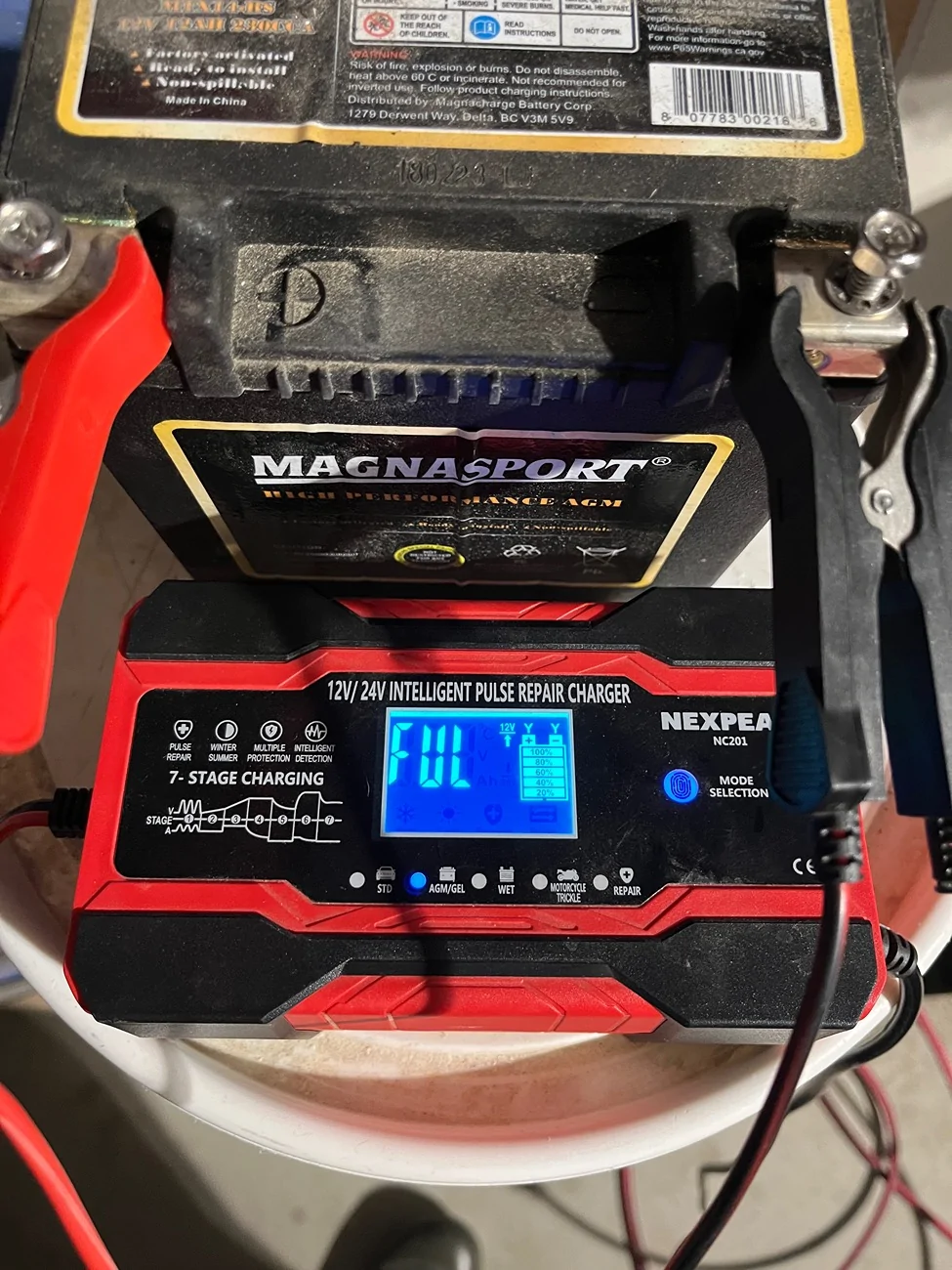

I pulled out the aux battery I had hid away in the back of the truck for just this moment I feared, to just hold it for a while. I put it on the charger and …it was full and didn’t need any charging. I tucked it away in the back of the truck again.
