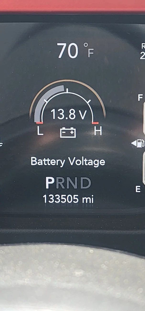

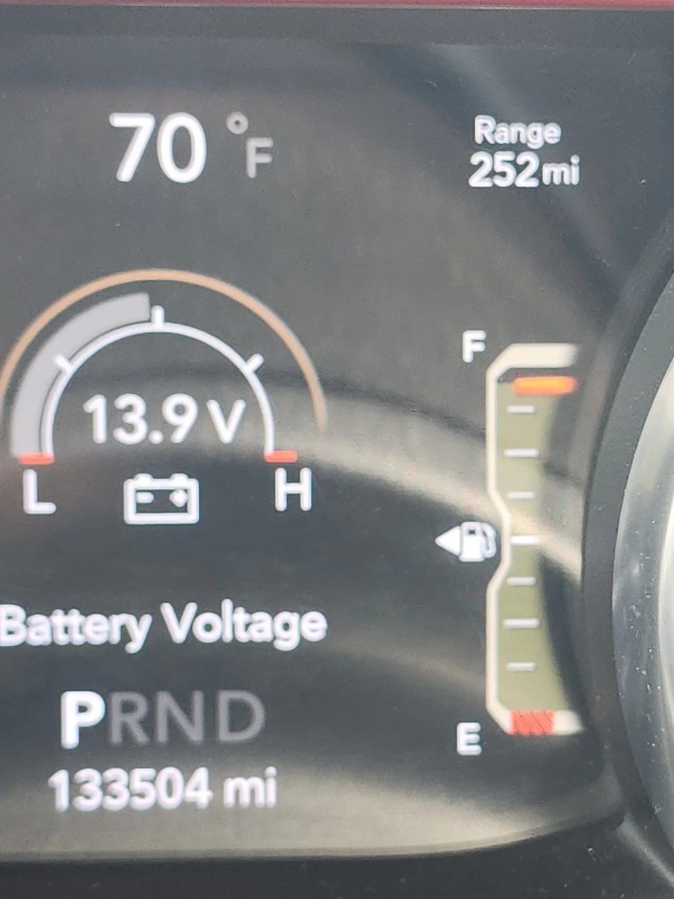

So the Saga continues , I'm at work and I noticed that voltage had dropped I had been idling for about 40 min. And seen 12.7 all the sudden the ESS symbol kicks on. I am like what the heck.. as I had just replaced lawn mower battery and main tested at 12.86. So I just happened to have a 10mm socket and ratchet and my multimeter was still in here ..
Here is the lesson. Dont just ever look at your terminals in the dark.
😂 after pulling off the negative and IBS I seen it the terminal was coated in a dull corrosion and even the IBS contacts where dull . So I thought dang !! Wonder if the positive is the same sure enough dull and corroded. I search all over jeep find a fingernail care kit and get the file out and start lightly scrapping everything . So a worker comes up and sees what I am doing . And says hey I got a wire brush . So I finished with his wire brush and put everything back together and ....yep light goes out and it starts charging at 14.0volts. It is now at 13.8 . So lessons learned .. clean your terminals and especially don't inspect them in the dark or dim evening light .
Edit added some pics.

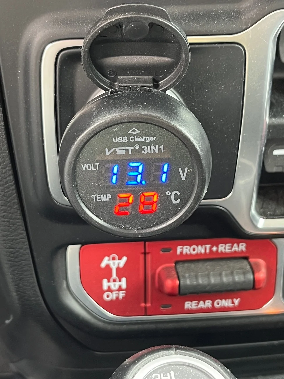

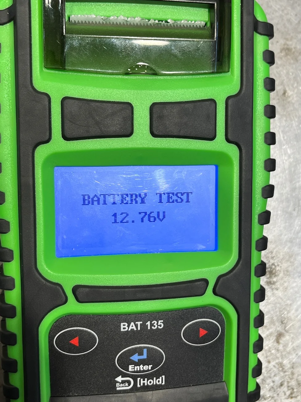

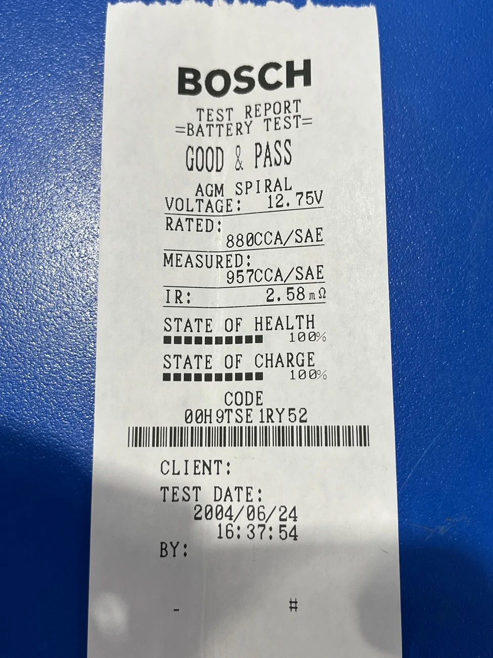

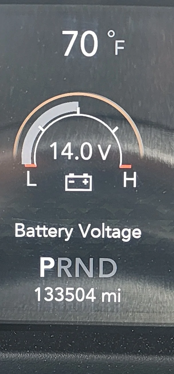

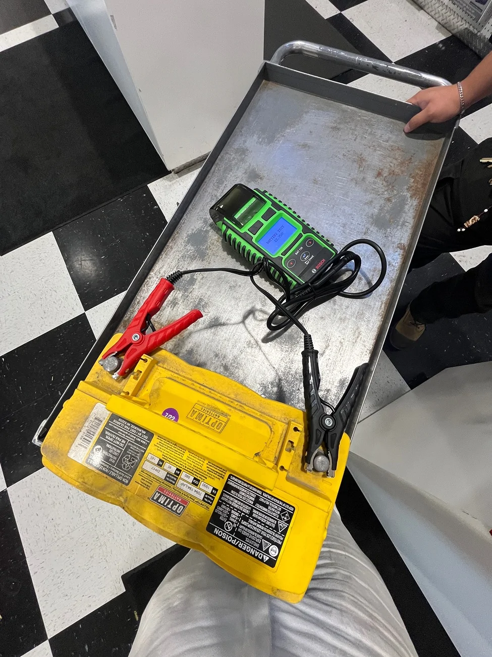

I went to Lordco to warranty exchange out the 2 year old OPTIMA battery. The whole drive there, alternator showed 14.2v, parked, shut it off and battery at 12.7….then quickly dropped to 12.3.
Talked with the parts guy and he confirmed that he’s seen several yellow tops die early and come back for exchange. I asked what if I exchange for some other “like” 94r battery, “sure! he said, that would be the AC DELCO, we hardly see problems with those, highly recommend it”. I said OK and asked him to put a trickle charger on it while I go pull my battery out.
Here’s what’s weird, I went out and pulled the Optima and brought it in. He put his BOSCH tester on it and reading came out 100% health and charge. After hearing what numbers I was seeing and the photos I took, he called his manager and he agreed with me something wasn’t right and he approved the exchange, no problems.
All the driving I did with the new battery, alternator stayed at 14.3v and now that I just got home, engine off, battery reads 13.1v.
I’m assuming the alternator is going to kick down soon??

You can’t just directly relate the voltage while running, from the alternator, to battery health. It’s not just charging when it thinks the battery needs it. It charges when more draw is detected, to protect the battery.
When the IBS decides the battery is fully charged it will drop voltage down.
If the battery was fully charged when installed and the IBS reset when it was installed, it can take a few hours for the IBS to "learn" the new battery.
Normally a drive, then sitting without a load for several hours will do it, otherwise it can take a couple of drive cycles.
I have the exact sequence needed for the IBS to relearn and things to settle around here somewhere.
