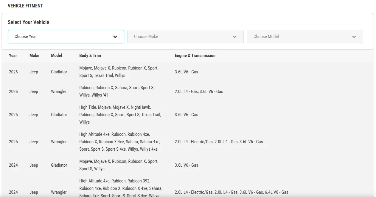

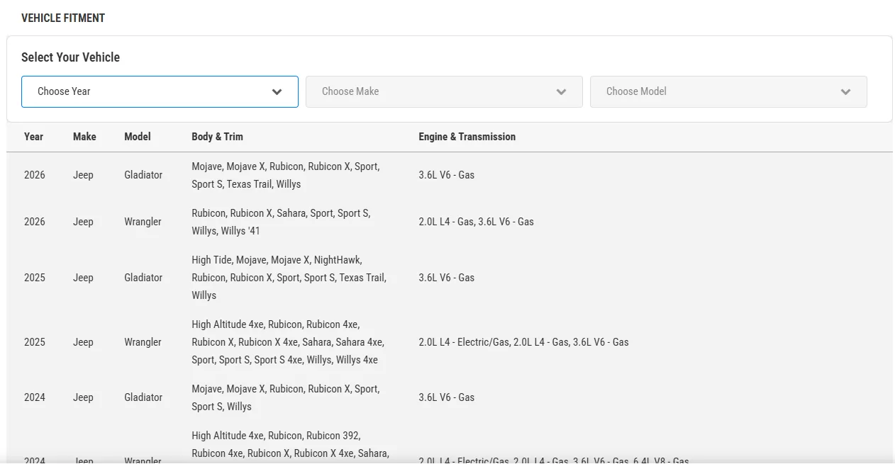

On Stellantis parts, the last two digits are the rev level.
I'd always go with the newer rev if everything else is the same.
In this case, 68522995AA is for wide track axles, which I don't believe an Overland has, so you want the other
store.mopar.com lists both wide and narrow axle models under vehicle fitment for both of those part #s. Not sure what's going on there.
68522995AA:
Jeep Gladiator Drag link replacement 68522995AB
68522992AB:
Jeep Gladiator Drag link replacement 68522992AB
