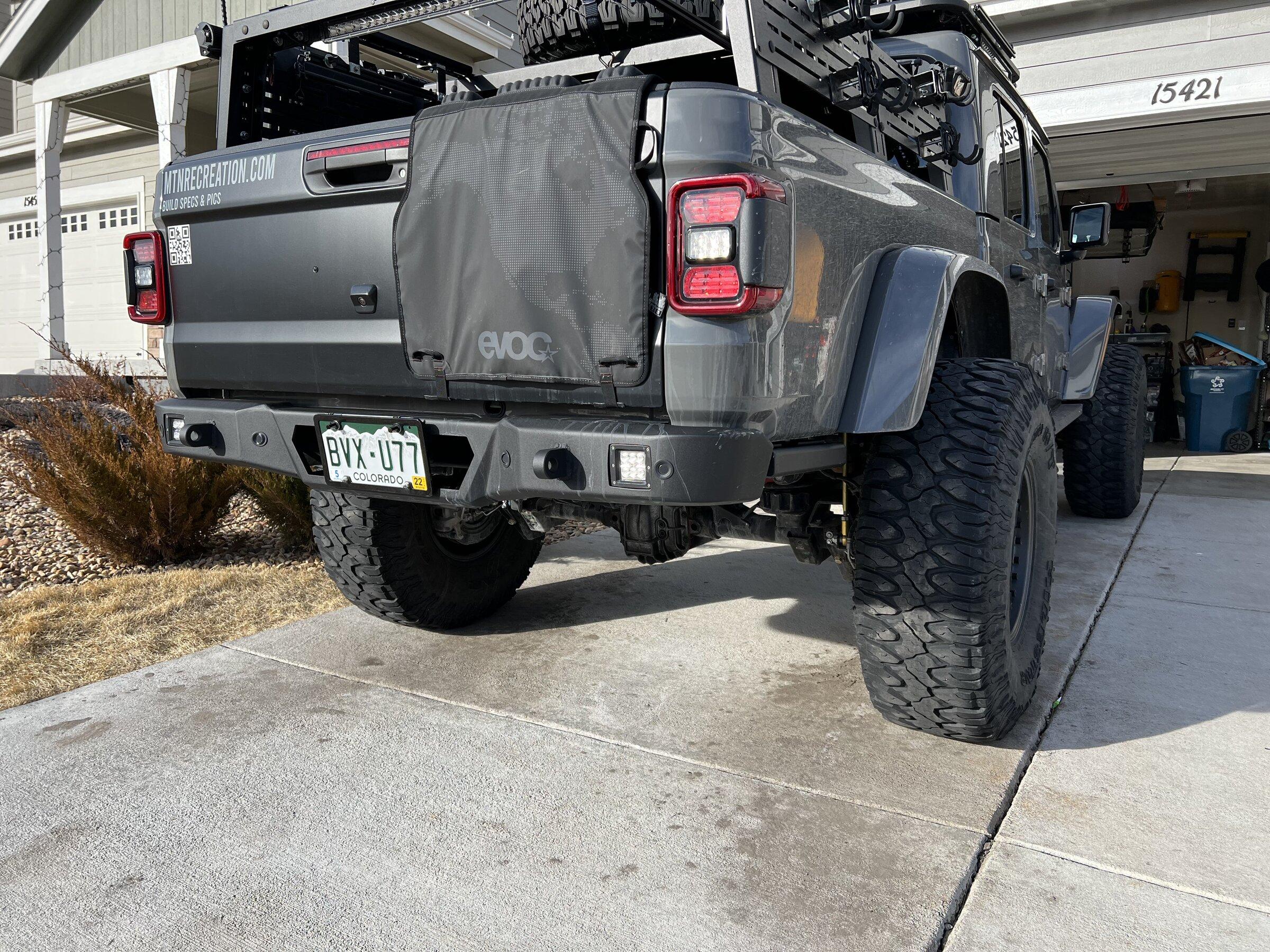

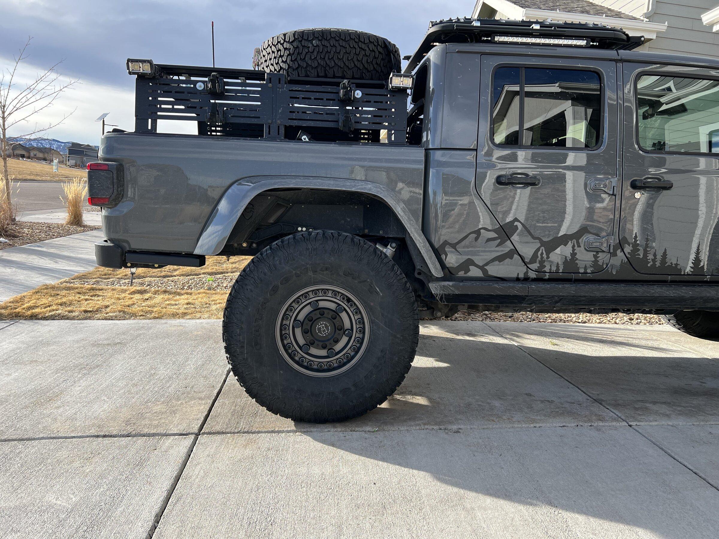

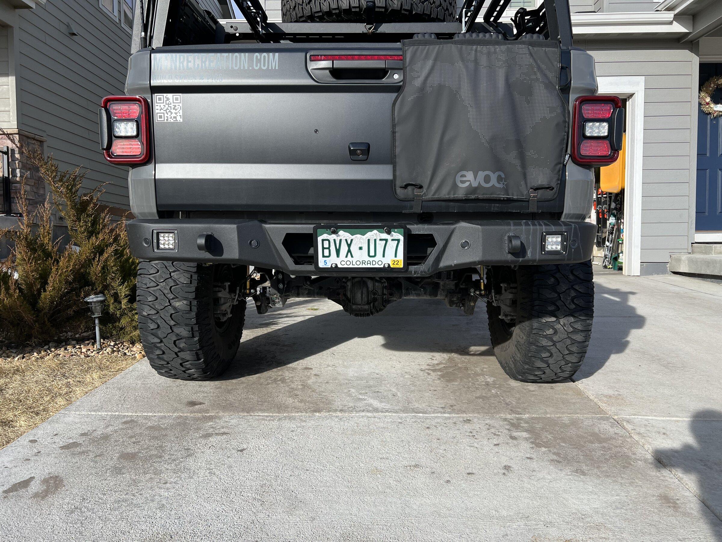

I bought this rear bumper a while back with the specific intent of modifying it and adding a custom bedside slider. Might be useful for folks considering it.
Pros
  • Loved the clearance and "tucked in" design
  • Loved the hidden hitch design (hitch itself, different story)
  • Liked that I could still fit a license plate on it
Cons
  • No recovery points
  • No sensor cut-outs
  • Bracket design could've been more robust
  • Powder coating was crappy texture
  • Included hitch was super bush league
I knew all of the above before purchasing, but wanted to give this thing a try with some considerable modifications and a new powder coat. Here's the outcome:
Jeep Gladiator DV8 new rear bumper, looks pretty promising! IMG-7676
Jeep Gladiator DV8 new rear bumper, looks pretty promising! IMG-7675
Jeep Gladiator DV8 new rear bumper, looks pretty promising! IMG-7677
Recovery points were welded in a few places and have a 1/2" bolt running through the bracket, but are reliant on the integrity of the supplied DV8 bracket. I would guess it'll hold up to moderate stress but not severe stress. This is the clevis mount I used.
Sensor cut-outs were easy, the sensors still work great, and I have no idea why DV8 wouldn't just do this for their customers.
New powder coating was still a texture but far more mild, which makes it a breeze to clean. DV8's powder coating was really difficult to clean and would've gotten gunked up.
Hitch receiver was thrown in the trash and replaced by a Curt Class 5 and custom-built set of brackets to fit over the supplied DV8 brackets. This new system is beastly. See link below for info.
Bedside slider was made from some raw steel parts. See link below for info on that.
I keep build specs and projects on a website, Mtnrecreation.com. Here is a write-up on the bumper and its modifications. Here is a post on the body cut and bedside slider.

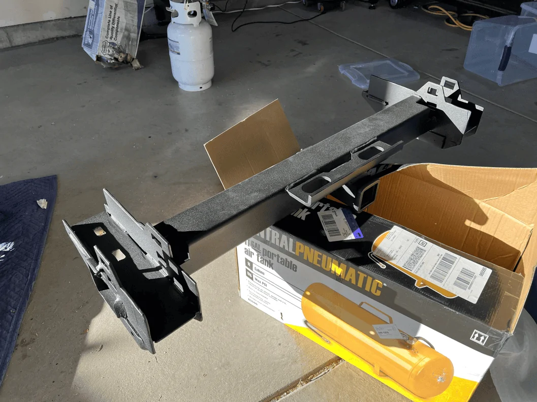

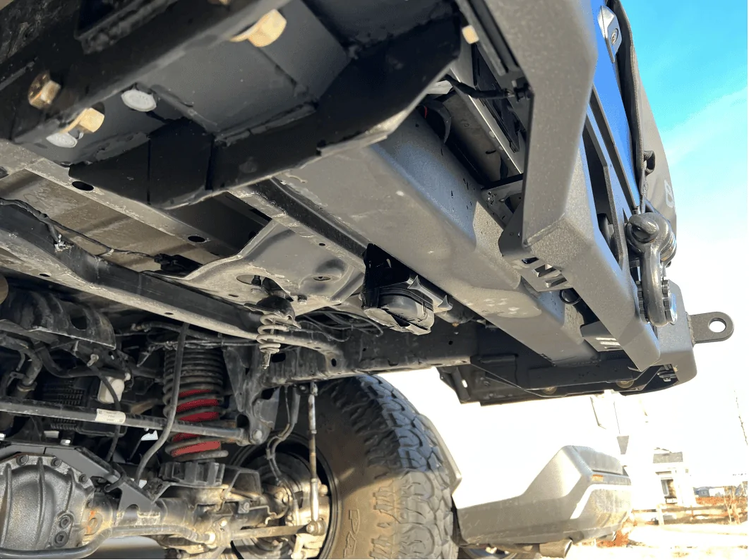

can you share a few more pictures of the receiver setup. Eventually I want to tuck mine or get a bumper with a tucked one.
I am currently modifying a cavfab front bumper to include a receiver tube, so i know the fun of getting something to work.
drewkillsit
Drew
Nov 25, 2019
JTR
Jeep Gladiator DV8 new rear bumper, looks pretty promising! receiver
Jeep Gladiator DV8 new rear bumper, looks pretty promising! underside vi
If you take a look at the DV8 brackets (check their site), you'll see that this receiver was meant to fit right over them. I welded the receiver "inside" of a steel bracket/enclosure. So, instead of just welding it to a plate, it's welded-to and running-through a plate, under the frame, and then welded-to and running-through another plate on the other side. (terrible explanation, but that's the best I can do)
