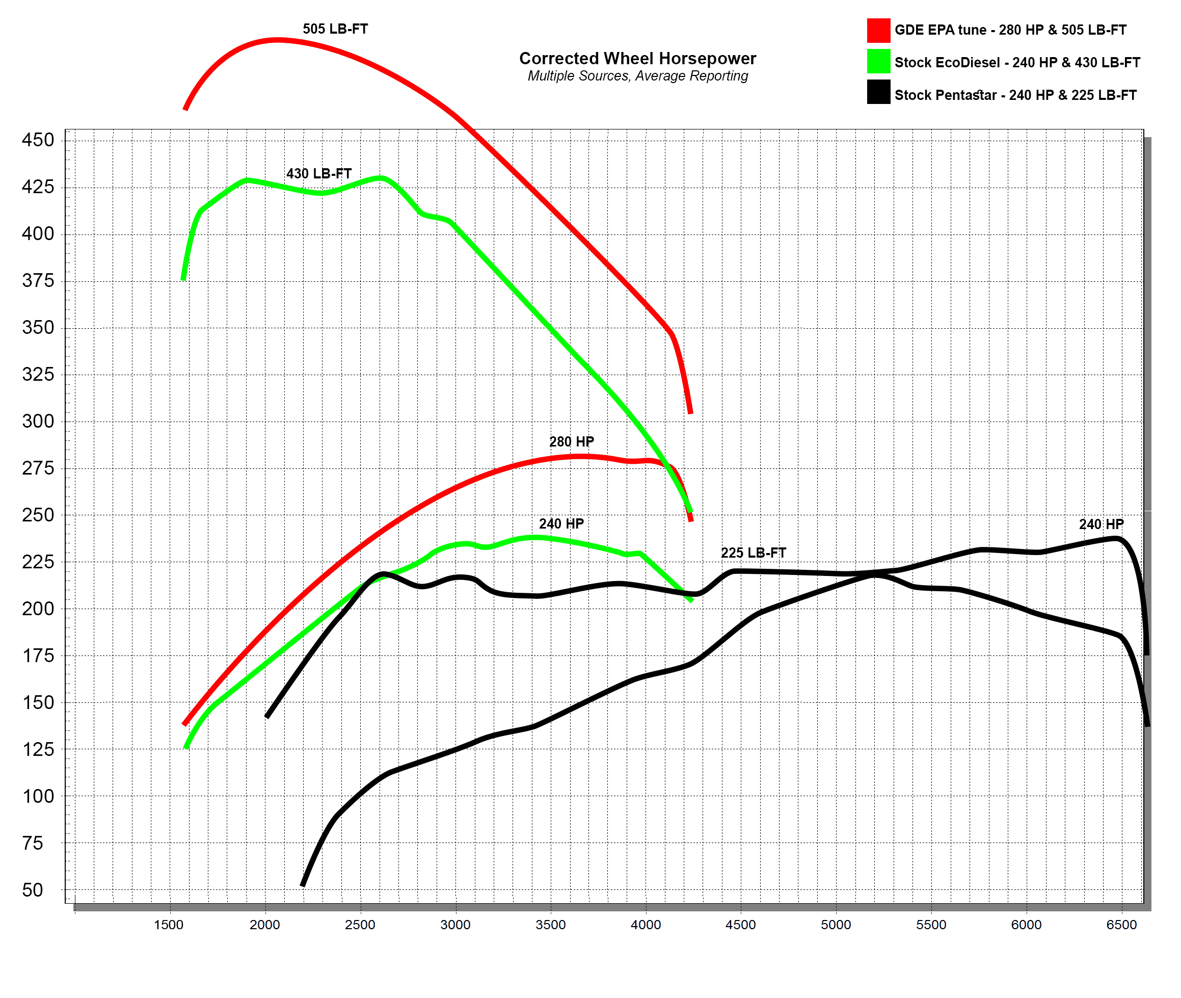

Butt Dyno FTW!
@BlueScapegoat It'd be fun to see a gas turbo on there... maybe the jeep2.0 or even better the Bronco 2.3 or 3.0 :)
I started to add the 2.0 turbo but honestly the dyno sheets online are so freaking variable that I don't feel right putting anything on the sheet. I don't know what the deal is. They're all over the place, some of them don't even look like the same engine.
Maybe if I get some time later I'll do a sheet with just the 2.0 Turbo dyno runs on it ?
Maybe fuel type? Doesn't it run on 87 but recommend premium?
Lots of different dynos that measure completely different. Dynojet, Mustang Dyno etc. Correction factors cannot accommodate.
That could be it. The Bronco I know senses octane and the difference is pretty big. I know very little about the Jeep 2.0.
Specifically Superchips got 310 lb-ft at the wheels on an engine only rated to 290 crank, but it seems most other people were seeing closer to 270ish
I'm aware of that, I even said that in my first post. But at least with the 3.6 and 3.0 charts they resemble each other enough I feel good averaging them together.
It doesn't help that a lot of these performance shops seem to like to set up at 6,000 ft :CWL:

That 3.6 torque curve is exactly what I expected, and why I keep my manual above 2000 RPMs, and don't even attempt acceleration below 2500 RPMs. The 3.6 is pretty weak below 2500, as we all know. It's exacerbated on the manual, because you have to do it yourself, of course, and a lot of folks just don't like RPMs that high, and also the long 3rd gear. Above 2500, it has a nice flat torque curve. So it builds HP nicely throughout the rev range. So like we all know, the 3.6 likes to rev high.
100%, I can tell the cruising power picks up noticeable at 2,000. Never fear the gear

I was discussing the Pentastar vs Ecodiesel in a group chat with some friends and threw together a direct comparison of dyno sheets for the hell of it. Figured I'd share here.
I want to make a point of saying I'm not arguing the accuracy of these sheets. I grabbed a few from various sources online, scaled them and sort of visually averaged them, and this is the result. Different dynos and different calibrations will have a pretty large effect on the results. The purpose is to give the uninitiated a good idea of how a diesel compares to a petrol engine.
GDE tune is just on the sheet because that's the route I'm planning to go.
