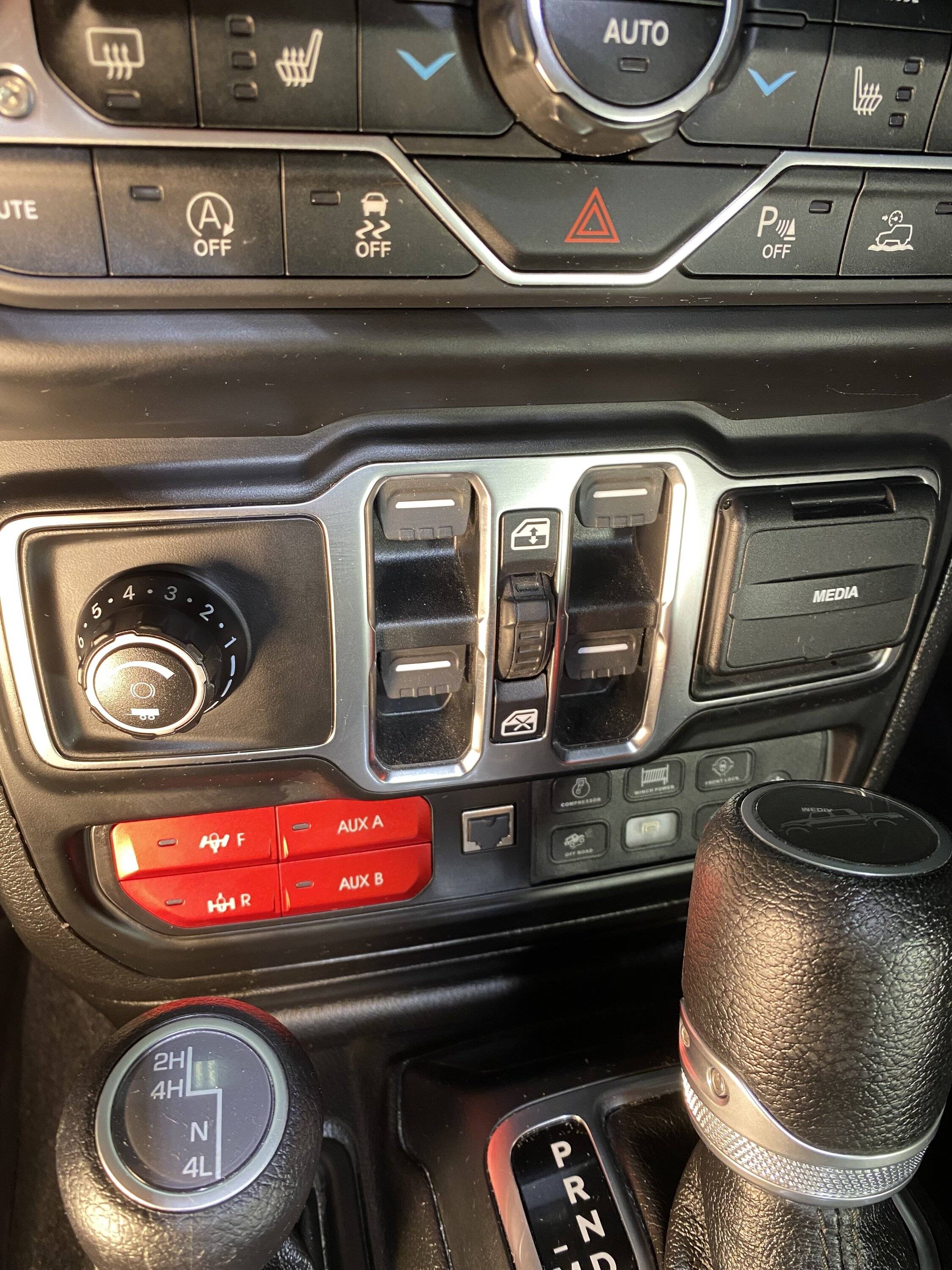

First if you don't have a Rubicon the factory Locker wiring harness is not in place. However, to install locker wiring and get a factory look is easy using the Mopar Locker Harness and Lasfit Locker/Auxillary Switch Panel. I installed Rubicon axles with the Lasfit Locker/Aux Switch Panel and am very happy with the operation and looks of the install.

Yep. I installed the Lasfit a couple of weeks ago for the lockers that will be installed next week. I didn't know it would look so much like Factory. And it allows you to change your locker mode.

I keep the locker switches set to only operate in 4 low. However, I do like that the locker switches have the optional setting to allow locker operation in transfer case position.
