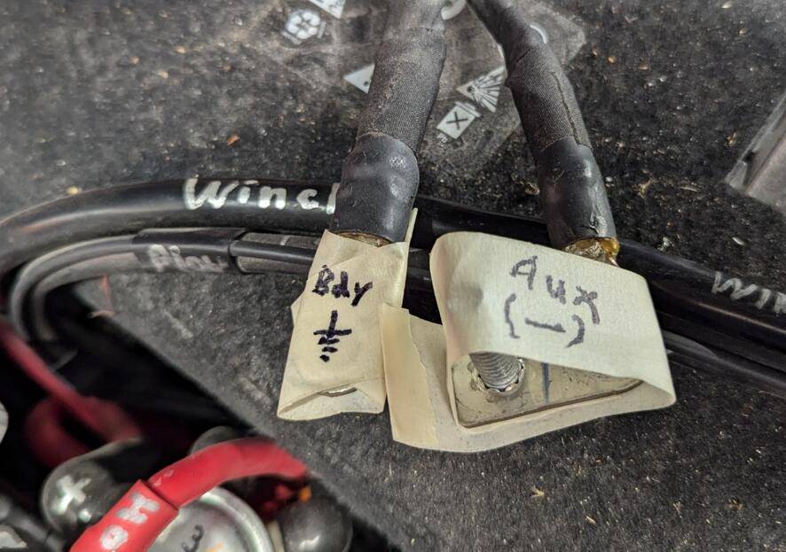

I'm somewhat confused what you mean by IBS (intelligent battery system/sensor?).
i get taking the terminals off, where/ what is the ibs? ( I saw your pic of it in another post)
I guess what is primarily confusing me is i removed the connectors from the post on the main battery(lol i did actually use gloves to insulate them) they touched nothing. I clearly missed something, lol i just cant quite place it.

Once the cables are off the IBS (red arrow)
Jeep Gladiator ECU Reset (to relearn driving habits etc) JT-neg-bat-post-cables-ibs
Make sure to take them apart -
Jeep Gladiator ECU Reset (to relearn driving habits etc) 1744431338323-q3
then the system is powered off 100%
