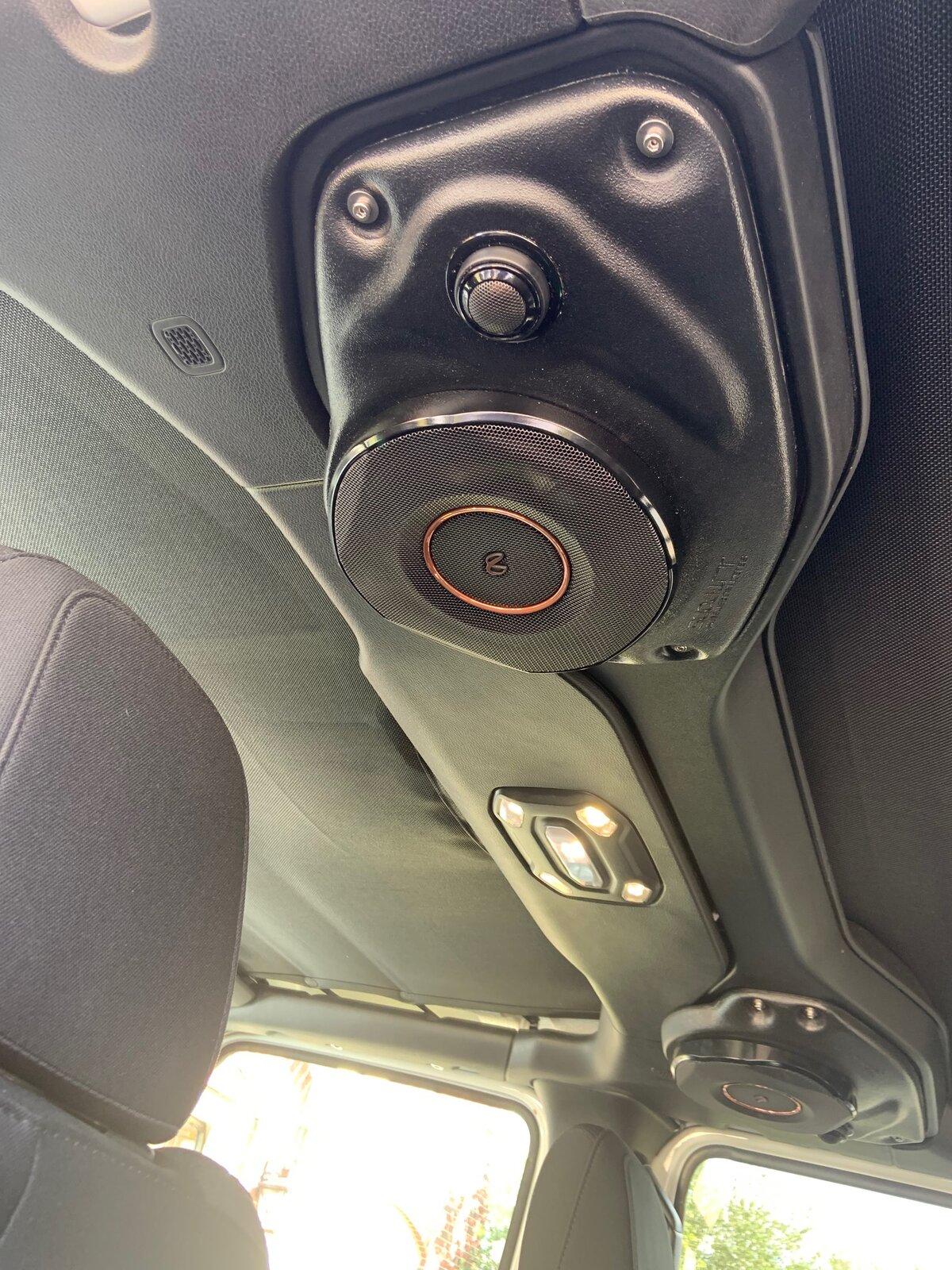

Installed the Select Increments rollbar speaker pods today with Infinity Reference component speakers. The pods fit well and look decent. I put butyl mat inside the roll bar, as well as on the underside of the pods. I loosely stuffed the rollbar and the pods both polyfill. The wiring adapters were the correct polarity, so that part was plug and play. The improvement in sound is pretty huge. Much better sound quality and It's much louder at a lower volume setting, no distortion or buzzing. I'm pretty happy with how it turned out and it all cost me less than $200. I scored some scratch and dent pods straight from Select Increments. The only blemishes were in places that can't be seen after they're installed. The speakers were open box, and half price from Amazon. They arrived still in sealed factory packaging. Sorry for the crappy pic:
