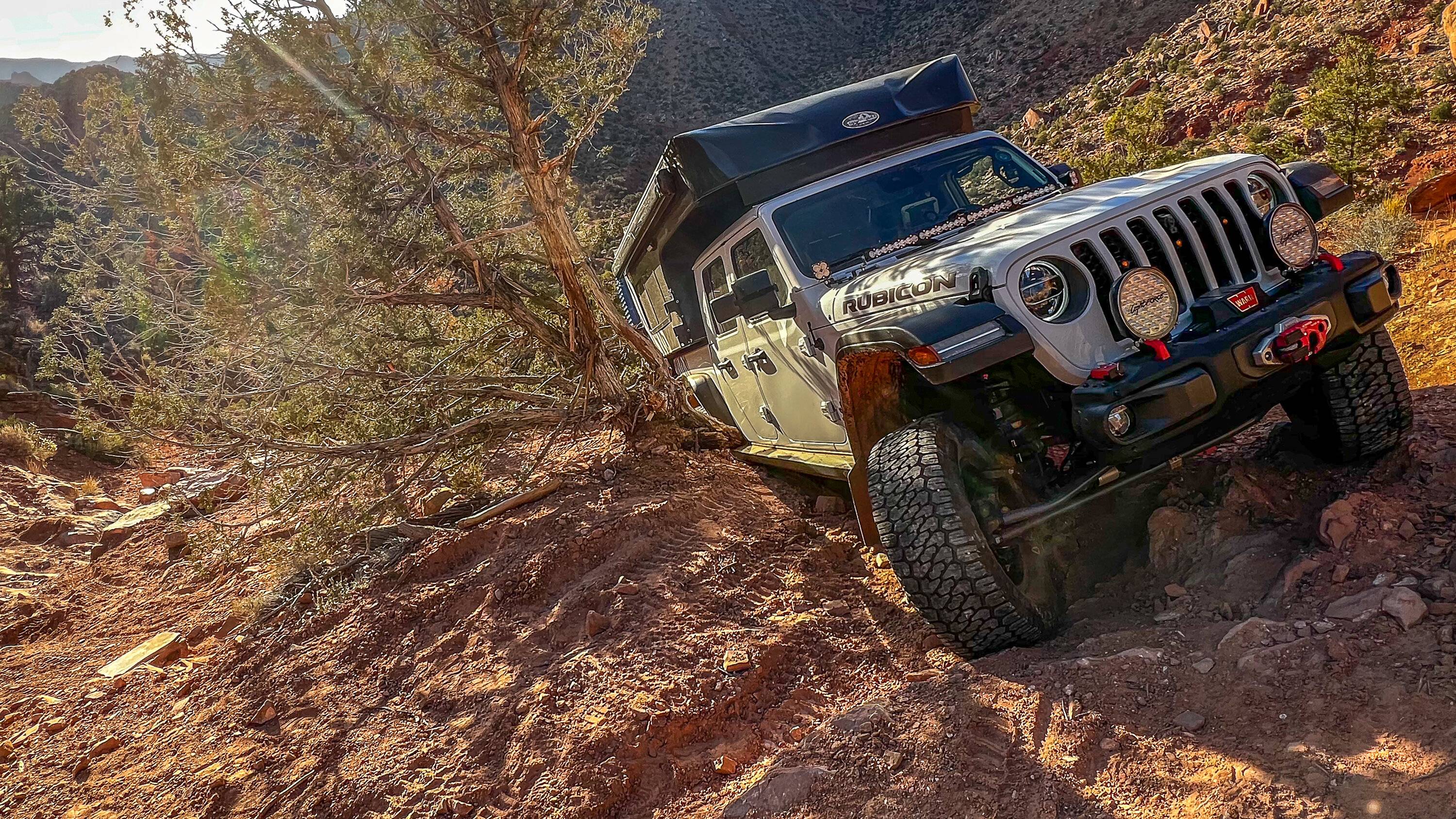

Just the other day I drove a tank 120 miles on the freeway at 70mph. (no camper) To Salt Lake up and back, Lifted with 35" tires it averaged. 32.2 mpg. This was hand calculated and very close to the odometer trip meter. Yes, this is the best mileage I have seen so far but 25mpg is easily attained. This range makes a difference for an overland vehicle. I get 18-22mpg with my full camper out on the highway. Once you slow down to 55 it will get 25mpg again with the camper on. The torque, along with fuel economy, is just incredibly fun to have.
Wheeling with an overland rig has a few pitfalls. The added weight is the biggest. I found myself on a Rating 7 trail in Utah, "Rose Garden Hill", and really experienced the weight disadvantage. Once I started into the trail, I was committed after a few obstacles. With no chance to back down being by myself. But the Torquey diesel just grunted up the ledges and rocks. I don't advise this and my rig won't see this type of trail again.
Just food for thought.
