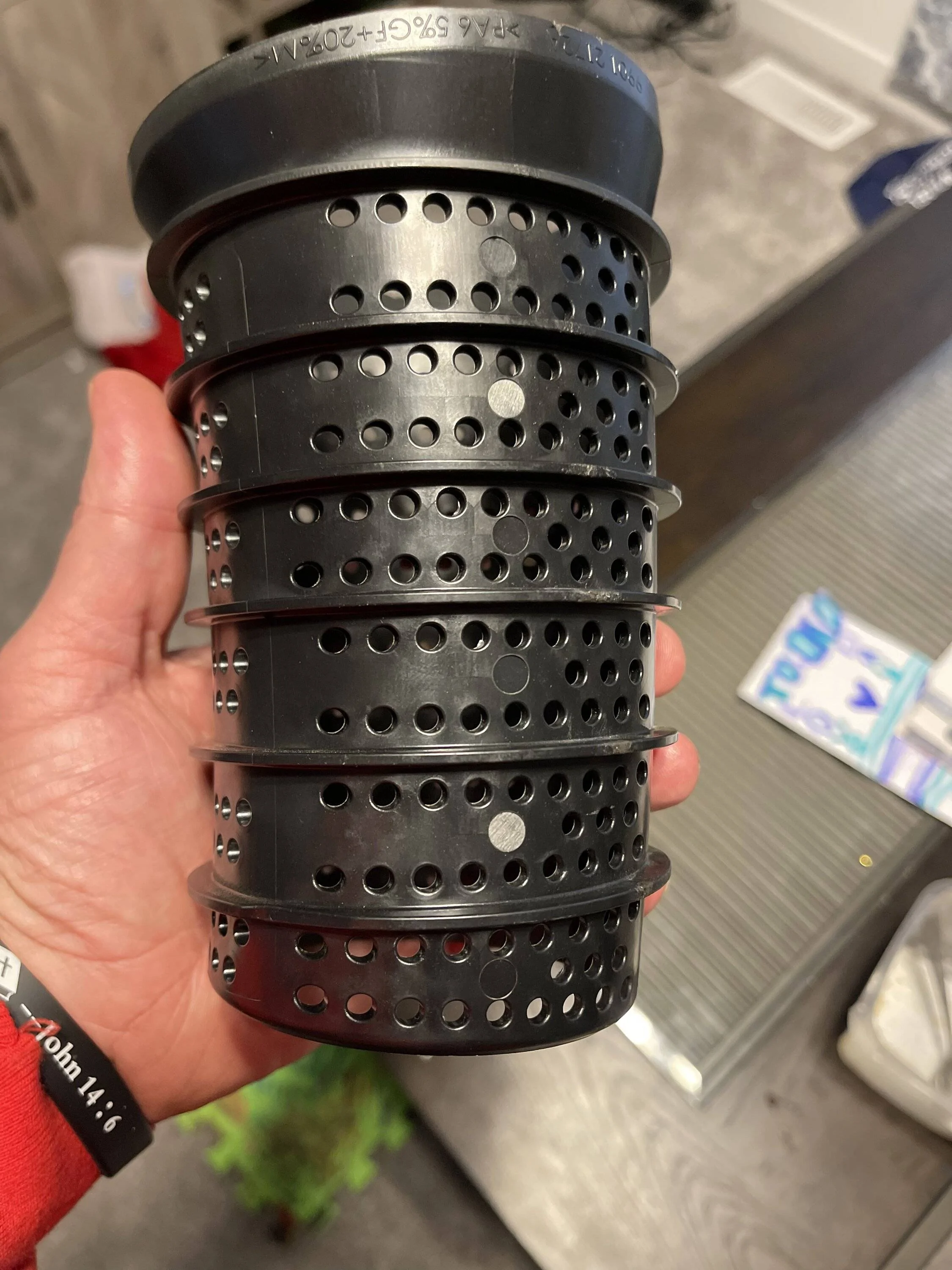

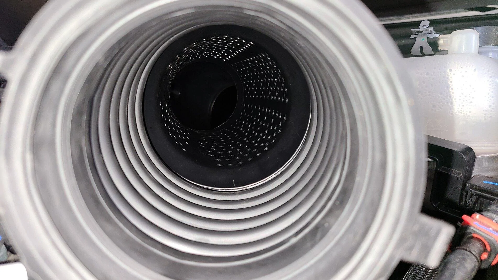

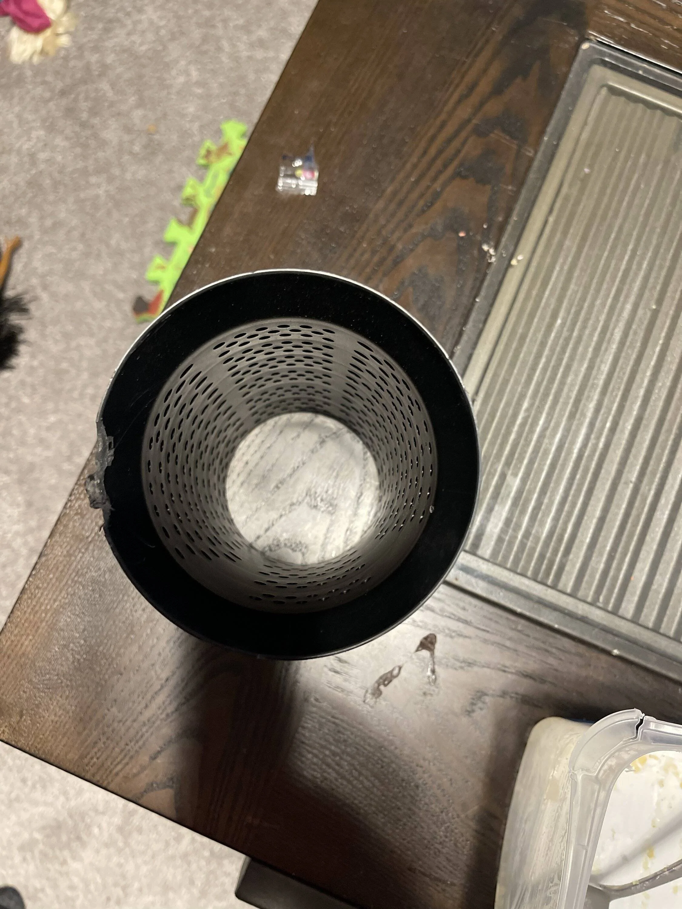

I've read on other diesel forums that most diesels have silencers in the intake tube to keep turbo noise down and adjust air flow. A lot of folks go in and remove these silencers for the additional turbo noise and unrestricted airflow. Has anyone tried this or have any additional information/experience?
i Took mine out today, a little more swoosh sound for sucking, however I have the husk off-road snorkel kit and that gave me more sound from airflow as well. So not exactly sure how much more sound you will get from stock box/intake pipe. You will have to break the stock clamp to remove the boot that goes to air box, the pull screen out and take off the stock clamp break it it’s glued down, then use 5inch band clamp.
On the Ram with the same engine, the intake ductwork from the air box to the turbo inlet has some baffling inside to reduce noise. I looked at it and didn't see a way to remove it. It is molded into the intake pipe. So, I purchased a replacement pipe that's made of aluminum and is a straight-through design with NO sound deadening and NO neck-down airflow restriction. I really like it. I got it from T&S Speed Shop up in Canada. I'm not sure if they make one for the Jeep truck application but you could call and ask.

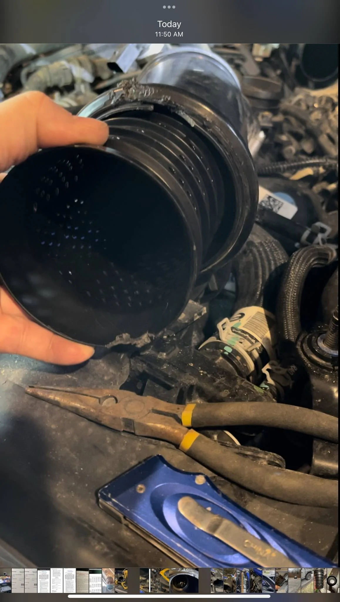

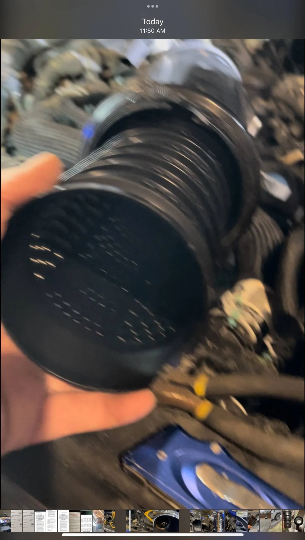

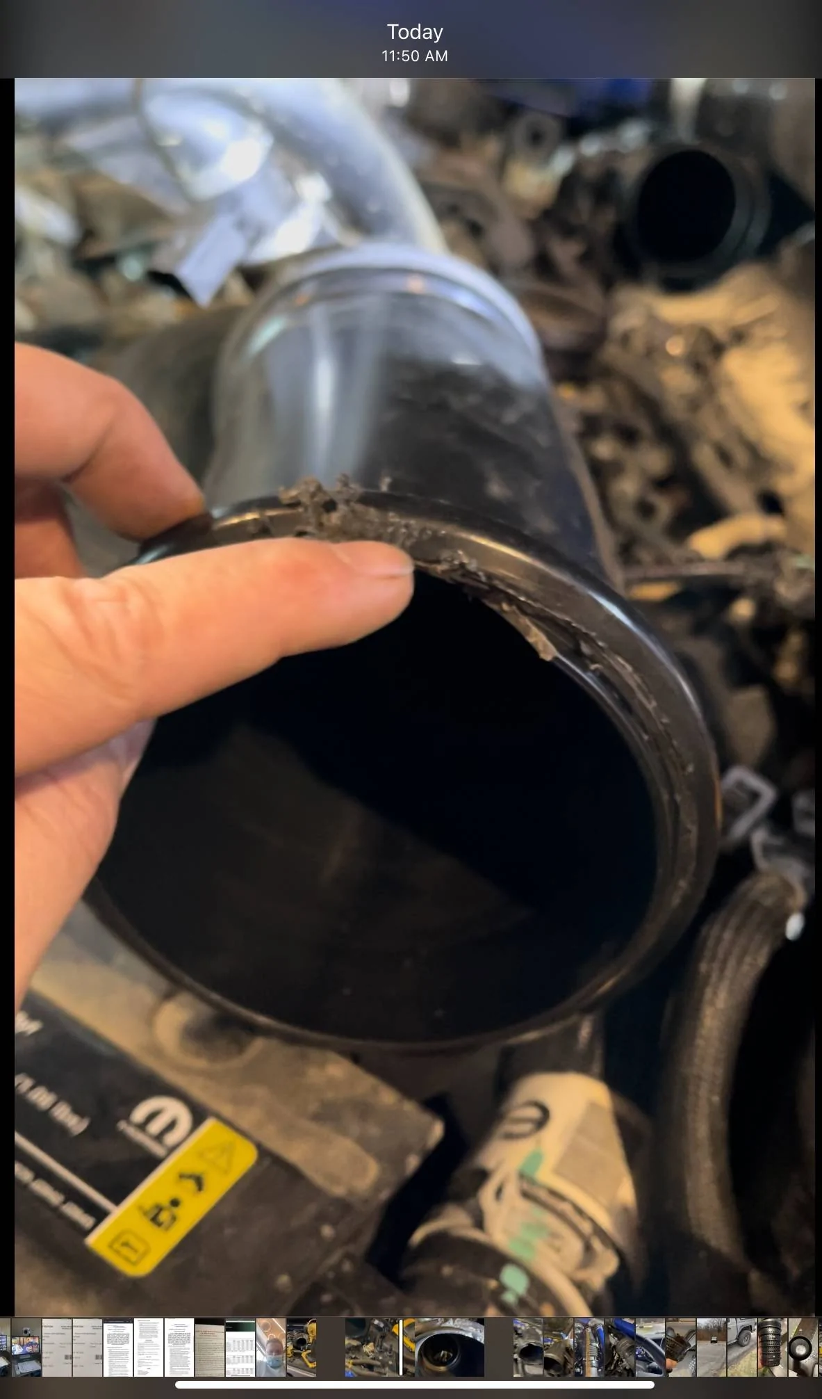

5inch band clamp could be more snug, I order 4.75-5.15 wire ring band clamp today how much better it would be. But as you can see in video it isn’t coming off. I slid the rubber boot down on intake pipe 3 rings right at the point where it fastens back to air intake box just right. The 5inch band clamp tighted to pint of not twisting with hand, but I feel it could be tighter. Also you may can break the black ring plastic glued down stock clamp intake pip without cutting boot. The boot slides under it then over intake pipe. But cutting along seem worked just fine. I used plers and broke stock clamp peace at time.

a little, I got sound when I put the HAUK Snorkel on, seems I got little after takings silencer out, but one thing is for sure it’s smooth bore and no baffle, air flow mass has been improve, how much or how much on performance side…need dyno before and after lol.
