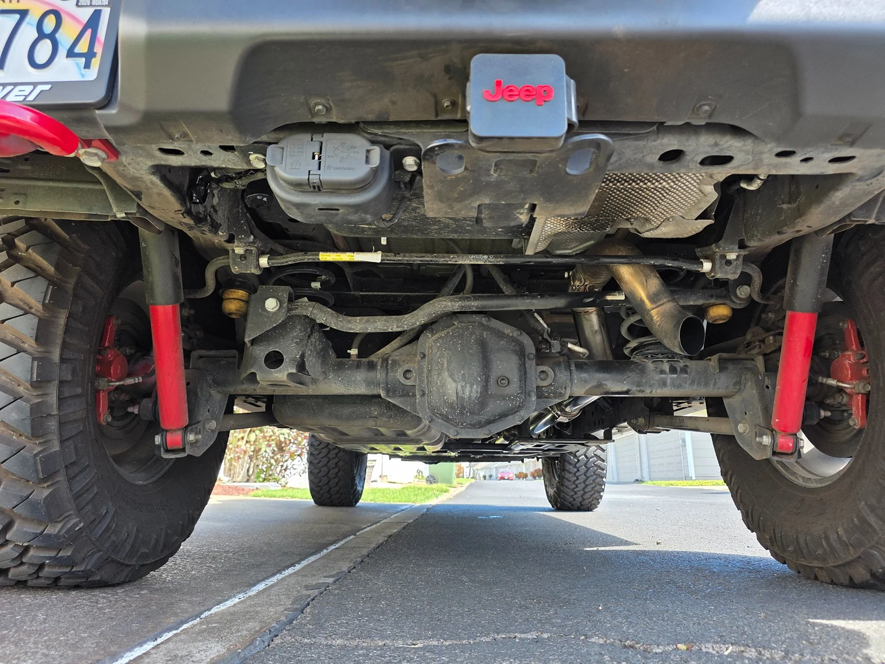

Hey everybody, I have to tell you that our Jeep sounds soooo good with a full delete and straight thru exhaust. I wished I could post a video here. I may do a YouTube video and post a link. I also removed the very heavy and bulky appendage DEF tank.
Jeep Gladiator Banks Intake Manifold Kit 41390 on 3rd gen Ecodiesel Gladiator. 20260206_121644
