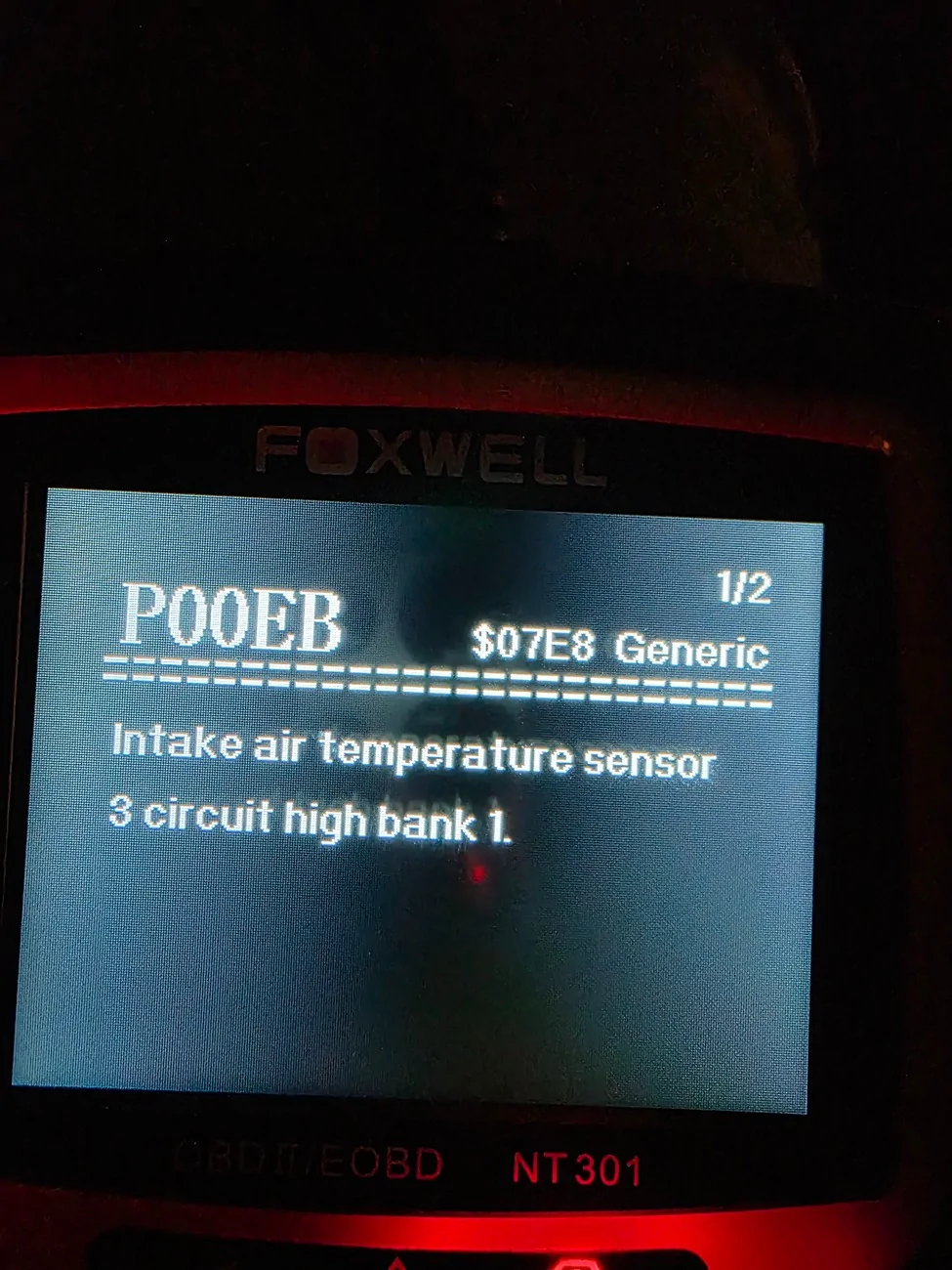

Well everyone, it works on the 3rd Gen. I have a Diesel Dudes bundle and a few other goodies. Jeep is running fine. I do have a Check engine light and my glow plug light stays on but other than that everything hooded up and is connected correctly.

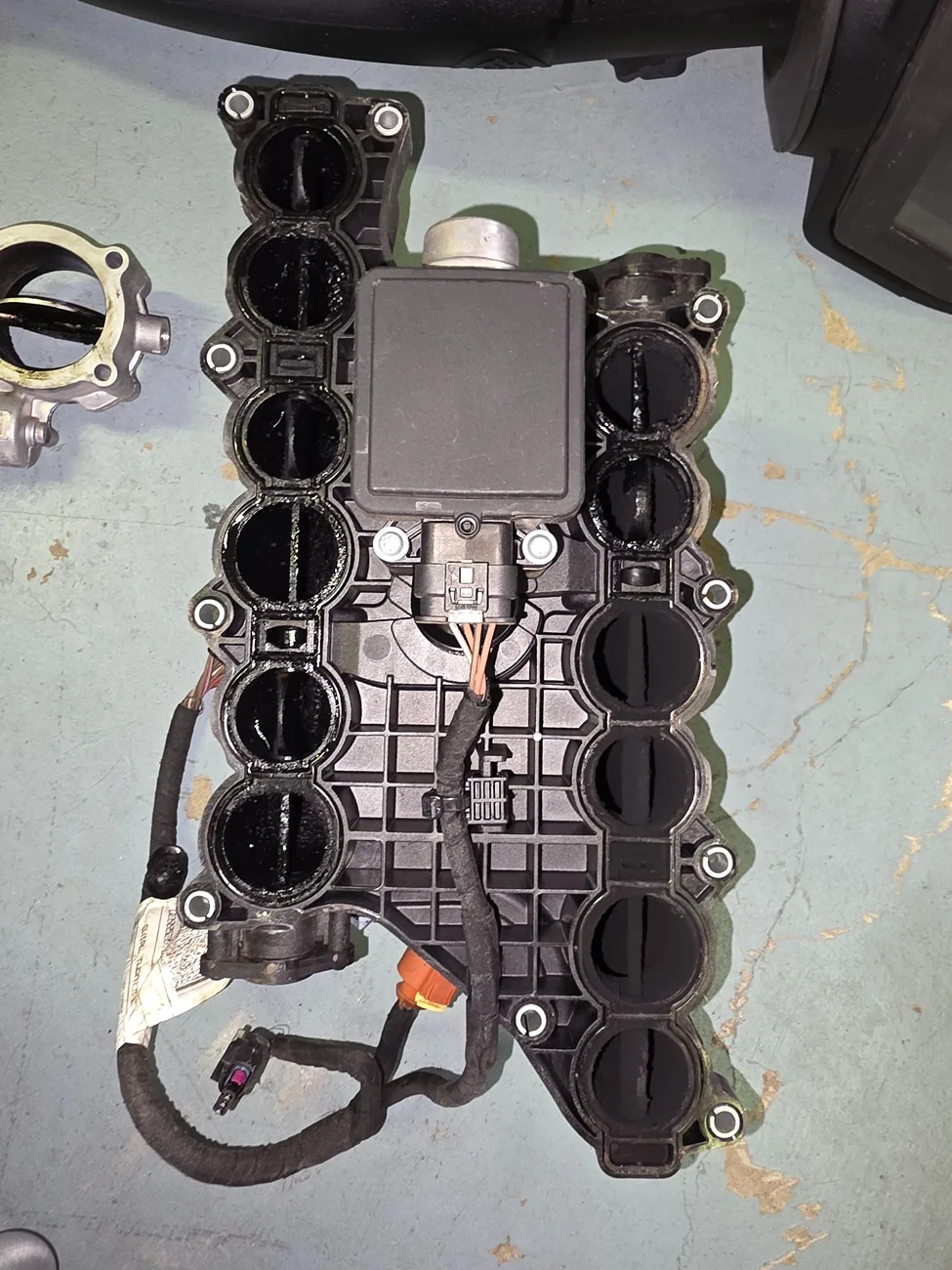

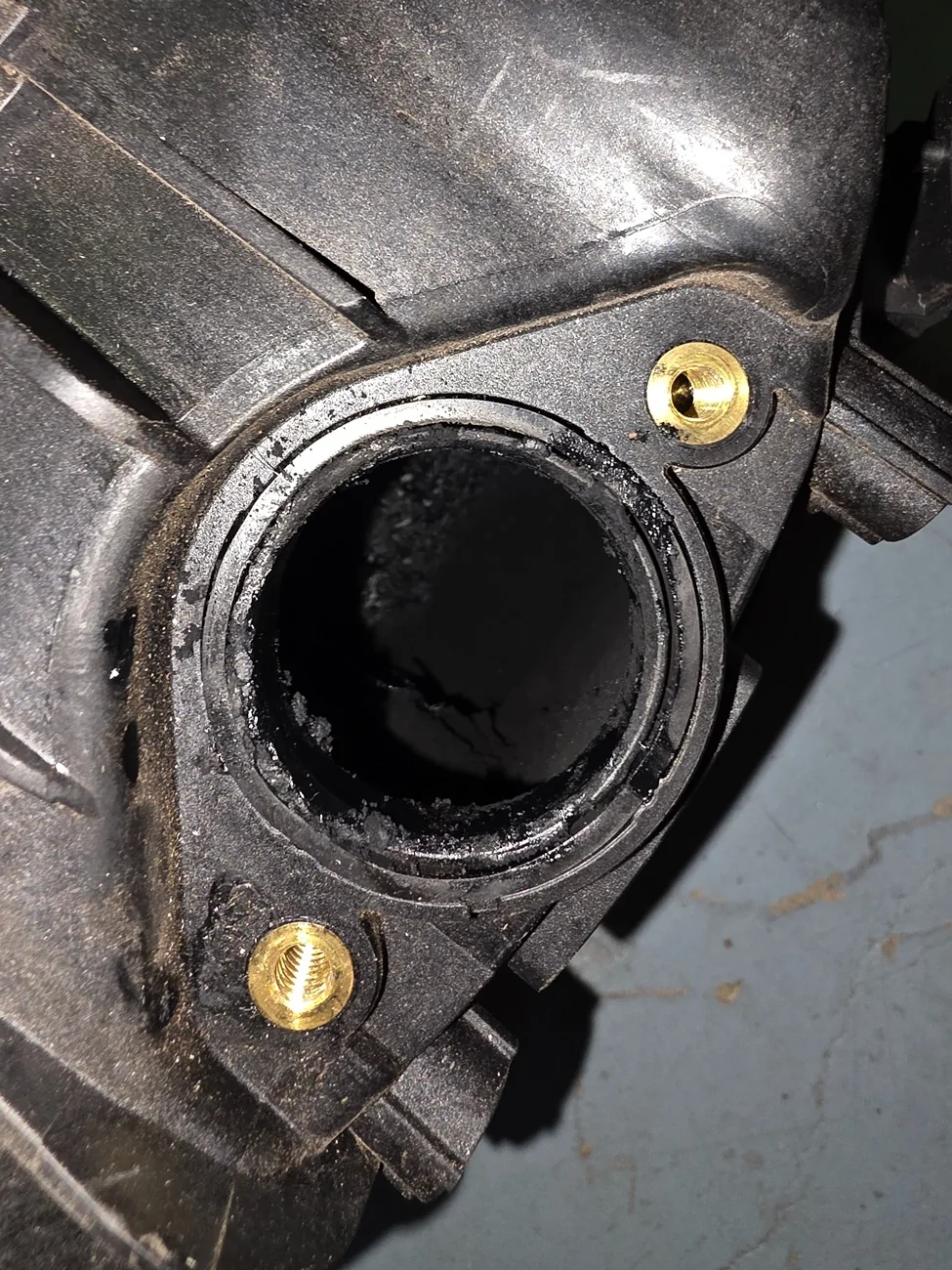

I used a stock Diesel Dudes tune and exhaust. The intake does a few things. Improves flow as the swirl valves are removed and the valve at the entrance of the intake (kind of a throttle body) is also removed opening that flow as well. It doesn't have a place for the EGR tube so no future leaks to occur or block off plate to worry about. Lastly, my stock one was clogged up with soot (not carbon) so I was planning on replacing it anyway. Why not go with the Banks?

What is the CEL code?

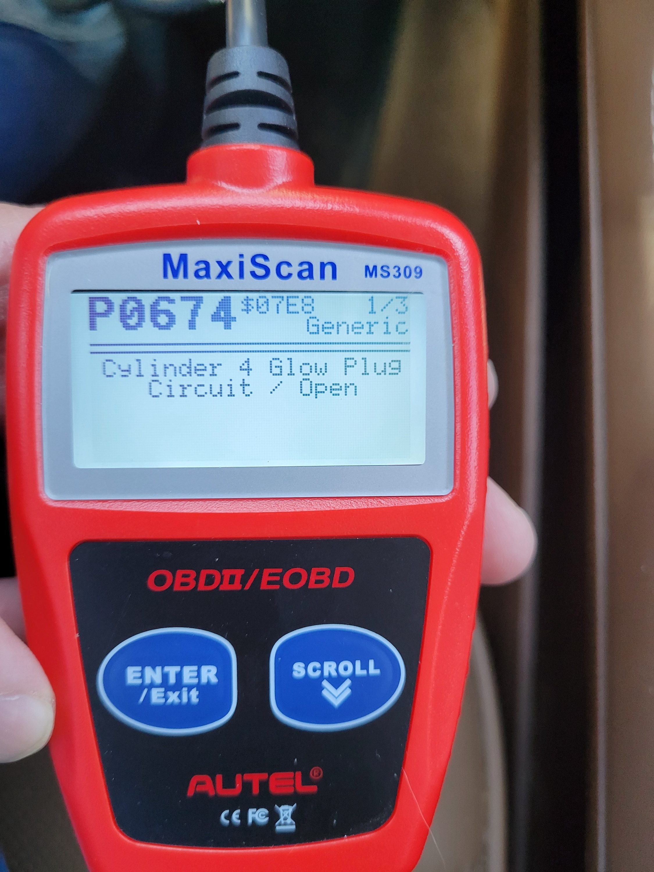

We've seen quite a few failures around 58,000 miles, but that is the lowest mileage I've seen. Here's what the code looks like when one does fail.
Jeep Gladiator Banks Intake Manifold Kit 41390 on 3rd gen Ecodiesel Gladiator. GdWV6av
