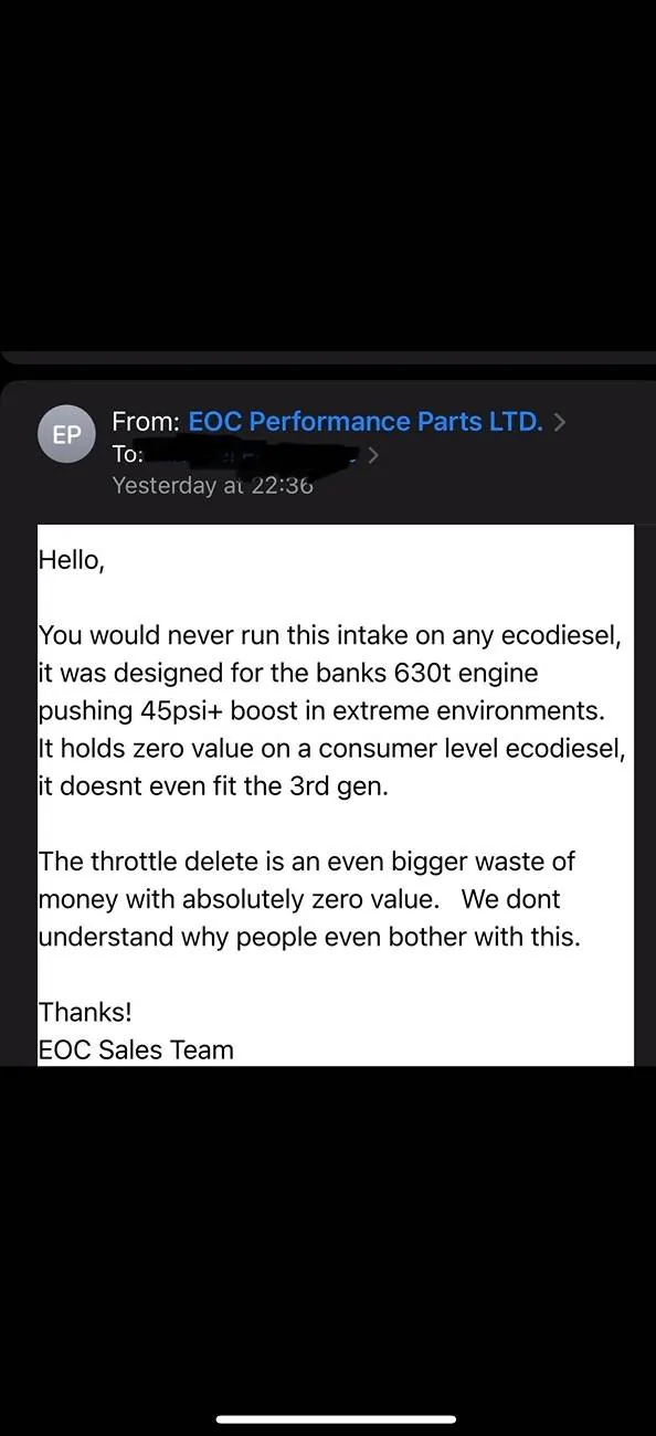

Wound up going the route of reaching out to EOC asking if their tune would be compatible and this is what I received from them. Seems it’s not even worth it for the performance gains.
Jeep Gladiator Banks Intake Manifold Kit 41390 on 3rd gen Ecodiesel Gladiator. IMG_8901

When both companies say NO explicitly, I would agree with both of them. It would be nice if it did for replacement if needed.
However if it did fit the Gen3, I would only be looking to replace this if you HAD to replace the intake. I don't know about you all, but to get to this intake coming off it would take a lot of work. There is a lot of lines, wires and hoses running over the top of the engine. This would not be some Sunday walk in the park.
