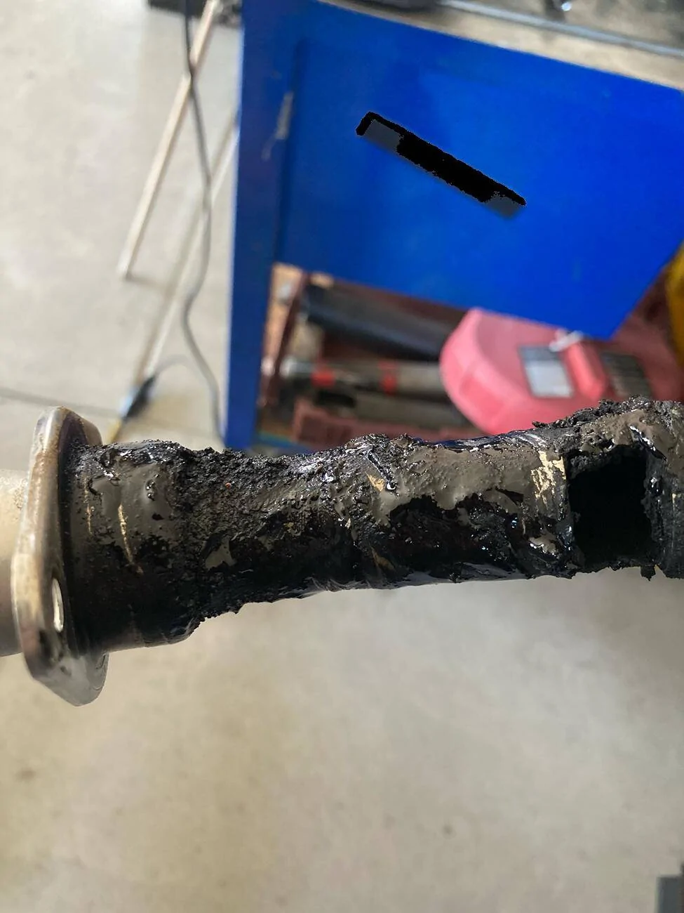

To try to answer your questions:
Pulled that tube at around 80K. Do not run fuel additives regularly. Ran some extreme diesel for about 8 tanks of fuel after that, have not checked it since. As far as getting it off, it just takes removal of the heat shield upstream on the tube and a wobbly on a socket for the two screws and some gentle love, persuasion and some encouragement that the jeep will be ok and out it came. If you do attempt it, I will say( and can't stress enough) do not over torque those two screws!!! I initially wanted to see if the intake was melted as I have seen and heard instances of that with the plastic intake and the temp issue the eco has. When I was seeing 1500deg. at the turbo last year, was concerned the intake plenum might be taking the brunt of that heat. The temps out of the egr during those pulls was also higher than it should be.
Thanks! Would you mind taking a pic of the tools you used? If so, I'd greatly appreciate it. I want to start cleaning the tube regularly myself if I can. Spent over $300 to have a shop do it the last time around 😒

Just saw a video on YT of an intake manifold........holy fuckin hell. Close to 40% blockage on the intake.......so glad I opted for turd'ish cam eating PenaBomb

For EGR and intake the #1 cause it gets clogged is not from soot but from evaporated oil. You need a catch can and not just any can. The best one is the Mann/Hummel Provent. There is no real kit but Im going to make it work once I get around to it.
If you figure out a good way to plumb it, I'm sure that I'm not the only one who would REALLY appreciate some photos or a little write-up on your installation.

Had mine out too to clean it. Intake looks about the same. Gonna pull it off at 100k( in about a month) and clean that all out and replace all of the gaskets.
Holy Hell!!! I am glad I made the move to just get rid of the entire system. I had the DPF replaced 2x under warranty before I finally decided that I didn’t want to have such an expensive part replaced on my dime. Like everyone else who has had the weight loss procedure, I wish I had done it sooner.
