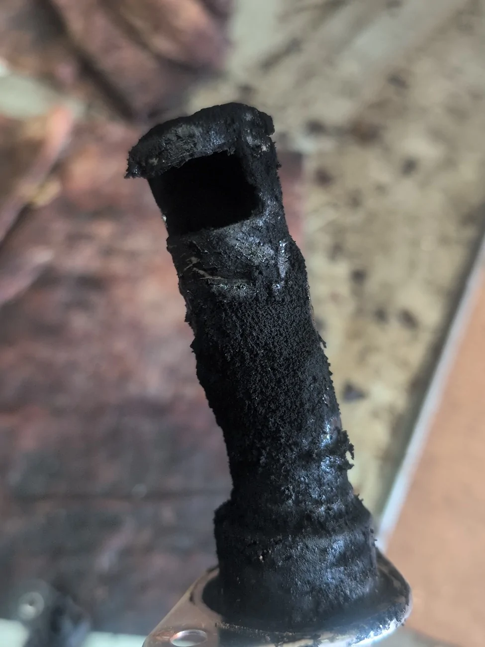

The catch can will really help the oil is the problem. Also, a fuel born catalyst can be beneficial. I’ve heard after I finish my redline fuel catalyst I want to try https://betterdiesel.com/shop/
Oil is the cause for the carbon to build up quickly. Carbon will still build up over time with the EGR intact. Delete the EGR, oil is no longer a problem.
I don't want to delete the EGR for now and can't. I could swap ECUs by turn it off every 2 years then I would use ALOT more DEF so then I need to turn that off and deal with draining and filling ever 2 years for my emissions test. The other issue is do I want to be close to taking in NOx. Not really for now anyway. My solution is going to be to use a filtered catch can, low Noack oil, and best of all going with a Snow Performance water/meth injection 2 stage. Ill install on the ports provided on the AFe charge tubes. Ill use the windshield reservoir for now.
The water/meth will make everything much cleaner and over time to look like new. Also, the combustion chamber and turbine as well. Im going to do a small nozzle pre intercooler and larger post intercooler. I will make much less soot and Nox as well with les DEF. Also, will give a little boost in MPG due to the more complete combustion.

Yes. The EGR is left in place and block off plates are installed. The tune should reduce the percentage of operation so that the ECU does not pick up that it is blocked off, preventing a cel. Again, I'm not sure how they are tuning the 3.0, but I'm sure it can be done this way.
Catch can will help, if you leave the EGR system function. Soot will still build up, many miles later, you will still have soot build up issues.

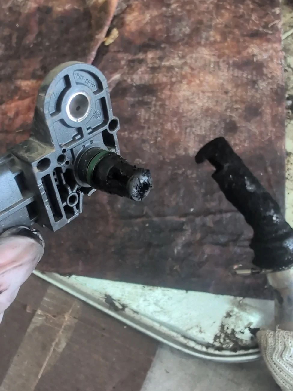

vicsvx
Jul 11, 2021
504
443
Arizona
2021 Gladiator Sport S 3.0
I just did and oil change and fuel filter change at 60k. First three oil changes were done at the dealer (not sure what oil they actually used because of the confusion early on with 3rd Gen ecodiesels). But after that, I've used valvoline European 5w40 full synthetic. Hotshots EDT every fillup after the first three years. This is the first time I cleaned the MAP sensor and EGR tube. I installed a catch in hopes it'll help prevent this mess again.
Jeep Gladiator EGR Diffuser Tube Cleaning; 3rd Gen EcoDiesel b7bb82cf-cf0f-415a-9f38-69ddca6e39d5
Jeep Gladiator EGR Diffuser Tube Cleaning; 3rd Gen EcoDiesel a0348bf6-923f-49b1-bfb5-2f1786f9504a
