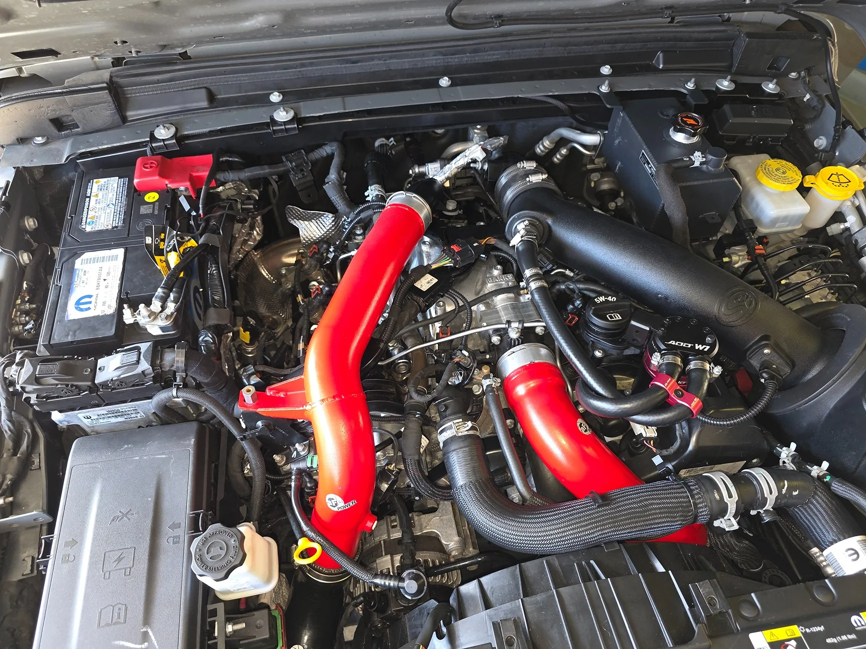

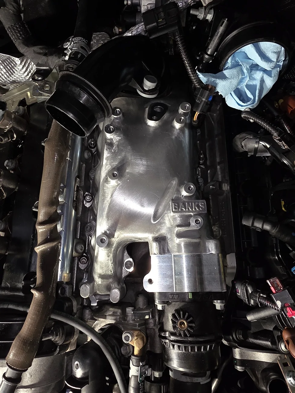

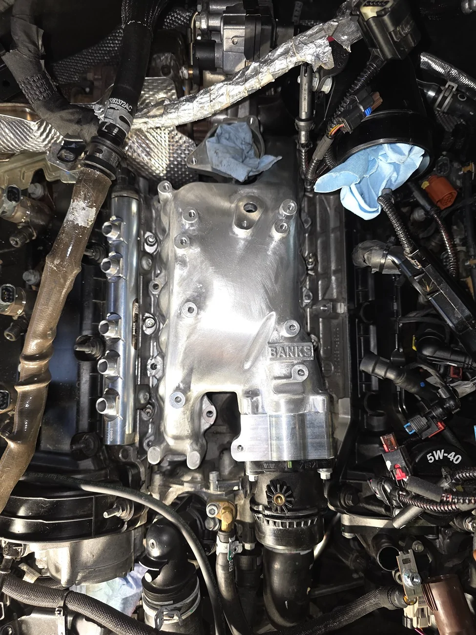

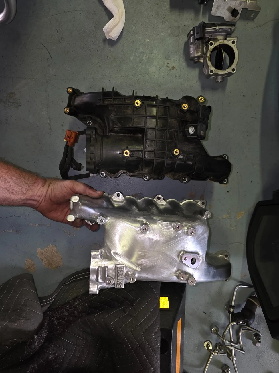

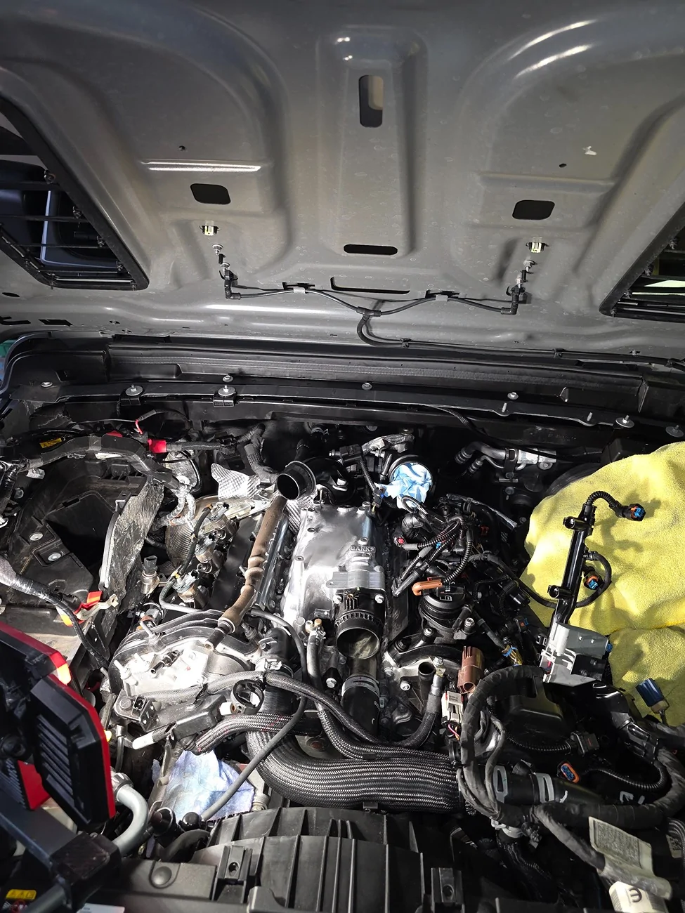

Well everyone, it works on the 3rd Gen. I have a Diesel Dudes bundle and a few other goodies. Jeep is running fine. I do have a Check engine light and my glow plug light stays on but other than that everything hooded up and is connected correctly.

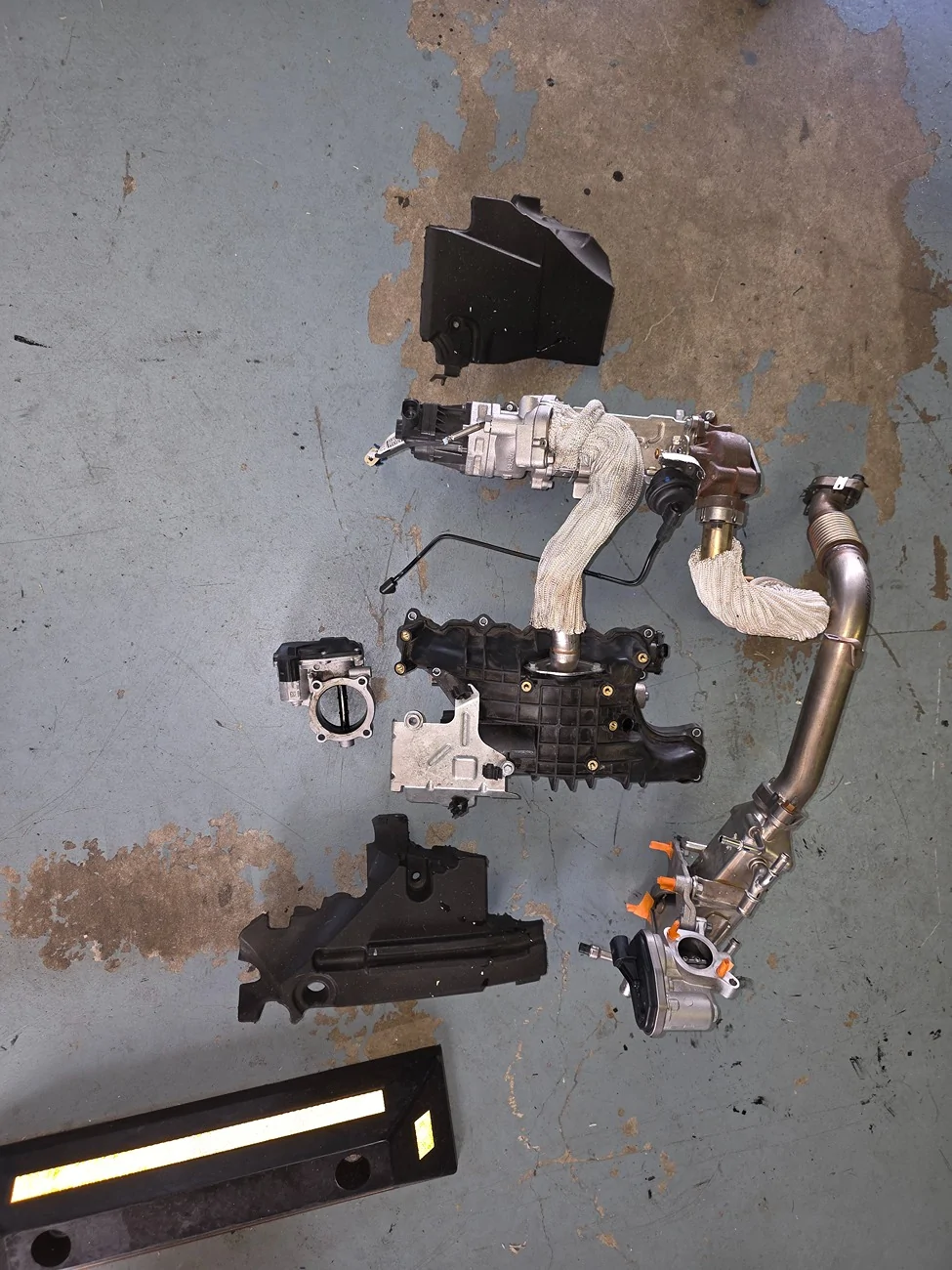

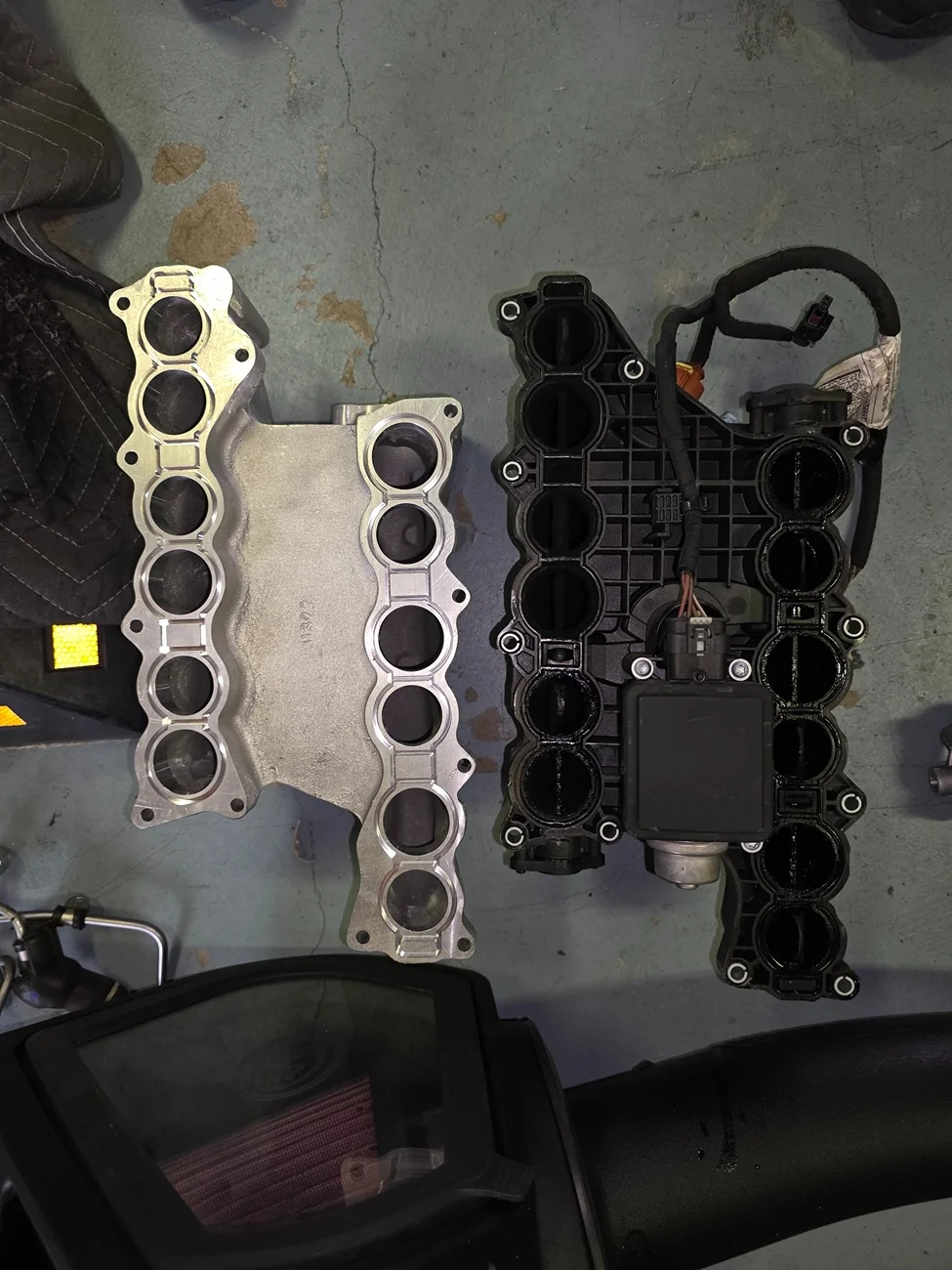

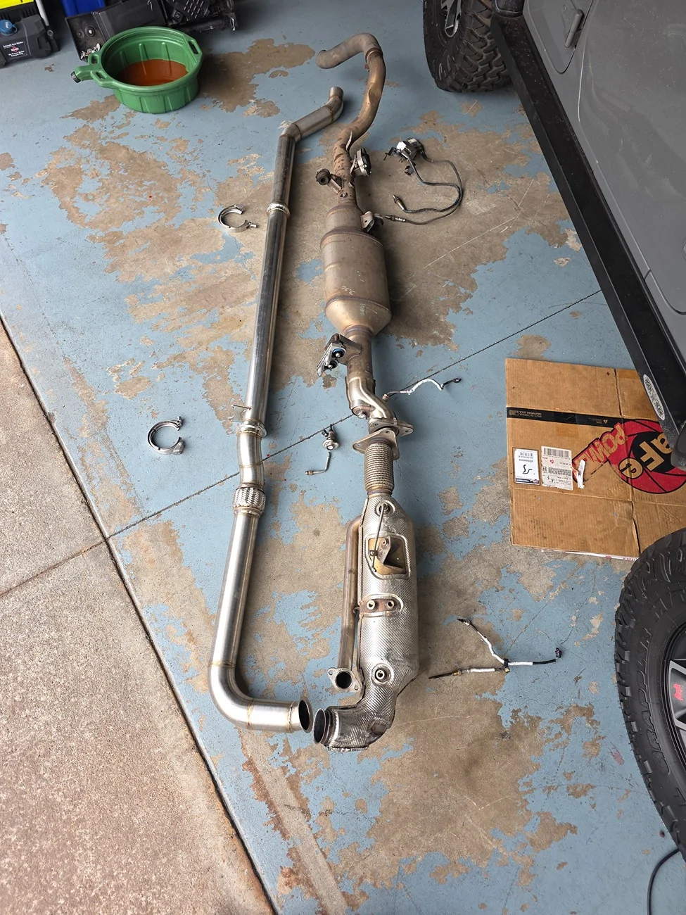

I’m interested in swapping my factory intake manifold for the banks without the swirl valves. Seeing conflicting comments online if this will fit the 3rd gen engine. I’ve spoken to a few shops and they say that is does in fact fit. Even on Banks website there are multiple comments asking if it fits with two conflicting answers. Posting to see if anyone has actually done it themselves if they could post some pictures. I want to remove both egr coolers and install the manifold all at the same time.
Yes it does. I just completed my fully deleted 2021 Wrangler.
