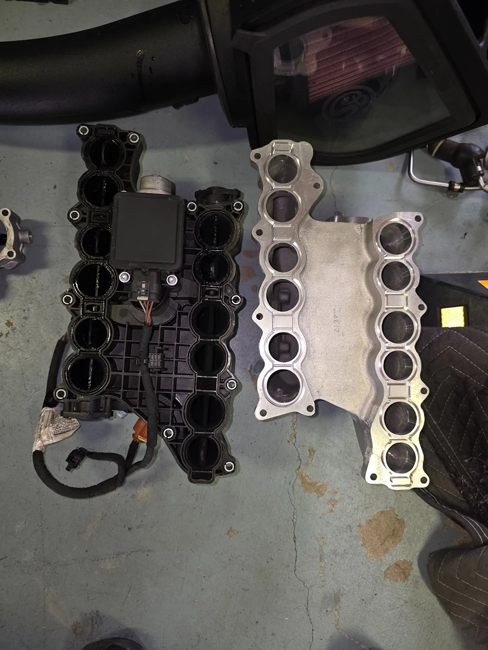

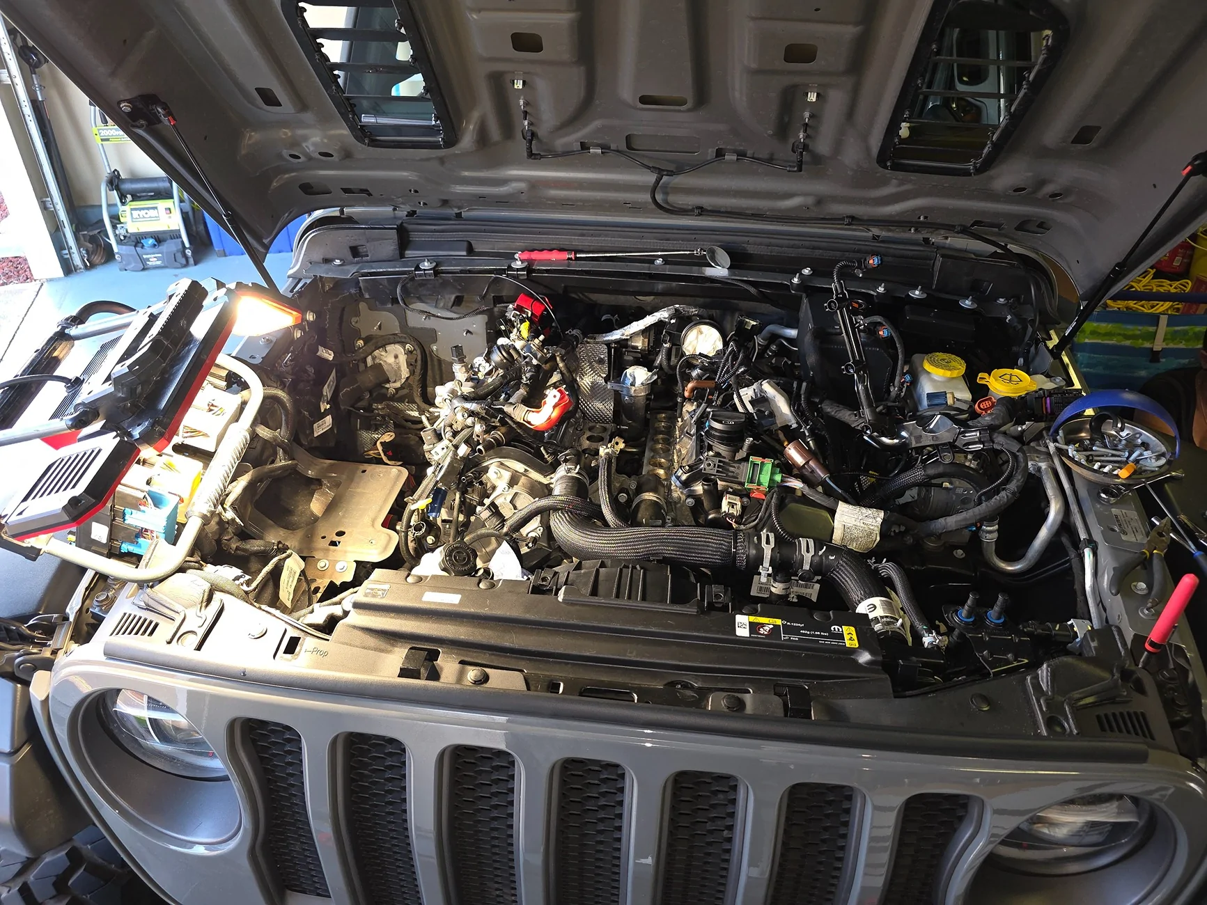

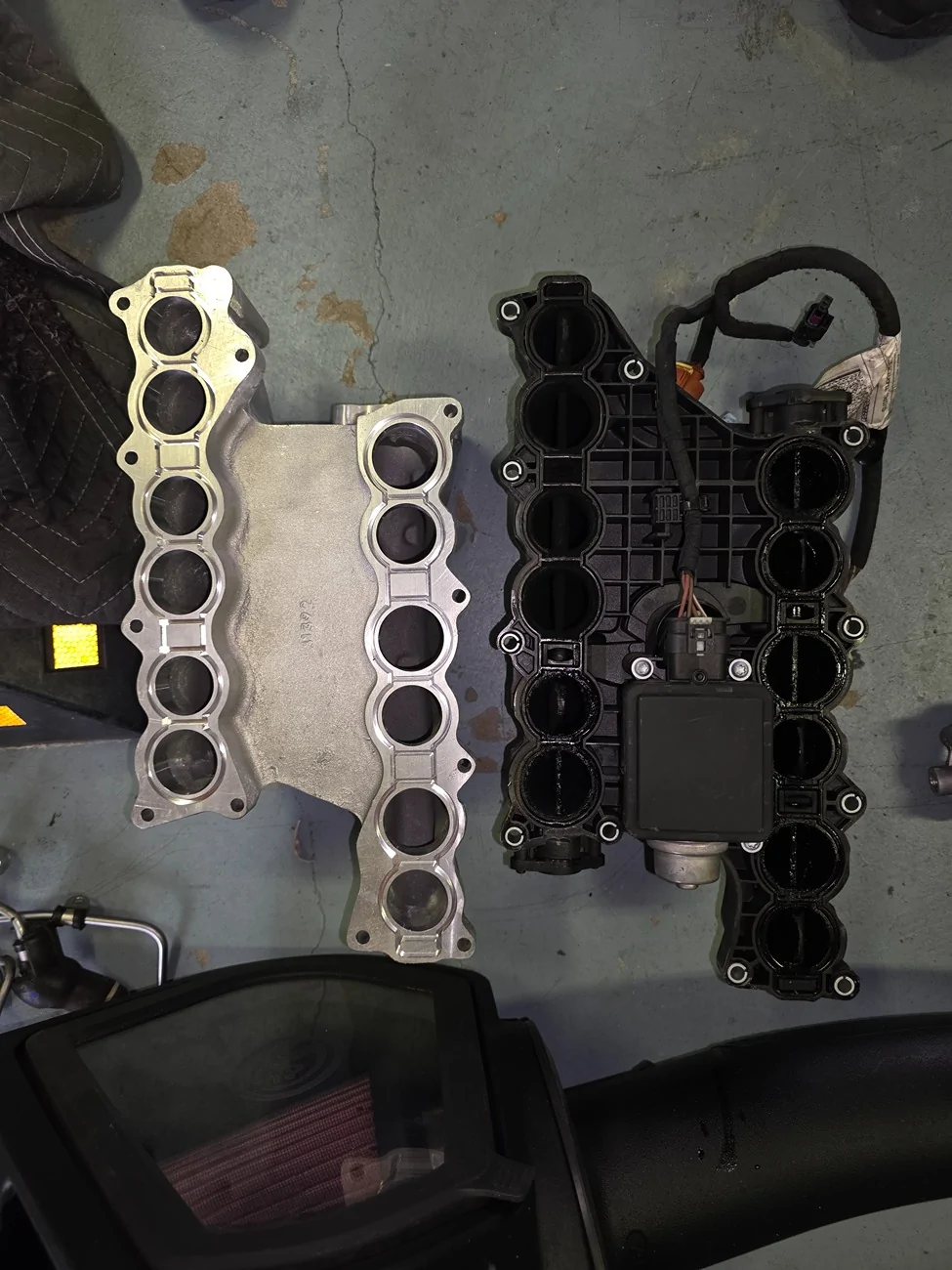

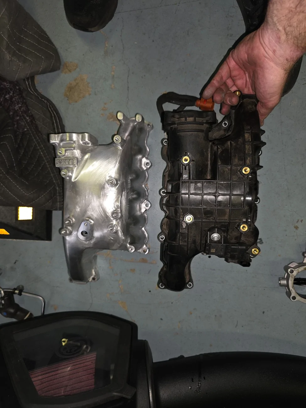

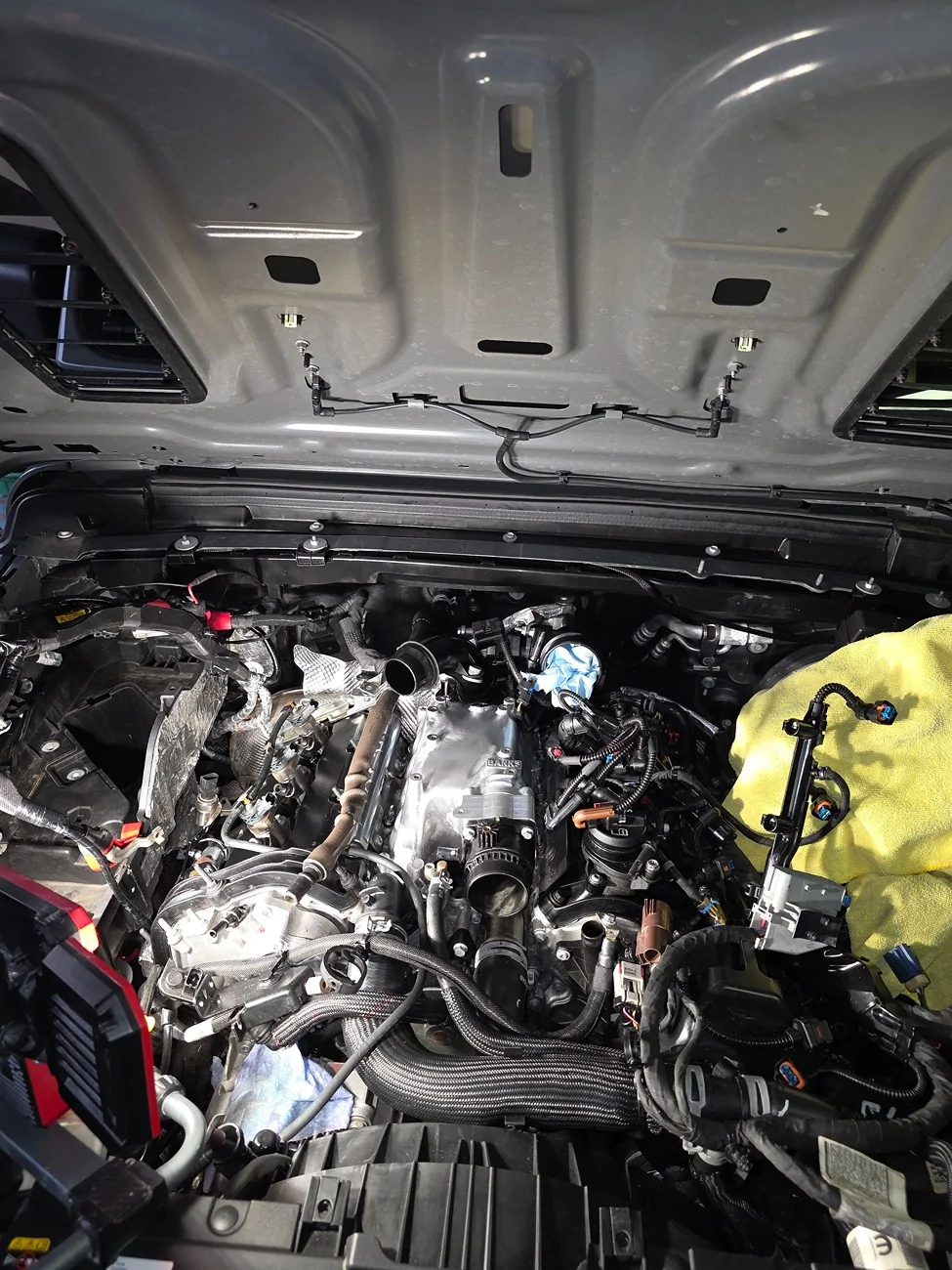

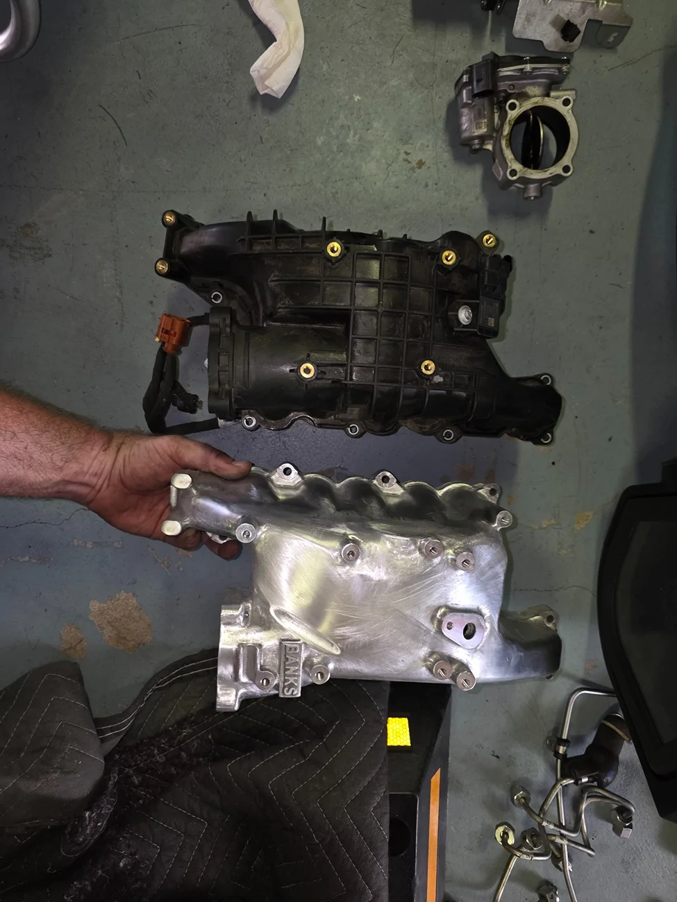

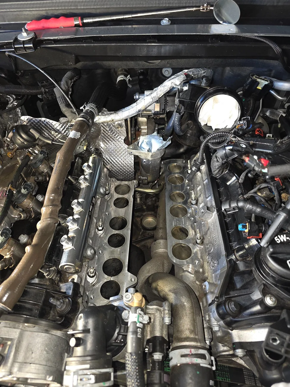

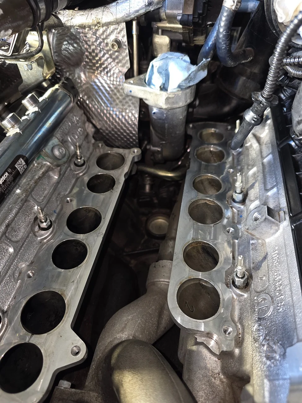

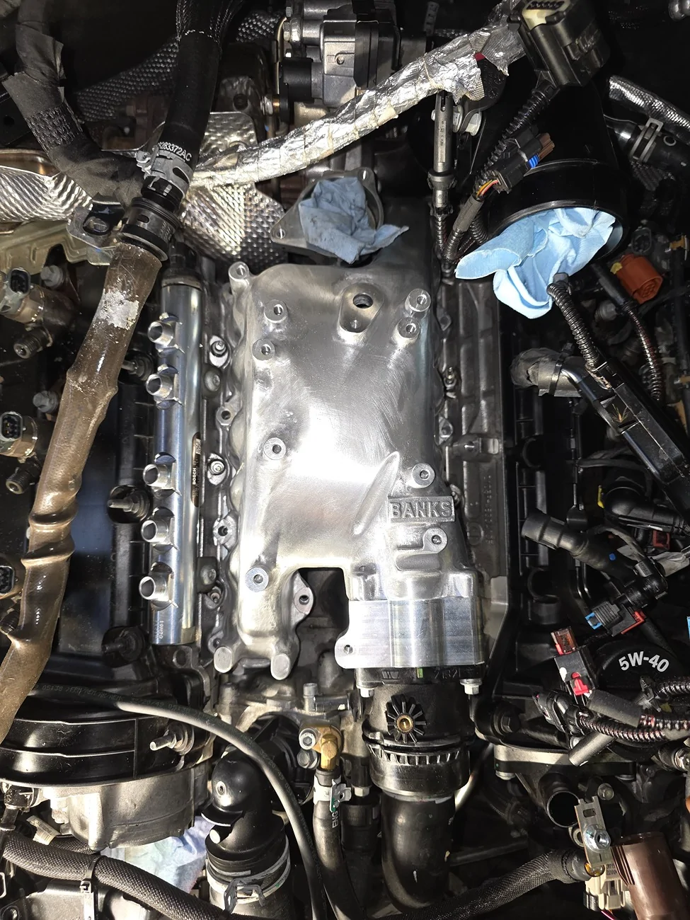

I’m interested in swapping my factory intake manifold for the banks without the swirl valves. Seeing conflicting comments online if this will fit the 3rd gen engine. I’ve spoken to a few shops and they say that is does in fact fit. Even on Banks website there are multiple comments asking if it fits with two conflicting answers. Posting to see if anyone has actually done it themselves if they could post some pictures. I want to remove both egr coolers and install the manifold all at the same time.
[/QUOTEBanks intake manifold works just fine on my 2021 3rd Gen. With a Diesel Dudes EGR delete and tune.
Jeep Gladiator Banks Intake Manifold Kit 41390 on 3rd gen Ecodiesel Gladiator. 20260118_175920
Jeep Gladiator Banks Intake Manifold Kit 41390 on 3rd gen Ecodiesel Gladiator. 51f9f79d-dafc-41a7-8ba5-ecec1d3f5b9a
Jeep Gladiator Banks Intake Manifold Kit 41390 on 3rd gen Ecodiesel Gladiator. 20260116_171352
Jeep Gladiator Banks Intake Manifold Kit 41390 on 3rd gen Ecodiesel Gladiator. 20260116_171302
Jeep Gladiator Banks Intake Manifold Kit 41390 on 3rd gen Ecodiesel Gladiator. 20260117_091502
Jeep Gladiator Banks Intake Manifold Kit 41390 on 3rd gen Ecodiesel Gladiator. 20260118_090244
Jeep Gladiator Banks Intake Manifold Kit 41390 on 3rd gen Ecodiesel Gladiator. 20260116_170945

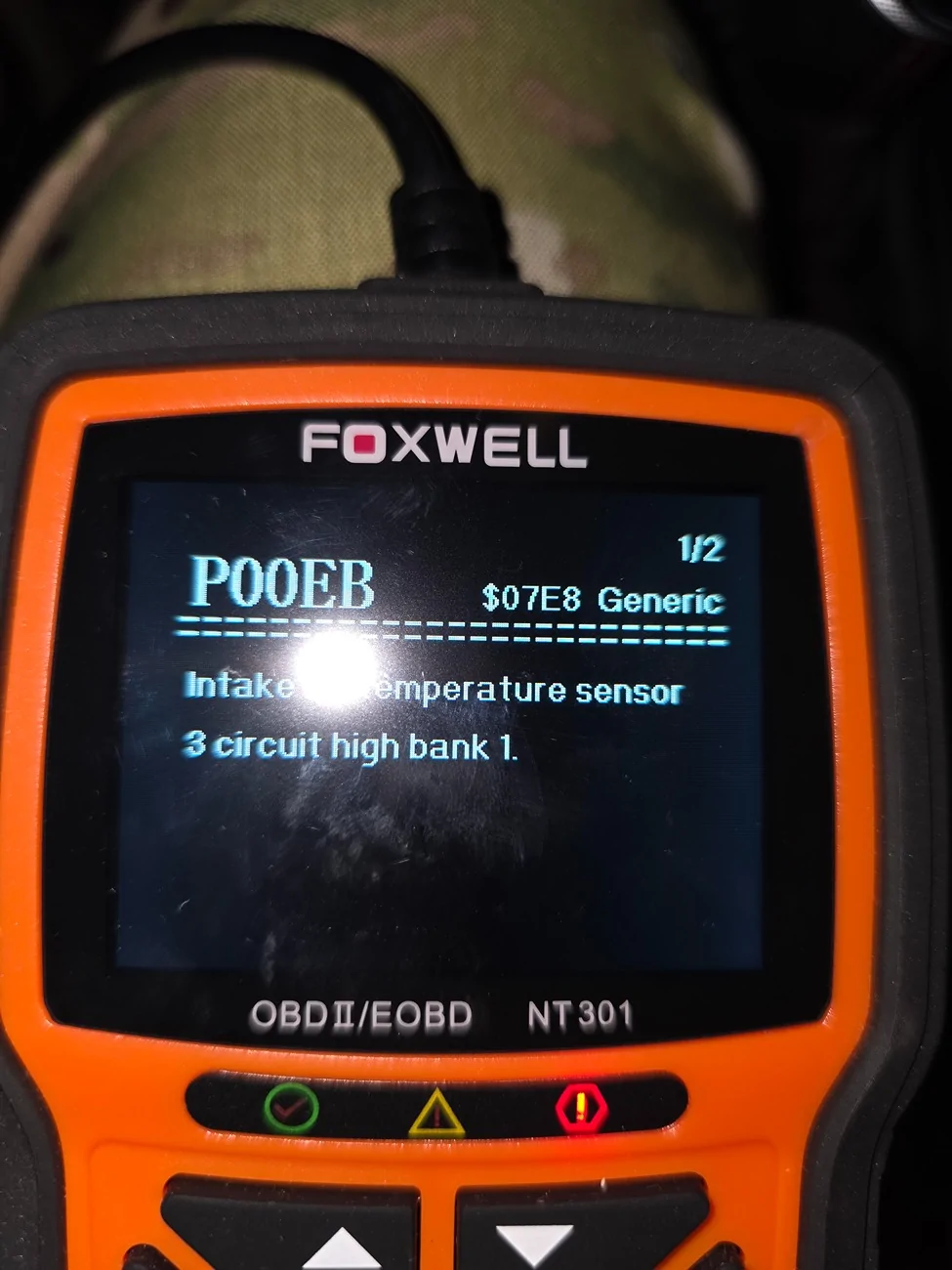

Fantastic job. I’ll look to do it in the future. Ever figure out why you had the code after you finished the install?
Not yet but The Diesel Dudes are working with me to get it resolved. I will be working on it next week as I'm traveling. I will post up the resolution once figured out.

What code is that? I have EOC stage 2 and want to know if the tune needs adjusting to run this.
nate10
Nate
Jan 13, 2026
44
96
Hawaii
2021 Wrangler Ecodiesel
Military
Not certain. I'm going to be working with The Diesel Dudes on a fix next week. It may just be something that's needs plugged in. There are sooo many sensors and plugs. Who knows what does what any more. I'll post it up once complete.

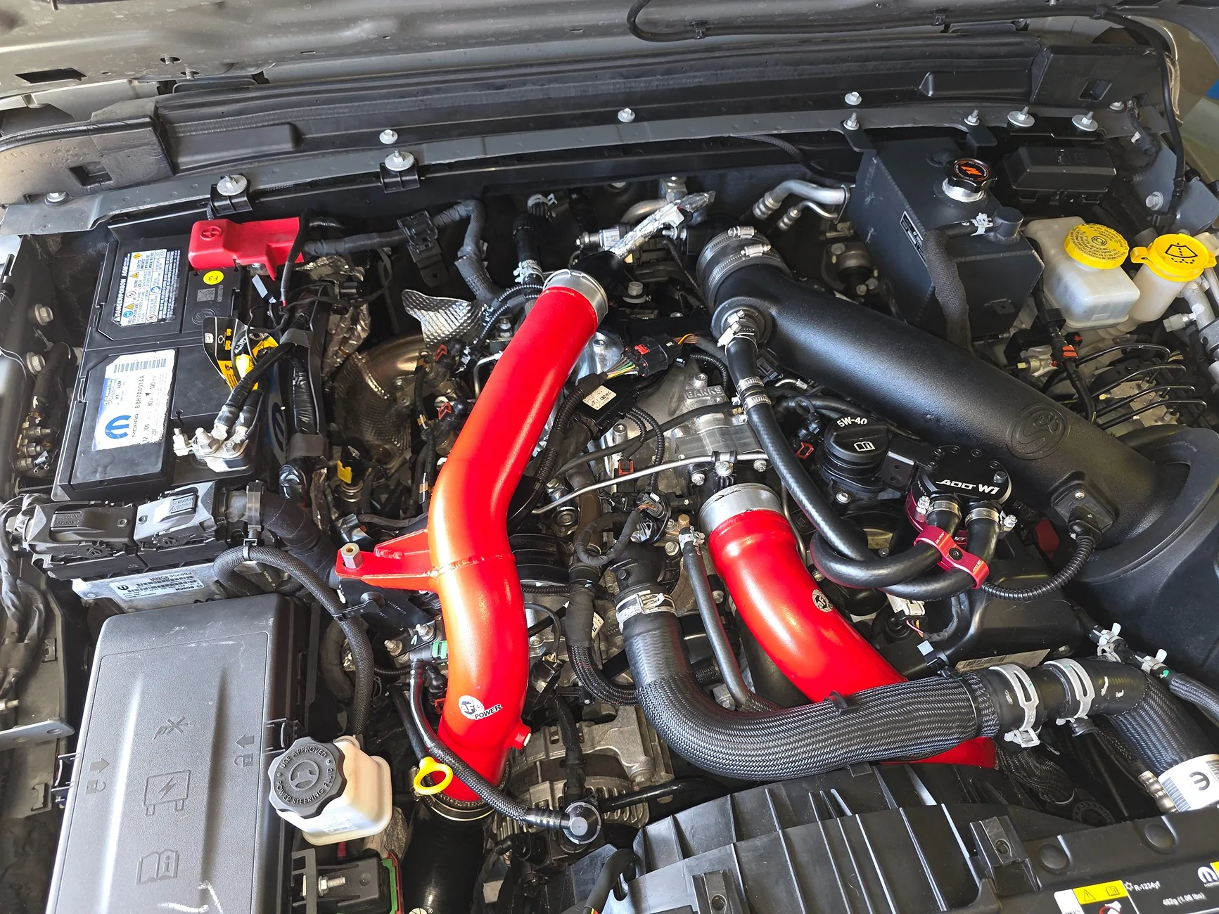

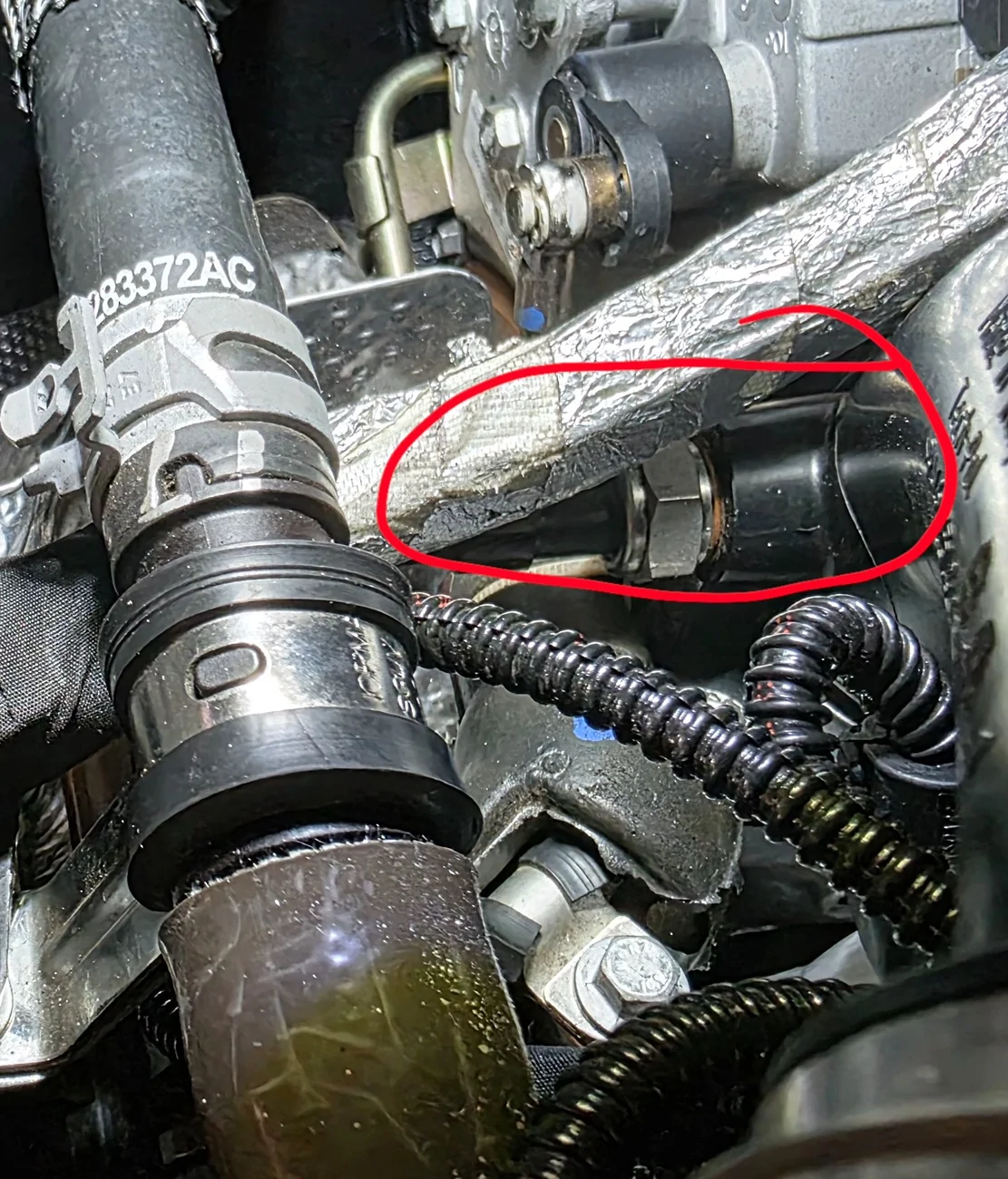

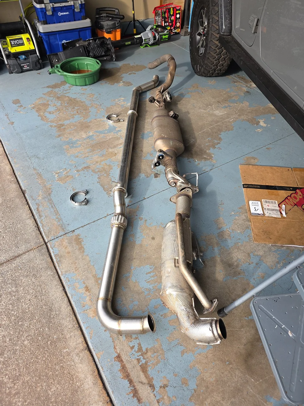

Okay everyone, it was my error on the install. One of the electrical plugs (to the turbo charge pipe just prior to the turbo) that is hidding behind one of the lines was not plugged in! Also, did a little tweaking on the exhaust and got everything lined up perfectly. It sounds amazing!

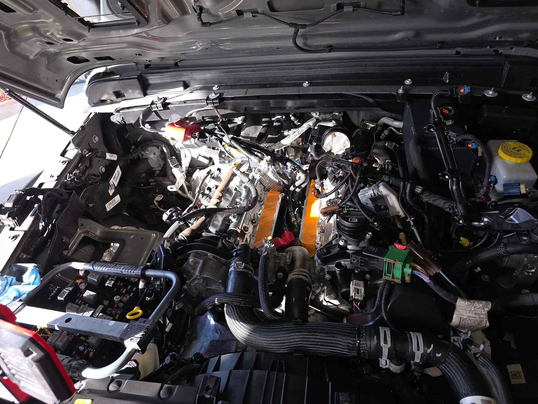

A buddy and I were talking about the Banks mani the other day. Was it a direct swap or did you need to bring over anything else from a gen2?
nate10
Nate
Jan 13, 2026
44
96
Hawaii
Military
@nate10

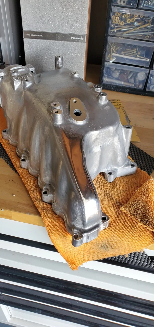

Direct. No issues at all. I took a risk buying it and trying it out. I was also polishing it out too but gave up because of how intricate it is and buried under every wire.
