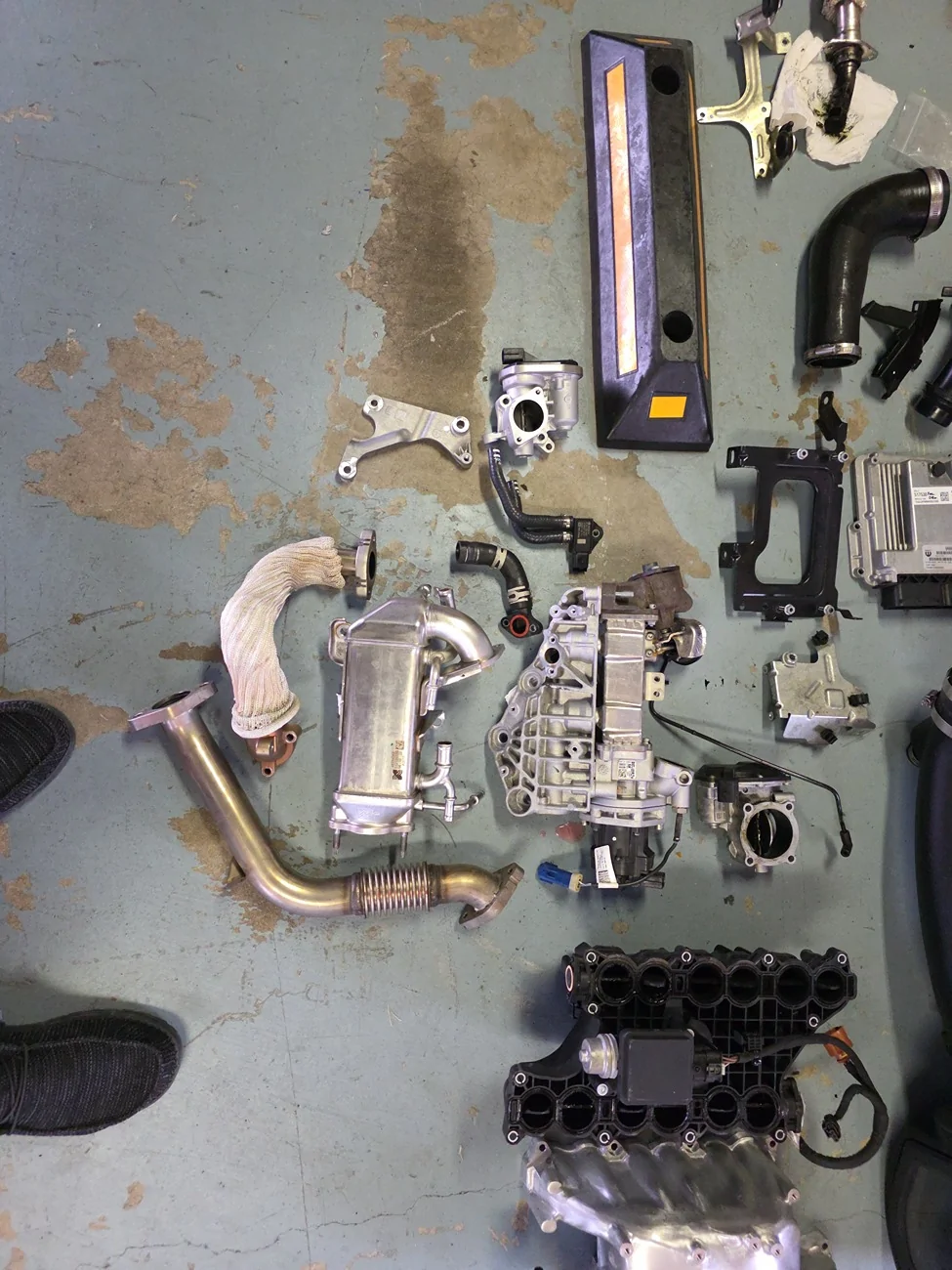

I used a 19mm 12 point socket and cut a notch in it with my grinder, also bought a 19 mm line wrench from Napa did the trick for me. I have been working on diesels for more than 20 years and reused the fuel lines on my 2021 Ecodiesel with no issues. They are hard stainless steel so as long as you don't go ham on them they should be fine. Also, don't bother with trying to torque them as there is just too much stuff in the way. Just get them nice a snug/tight. Check for leaks, drive it to operating temp and check again.
