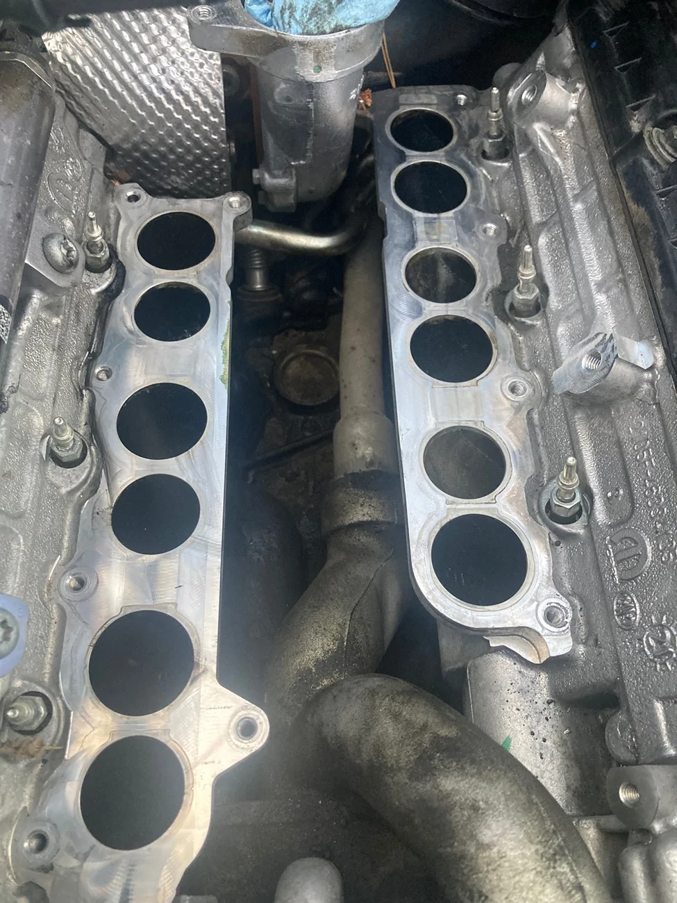

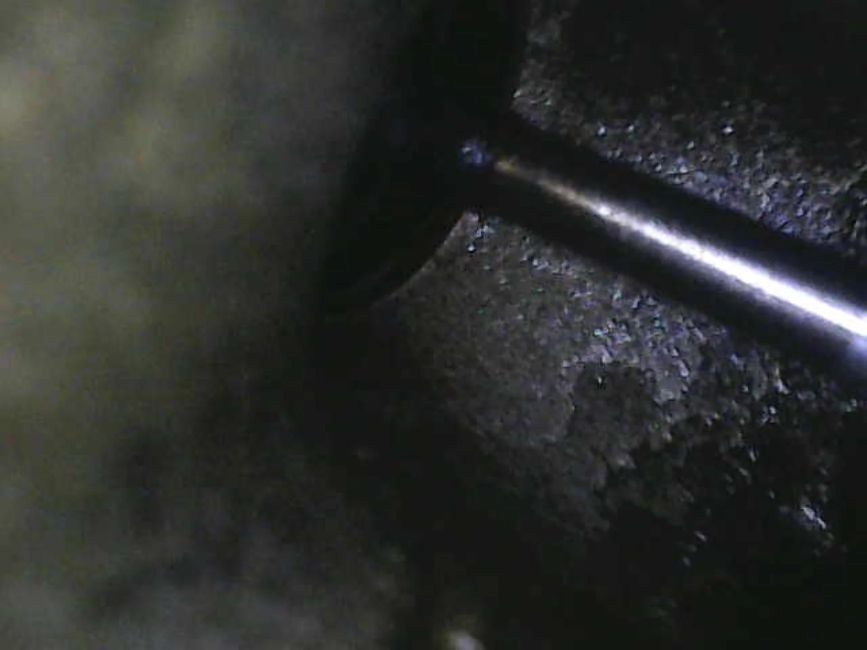

As I have mentioned in other threads, I have to replace the intake on my Jeep junk for P200 codes. I am currently in process of doing that job and will be posting pics as I complete the job. I wanted to reach out first to the masses to ask a question:

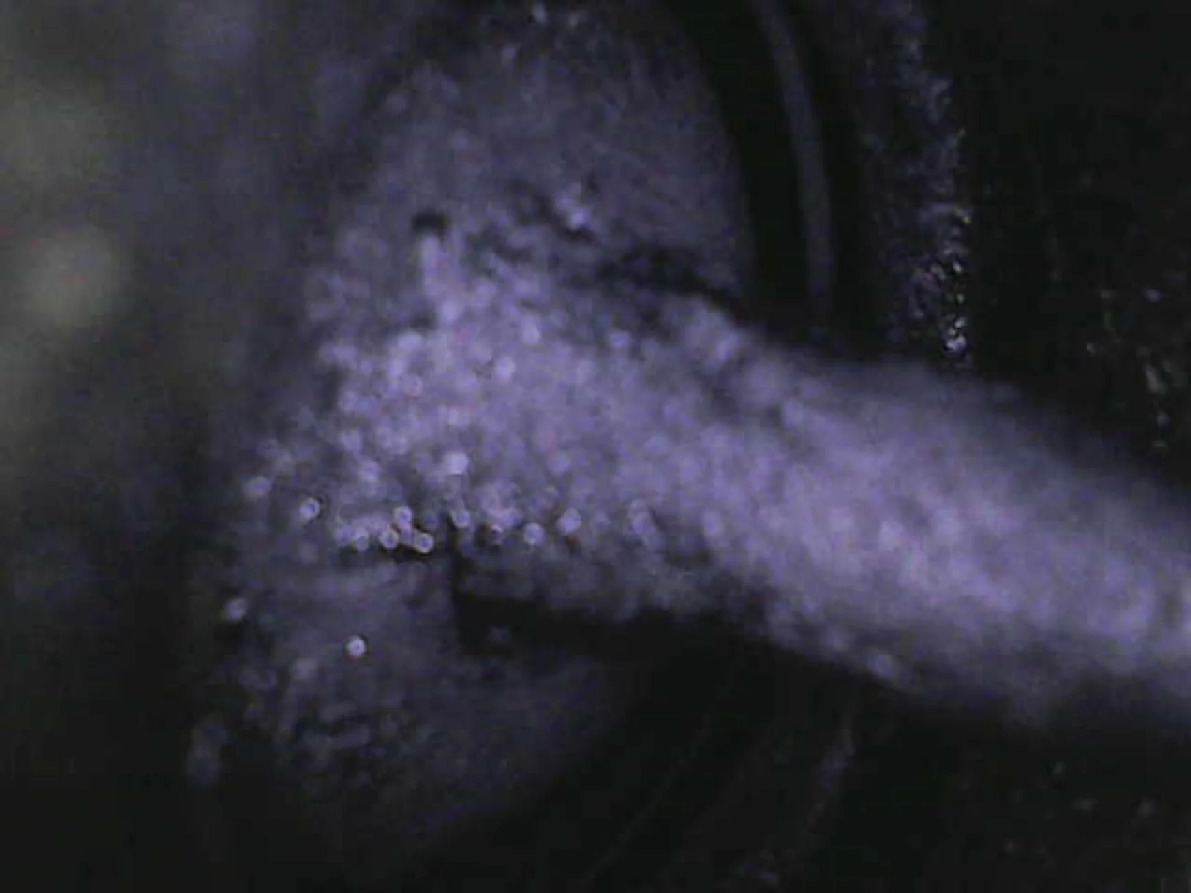

After getting the Intake removed and inspecting the ports, I have one that is incredibly clean compared the rest. ( front driver side port 2) has anyone who has done or seen the intake ports at this stage ever seen irregular buildup? I can't tie it to injector issue since the motor is direct injection like it was somehow wash down from a bad injector... Just curious if this has been seen before. Going to do the port blasting anyway on the rest to get them as clean as I can since this job SUCKS ASS to do. Pic below is the ports and it's obvious which is the clean one. also scope shot of back of valve.

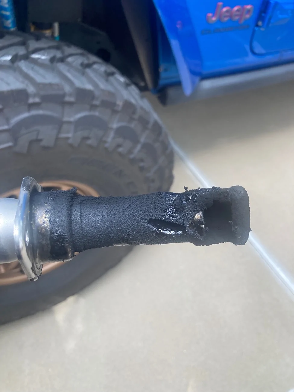

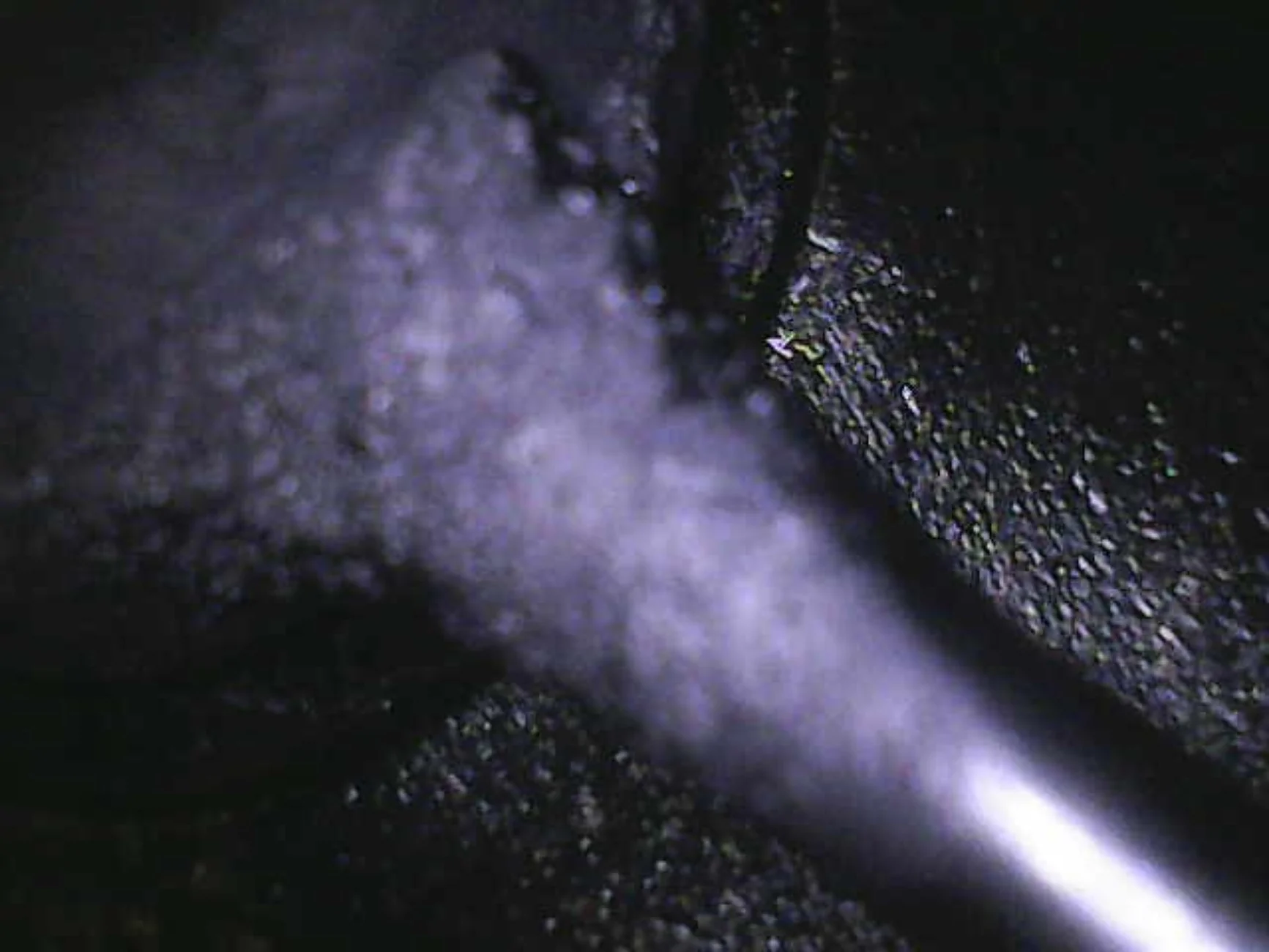

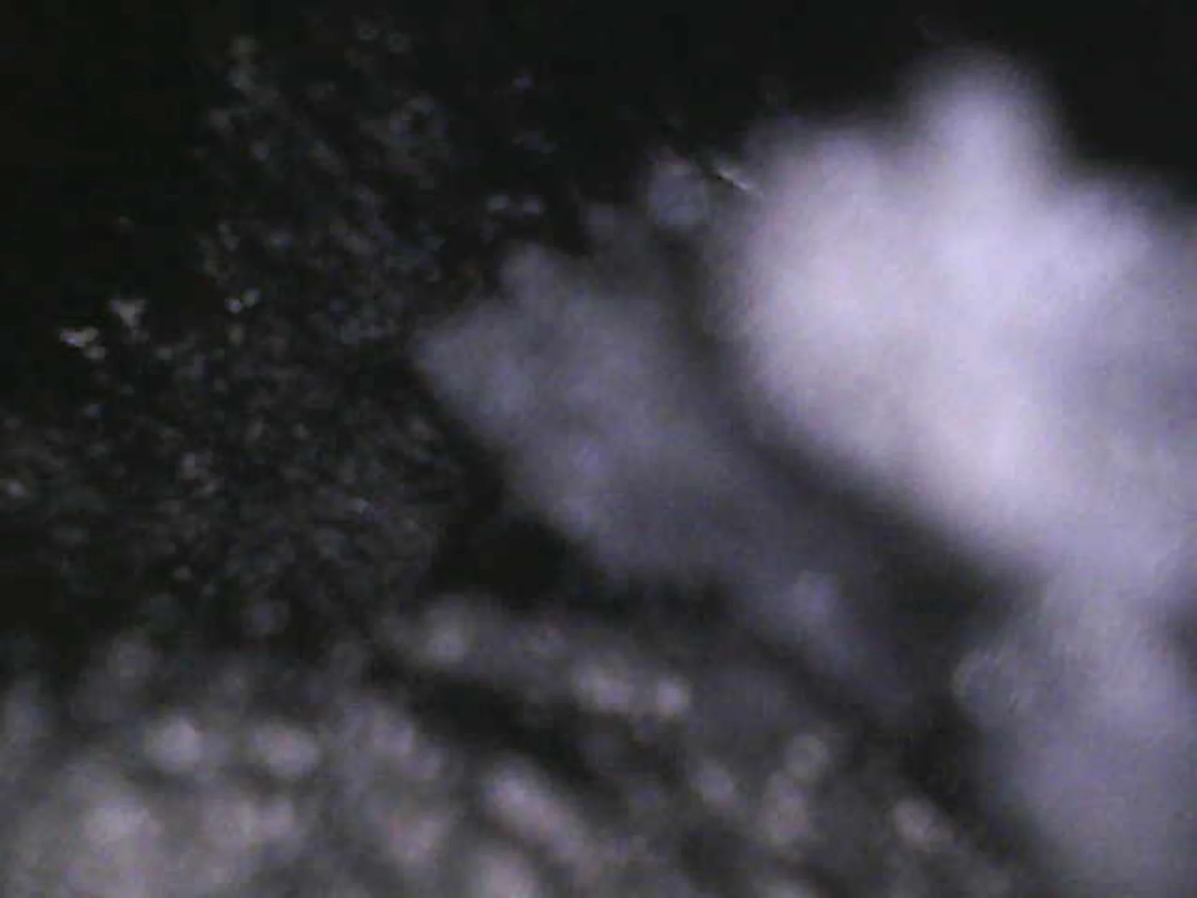

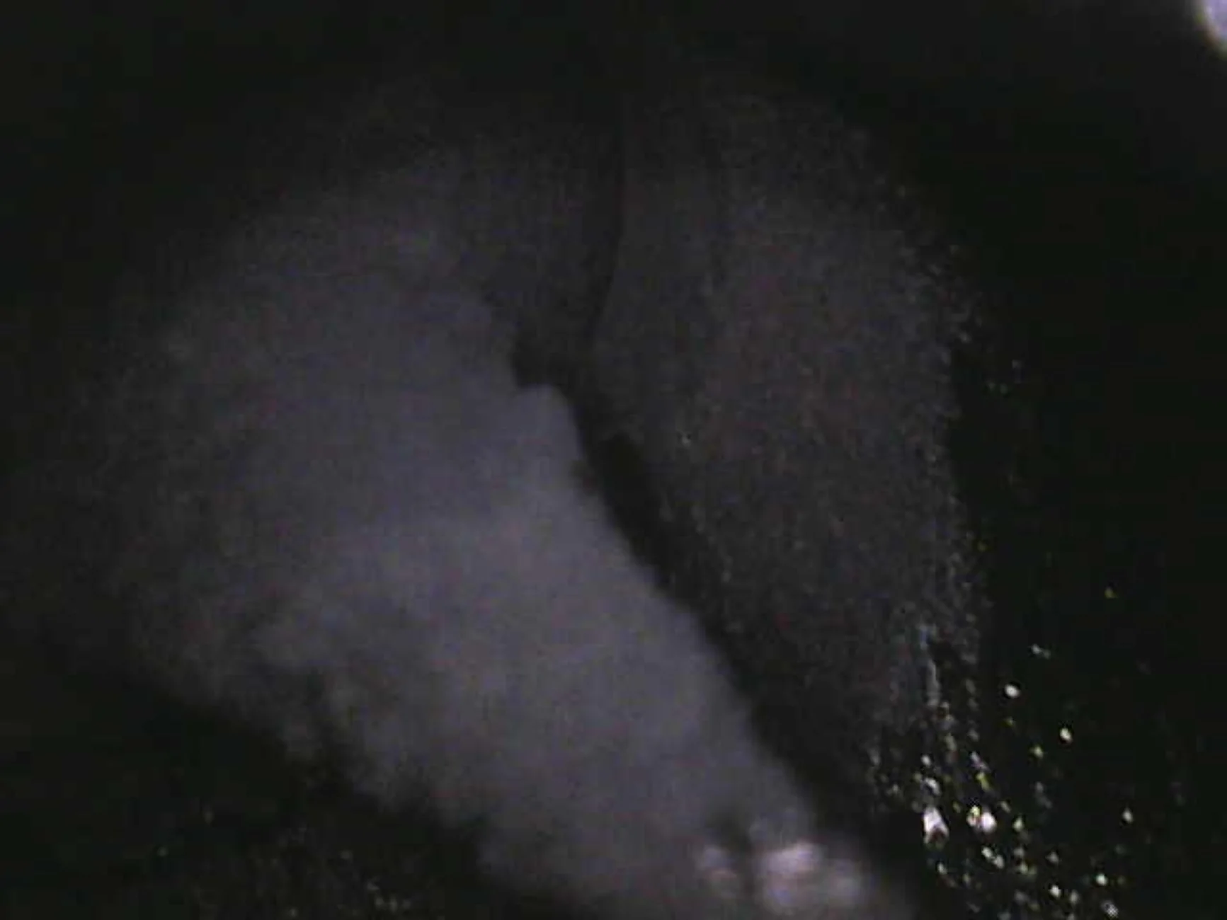

Yeah I drive in circles a lot... It has less build up than I thought it would for pulling p200 codes.

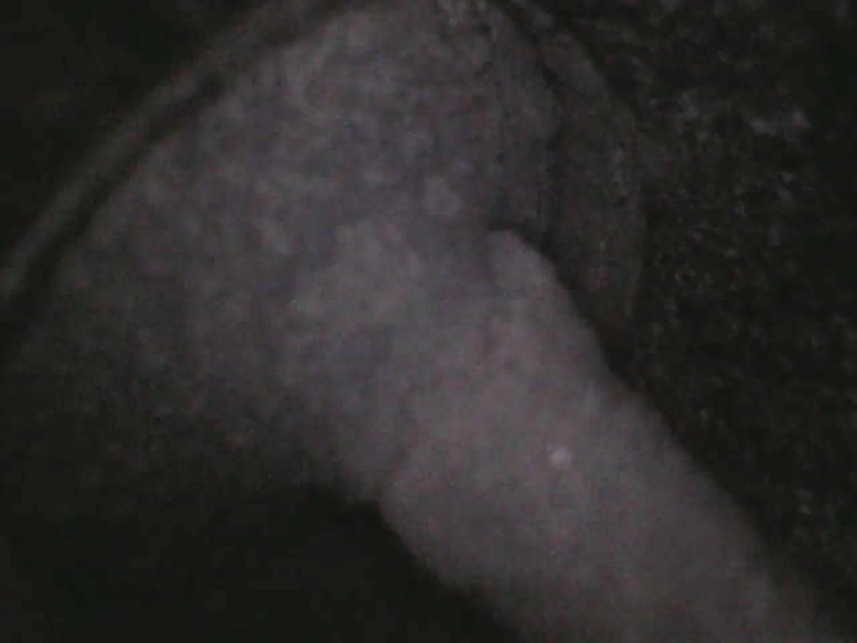

The other valves I have to blast:
Jeep Gladiator GEN 3 ECO INTAKE REPLACEMENT AT HOME DIY Image_2025-08-03 08_35_33_926
Jeep Gladiator GEN 3 ECO INTAKE REPLACEMENT AT HOME DIY Image_2025-08-03 08_35_46_872
Jeep Gladiator GEN 3 ECO INTAKE REPLACEMENT AT HOME DIY Image_2025-08-03 08_35_40_917
Jeep Gladiator GEN 3 ECO INTAKE REPLACEMENT AT HOME DIY Image_2025-08-03 08_38_46_103
Jeep Gladiator GEN 3 ECO INTAKE REPLACEMENT AT HOME DIY Image_2025-08-03 08_36_12_657
11,385
30,366
The clean port could be from the way the EGR rube is pointed inside the manifold. It's pointed away from that port.

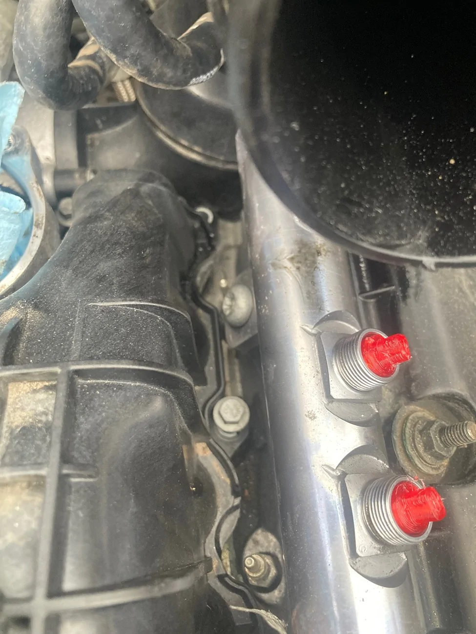

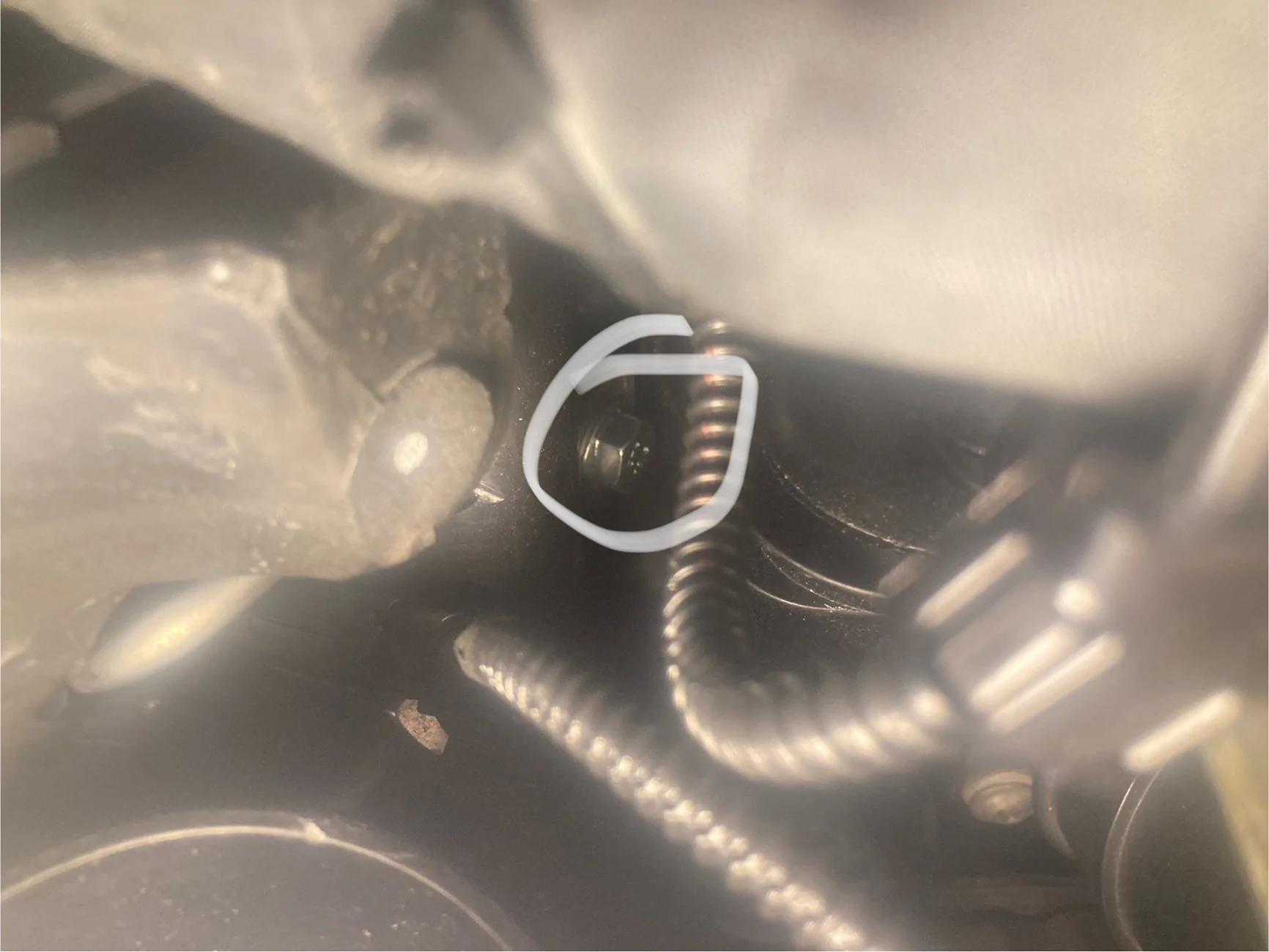

that make it harder than necessary. The big Dumb Dumb is the bolts that hold the rails on. They are Torx head t40 with only about 1/2" clearance to the intake. Intake has to be loose to get them out and special tools to get to that bolt as well. Pro tip- Go to ACE and get hex head metric shoulder bolts,(pic) allows easy access with an end wrench without having to loosen up the intake first.

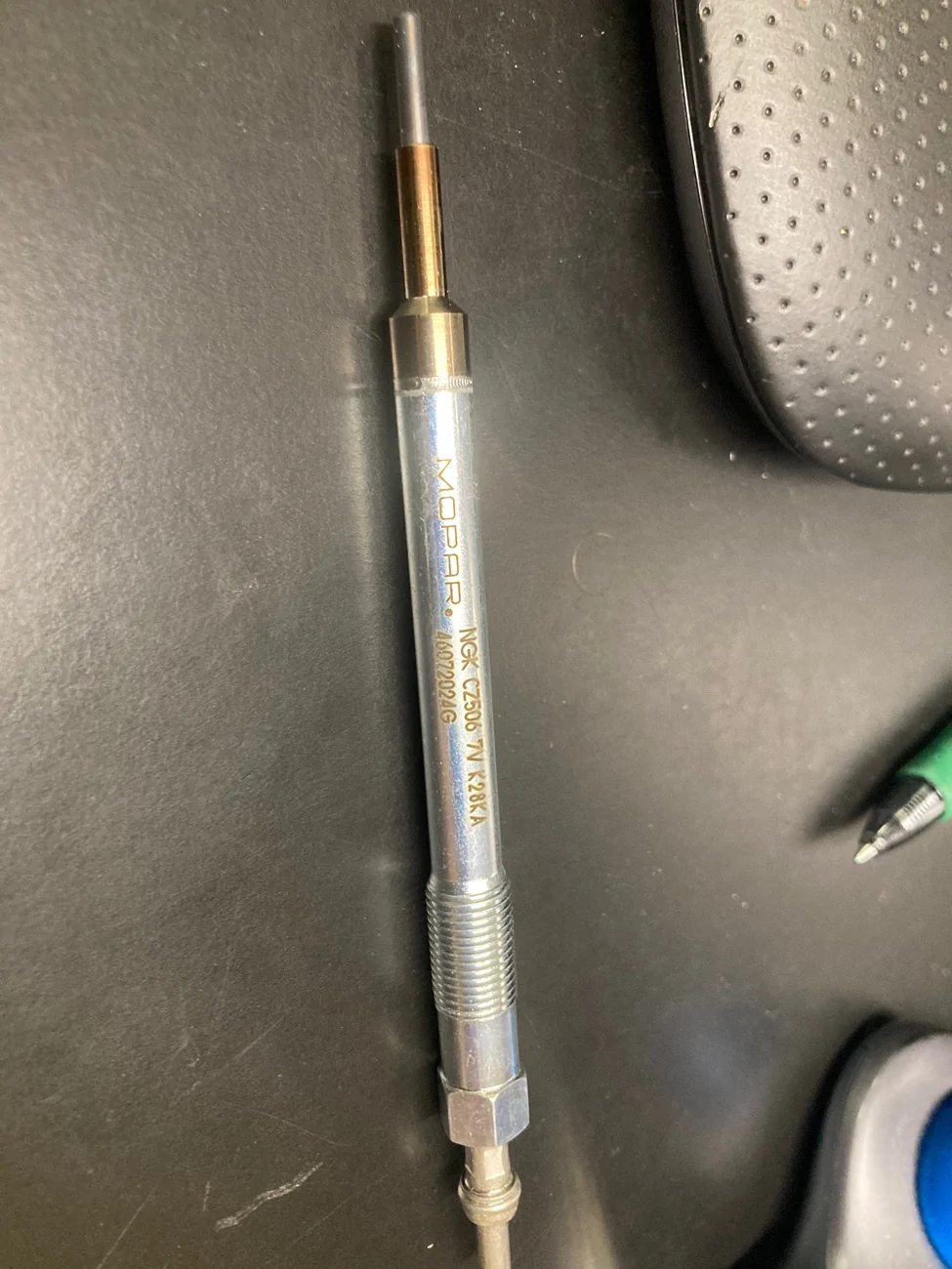

Jeep Gladiator GEN 3 ECO INTAKE REPLACEMENT AT HOME DIY GLOW PLUG
Adding insult to injury, this week glow plug 4 decided it does not want to play anymore. Lucky me get to try and dig that one out. At least it's the front driver and 2nd most accessible plug of the six.
