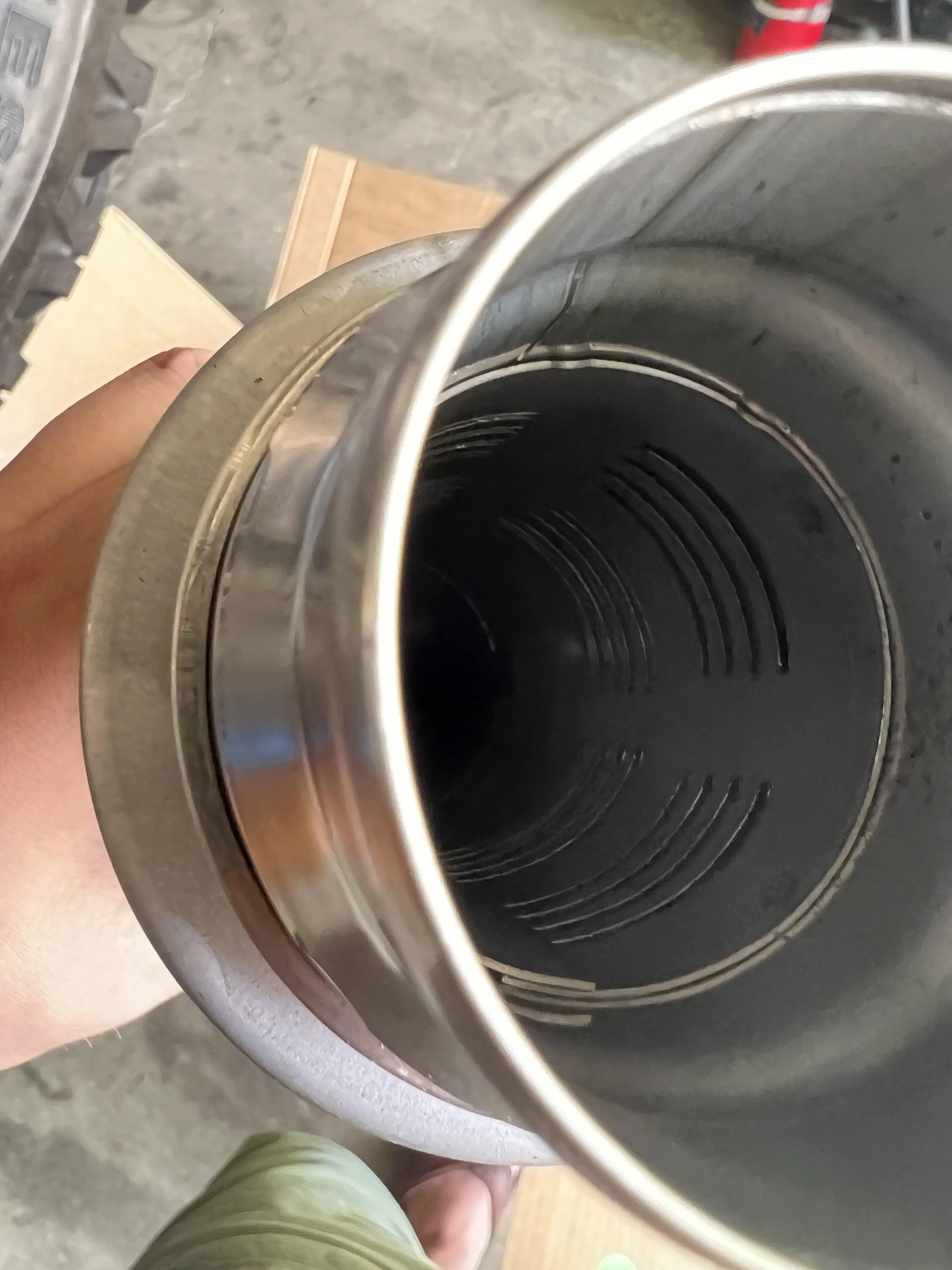

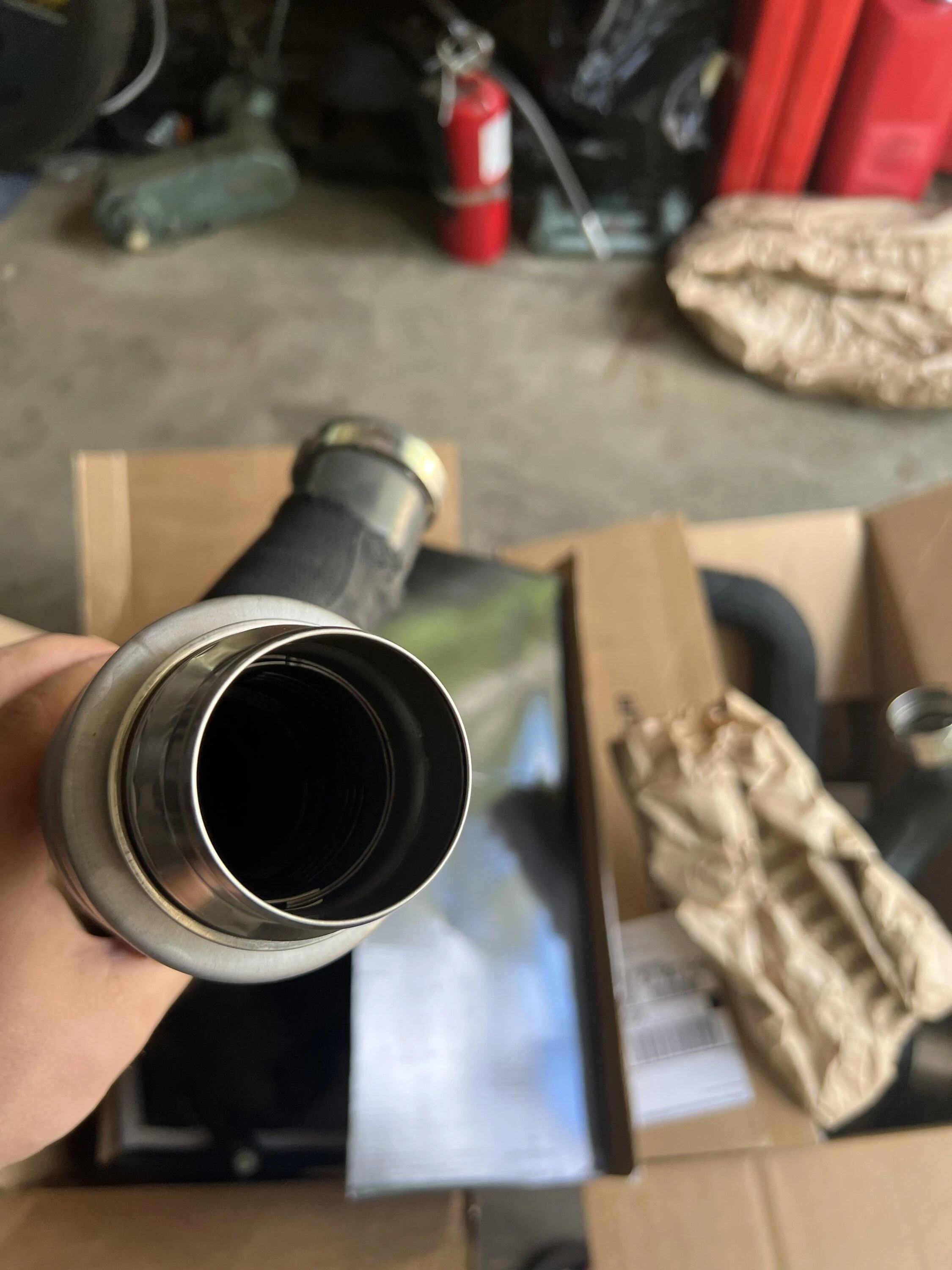

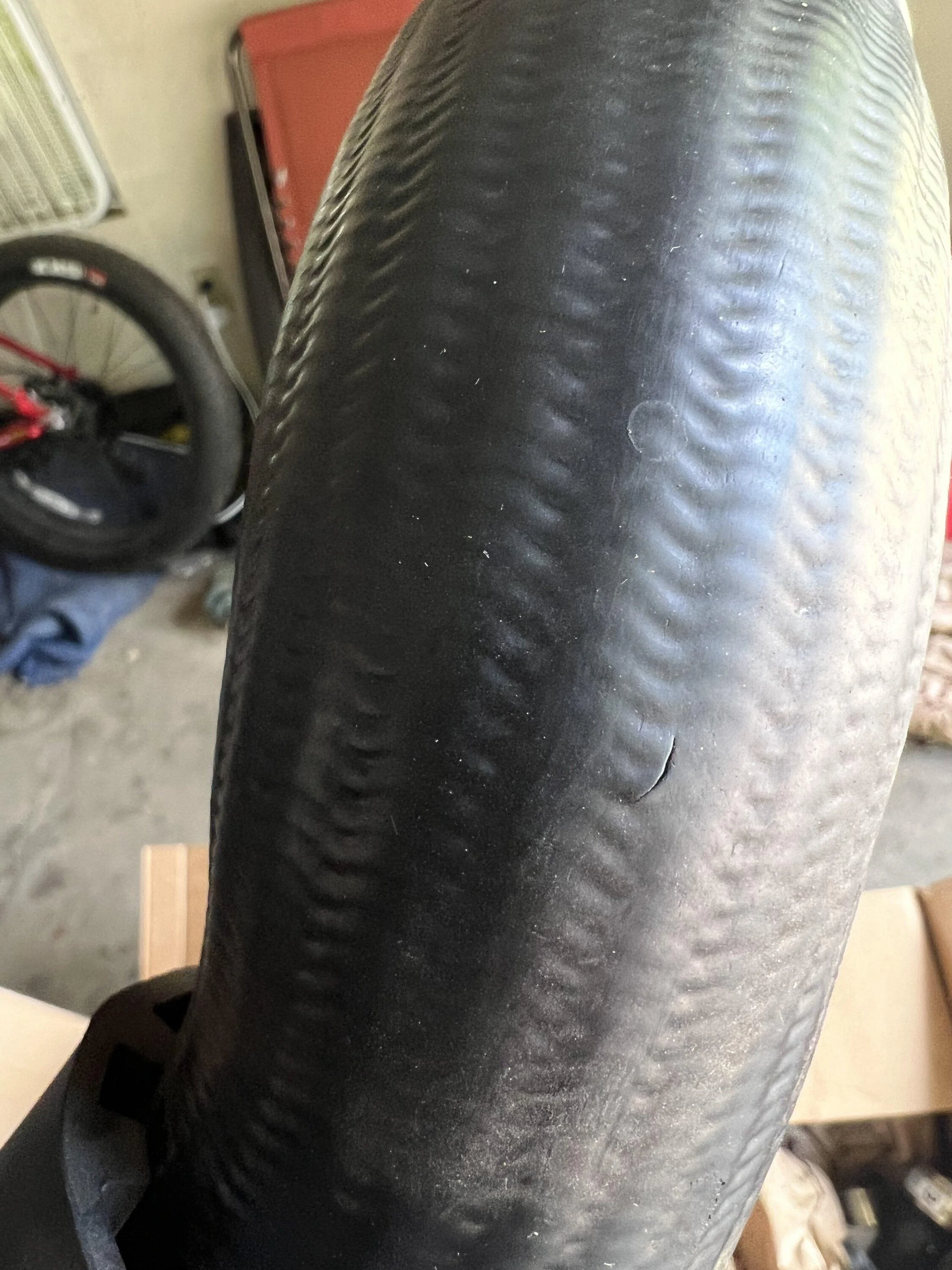

Well…removing the silencer does nothing except….at engine lugging rpm when boost is coming on there’s a low frequency vibration that is harmonics from the turbo to intake manifold. No added whistle…or power with the removal.
My factory intake elbow already had a nick in the large rubber hose since new.
I feel better knowing there’s multi ply silicone elbows at the intercooler with legitimate clamps now.

Which silencer is that in your first picture? In my original post I showed the plastic one in the plumbing right after the air moves through the filter. Your looks to be metal?
That is the turbo outlet to intercooler silencer. It is metal in the plastic pipe.
I have removed the one in the intake/turbo inlet also. Still barely any turbo noises.
