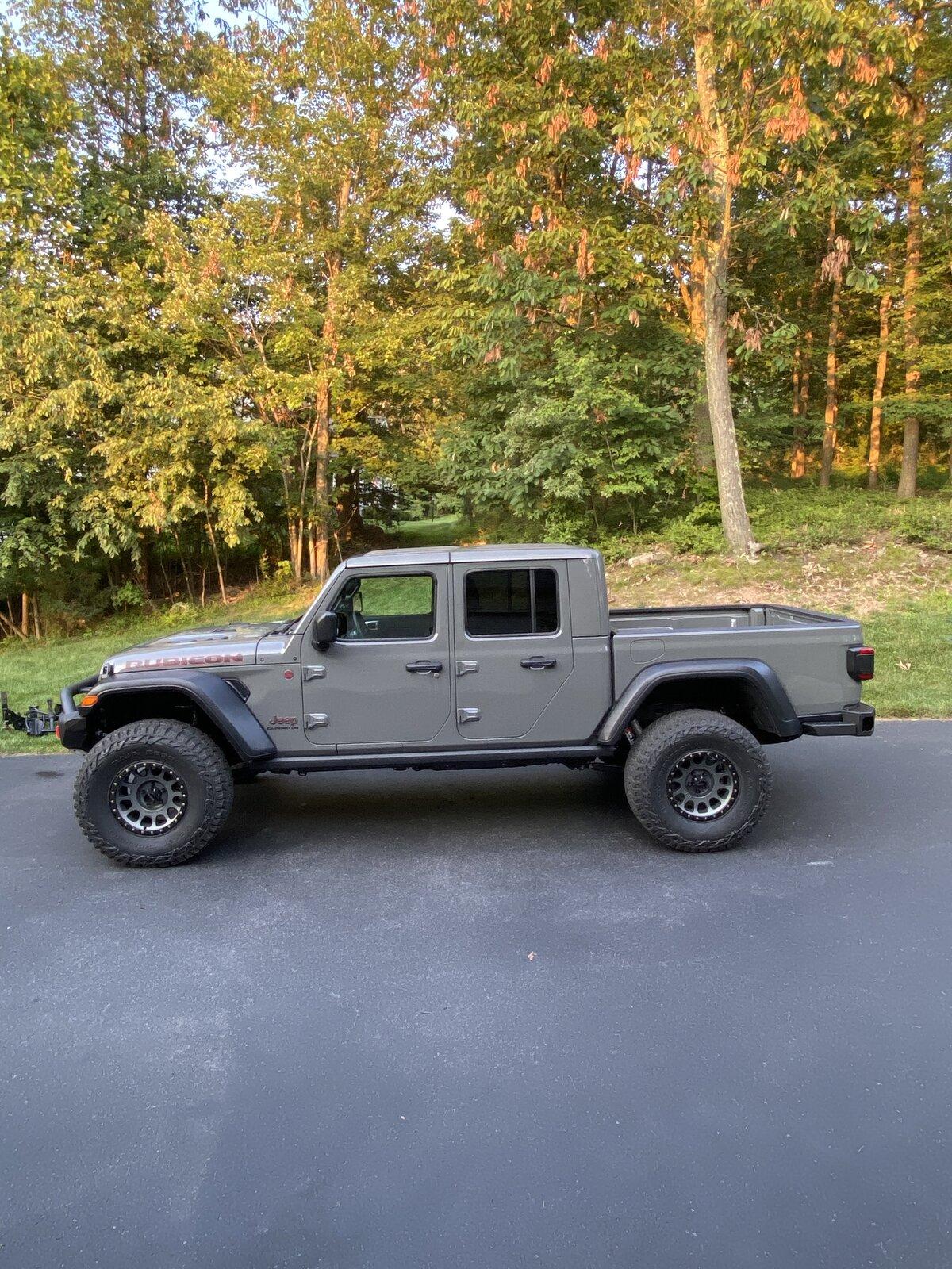

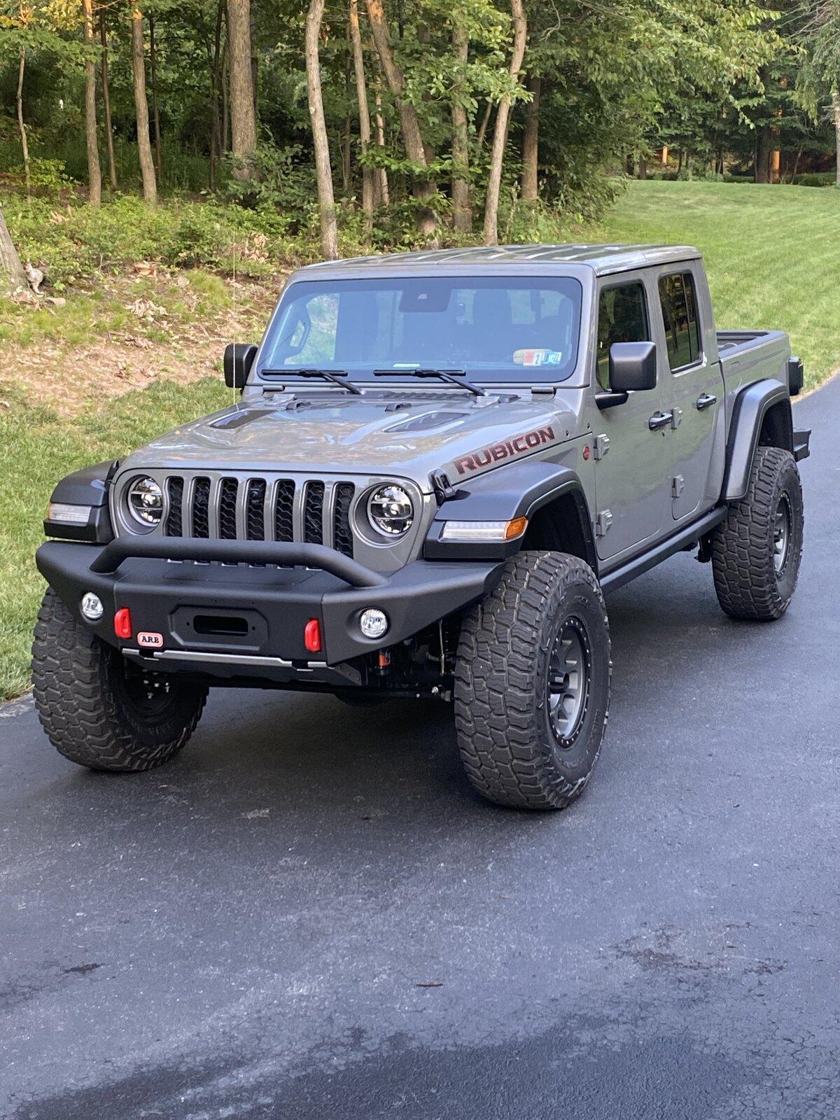

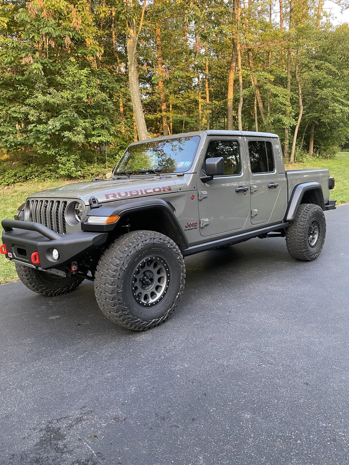

Yeah you nailed it. Is it a diesel specific lift?
What was the turnaround time? I’ll be going up there (hopefully in a month or so) to pick up a gladiator and it might be worth a quick stop if they’re not in Western Pa.
Sorry, I didn’t respond to the question regarding if this it Diesel specific.
No, the Clayton kit is not diesel specific. However, two things:
Since the diesel motor is 300-400 lbs heavier, we used a 3/4” spacer to get the stance correct. Also, if you want to use Falcons shocks, you must get diesel-specific shocks since the regular shocks extend too far into the engine bay and hit the battery and battery tray. Those shocks were completely out-of-stock everywhere. So, I upgraded to the Fox and couldn’t be happier.

I’m running the M/T Baja Boss’ at 33PSI. We did a beach trip weekend before last and averaged 84mph and 19 MPG. With the windows up and AC on, the tires are not loud at all. I’m only running a 1/2” front 3/4” rear level.

I’ve only driven about 1k miles on these tires - only summer with rain. As such, I can’t give a well rounded review yet. And no, I’ve never had the Nittos. I can report that they work quite well in the rain and are quiet. Mind you, I have the AT’s, not the MT’s. I’d say they are comparable to the GY Duratrac’s in many ways.
