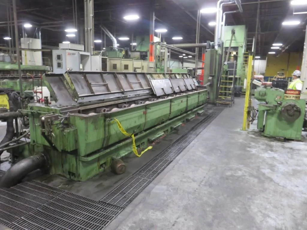

For reference this is the sort of stuff I used to rebuild. I was a lv 1 master tech. Did everything from plc work to total machine rebuilds.

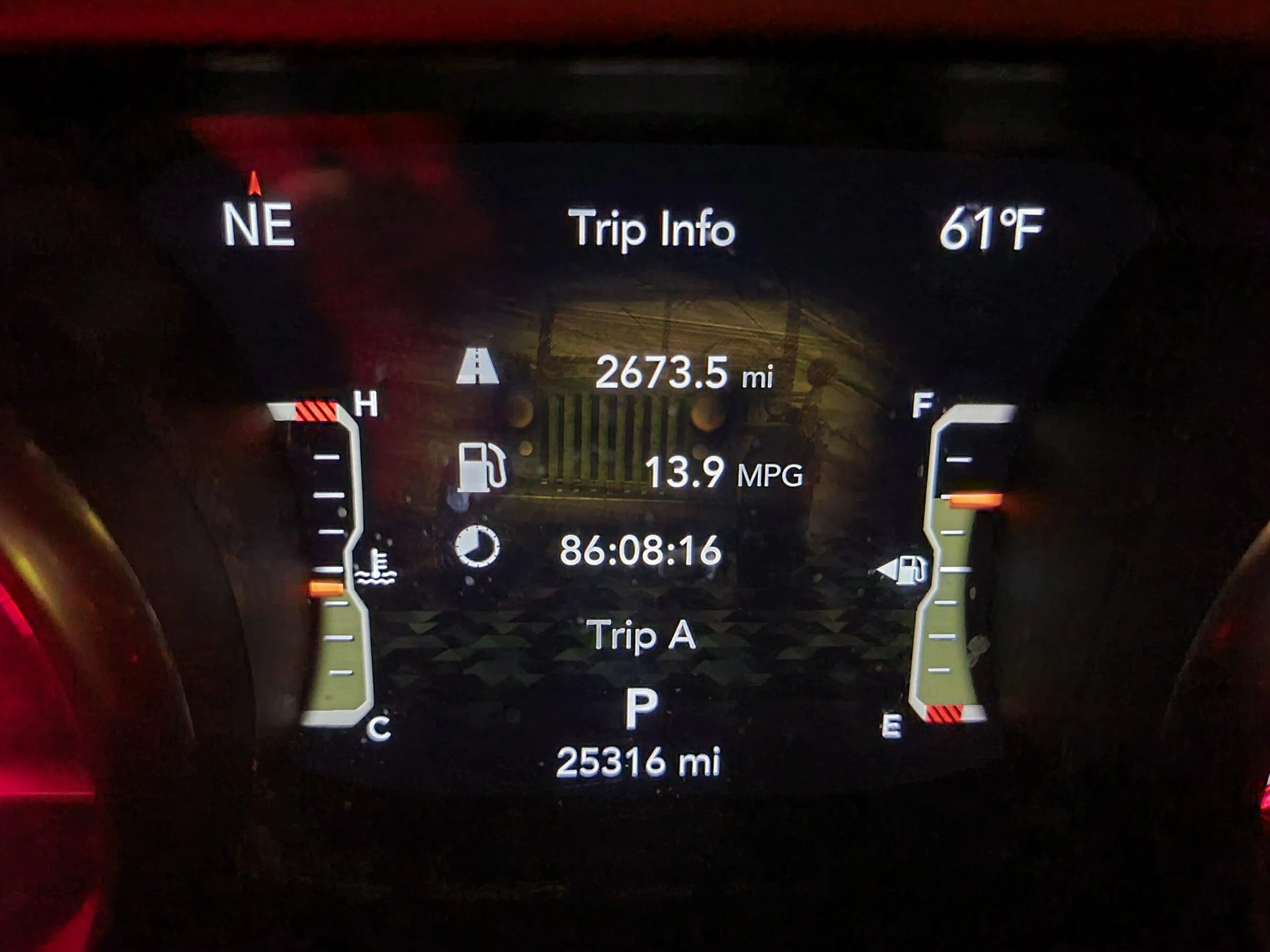

I've decided to go with 4.56 gearing with my 35s. MPG will suffer a but but at this point my diesels only averaging 13.9 so it's not a big deal
In my humble opinion you would be wasting money to regear to 4.56:1 final drive. There is something else wrong with your engine as you are the only member that has shown such terrible fuel mileage. Spend that money on a rental and give your dealer the opportunity to diagnose what is going wrong.
The only reason you should have a sustained fuel mileage like that would be with always towing something and heavy payload.

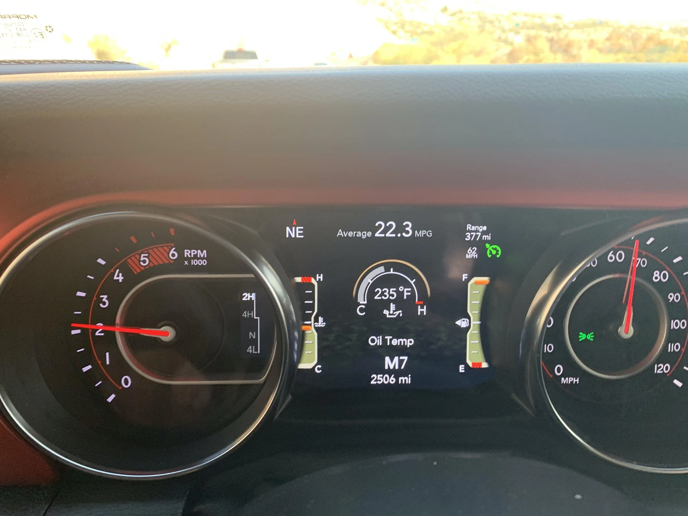

egts may be a culprit but high oil temps are definitely happening. I’ve not had a derate myself but have seen oil as high as 250+ I’ve decided that regardless of derate or Lack of derate I will be adding the bypass filter and I will also be adding a cooler. Likely one with a thermocouple and fan. I’m eyeballing this one
